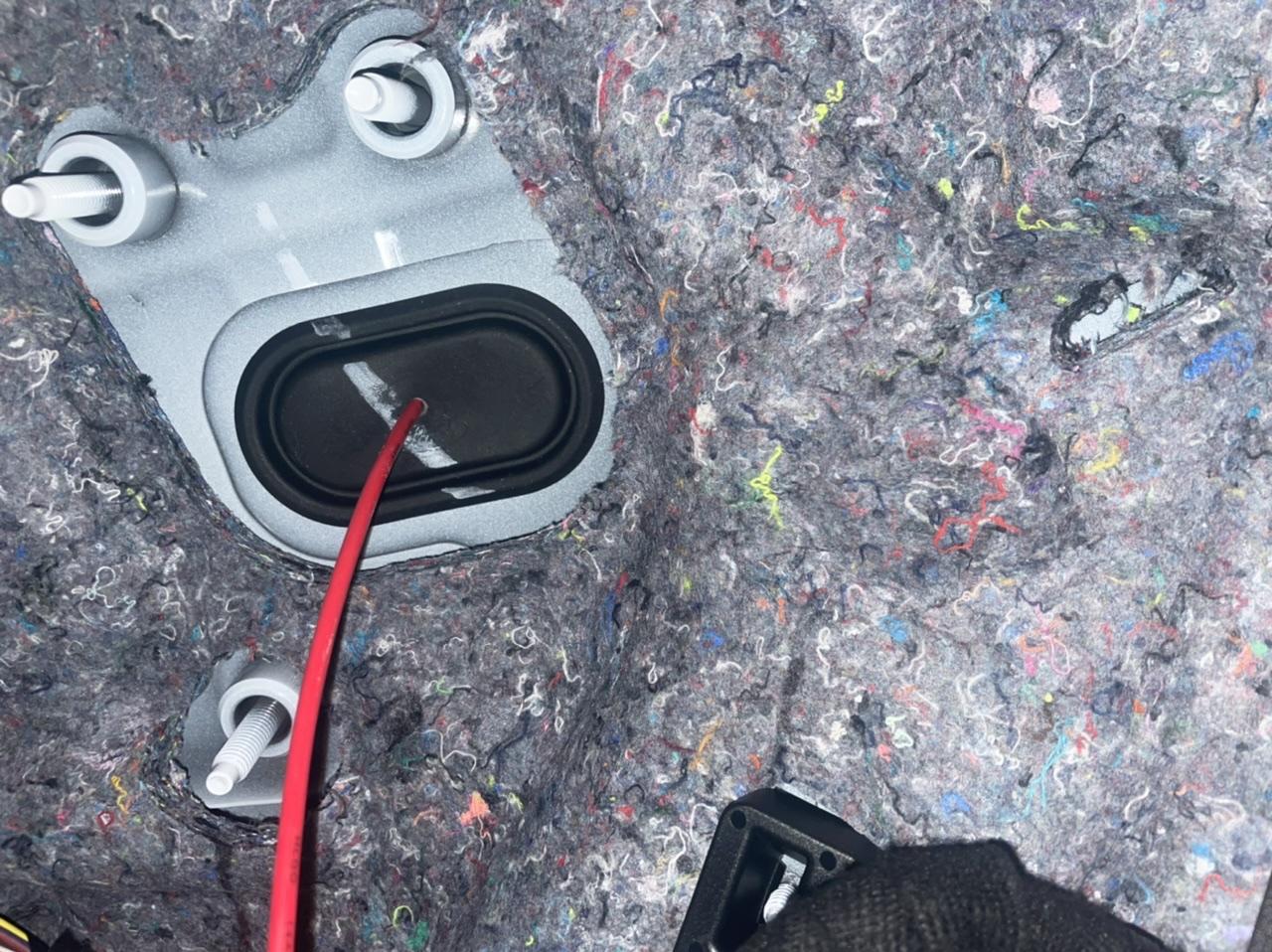

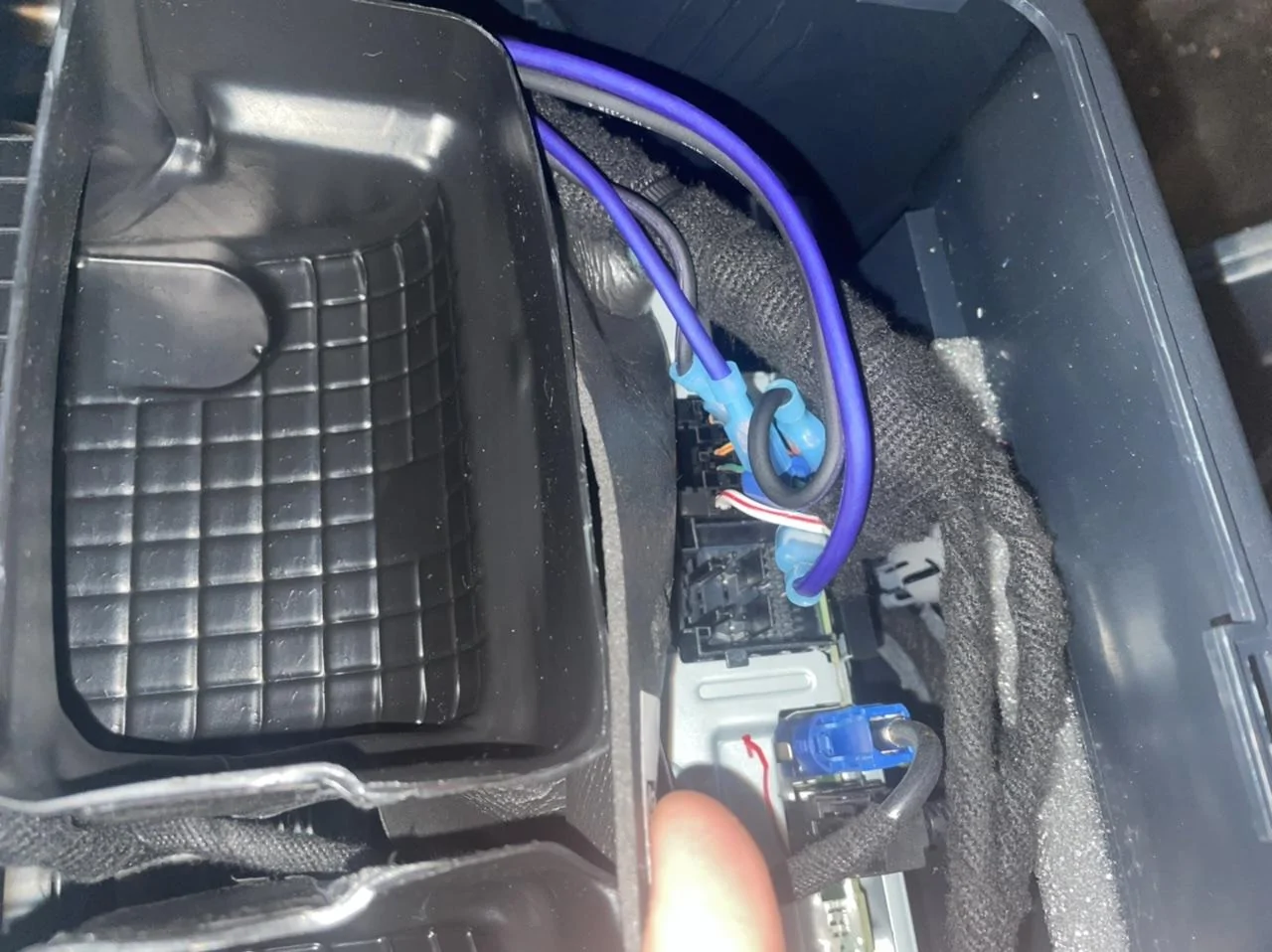

For the SUB install, where are you tapping for the power and audio feeds?
Power I ran through the firewall to the battery…. There’s easy access to a rubber grommet that you can just drill a hole sight it smaller than your lead wire and shove it through. For the audio feeds I tapped behind the climate controls (backside of the wiring harness coming out of the head unit)
I’ll link a few other threads that dive deeper into that with pictures (I leverages those figuring out where I wanted to run/tap)

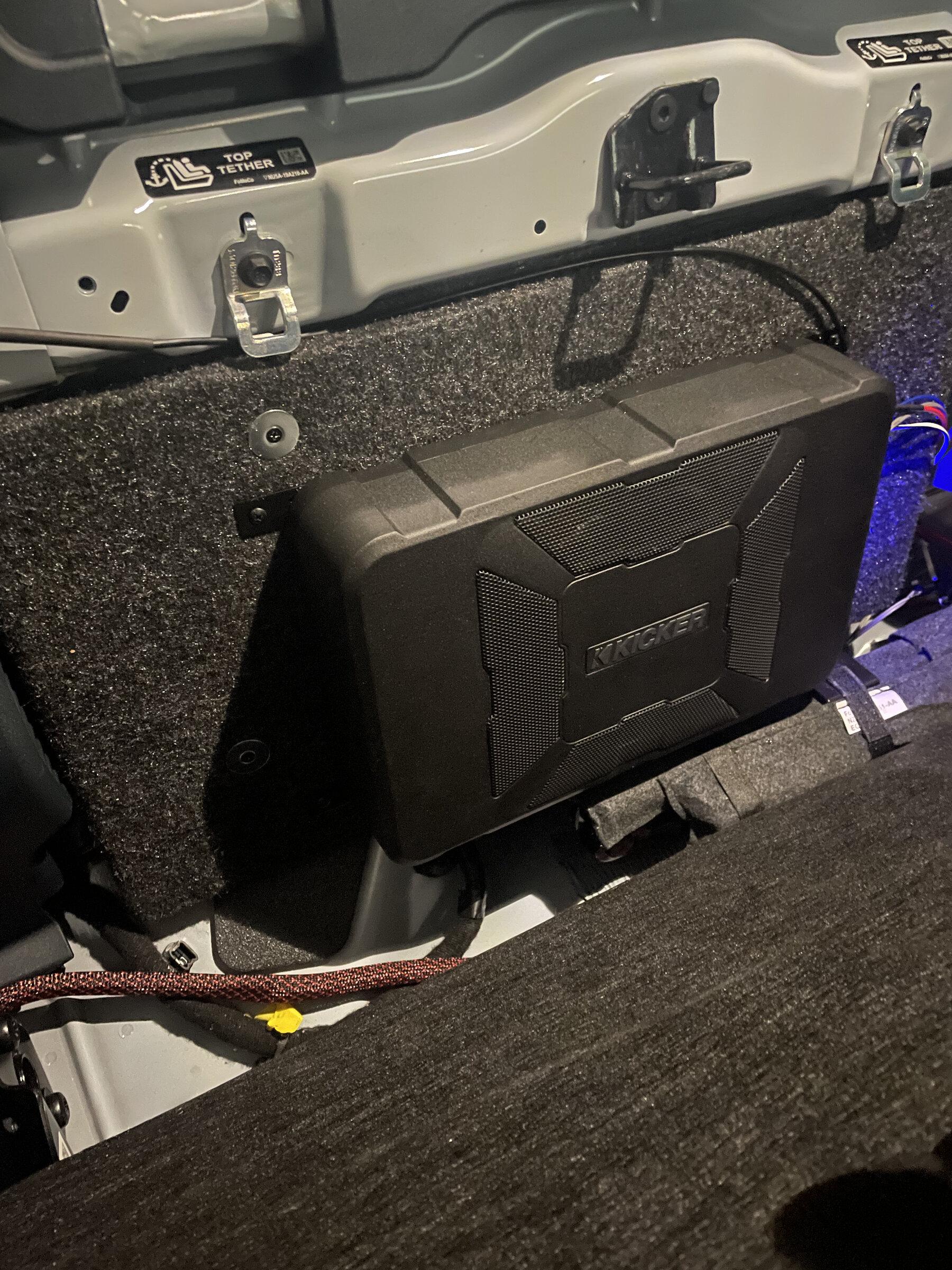

UPDATE: installed the door speakers Friday, did the drivers door first and then wasn’t careful enough on the passenger side and broke some wiring harness clips - be careful!!
The foam on the powerbass 6.5 speaker is too thick and you won’t be able to clip the door panel all the way back in without editing it. I took the foam DD, shaved it and re-glued it to the speaker housing. With this it makes it not quite so plug and play and if I had to do it over again I’d likely go with a slightly higher quality component set with actual crossovers. The sound is def an upgrade over stock.

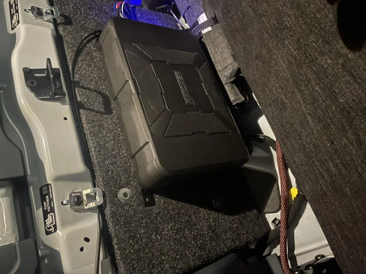

Ran the wiring foe the hideaway and did the initial hookup and testing. All is good there, now just need to finalize the location and finish the custom mounting board/bracket. Part of me wants to get a second hideaway and mount them both behind the seat , but I’m going to play with this one for a week or so (and will likely just keep it at 1). I won’t make any decisions on that til I have the rear speakers mounted (and reminder, the stock speakers back there are 4”, but it’s an unconventional mount in the C pillar and you can retrofit the 4x6s which is what I’m doing - still waiting for the 4x6s to arrive)

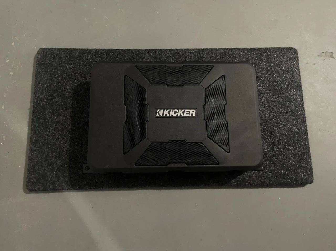

Still waiting on the 4x6s, may not be here til the end of the month (but I ordered from Australia, didn’t expect them quickly) -(also starting to question the fit of these particular 4x6s…. I’m confident in being able to custom mount 4x6s in there, but these magnets are a little bigger than I accounted for (though the hole in actual frame seems bigger than typical for 4” so we’ll see if I can make them work - may order some 4” as well as a backup)

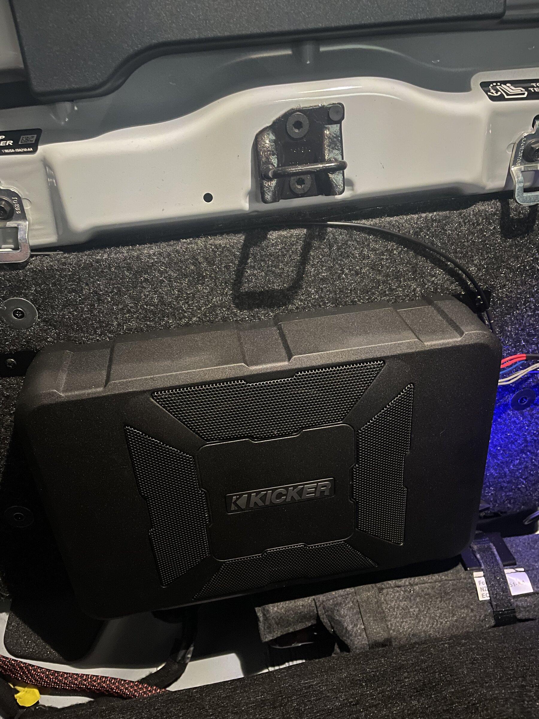

Finished up my mounting board and configure/fit…. I still have some final touches to do on wiring but here’s what it’ll look like and some pics of the board. Wrapped a piece of mdf in sound deadening mat and then wrapped it in sub box carpet…. Put a lot of deadening behind and worked some mounting boards into the factory bracket (pushed in those clips that stick out on that bracket to make it as flat across as possible)
Very nice looking install of the kicker.

Thank you. Could you explain to me why you tapped into the wires so close to where the harness attaches to the radio and which speaker outputs you tapped? Without having a Mav of my own yet, in my mind, I'm thinking it would be easier to tap into the passenger rear speaker or something coming out of the amp behind the rear bench?

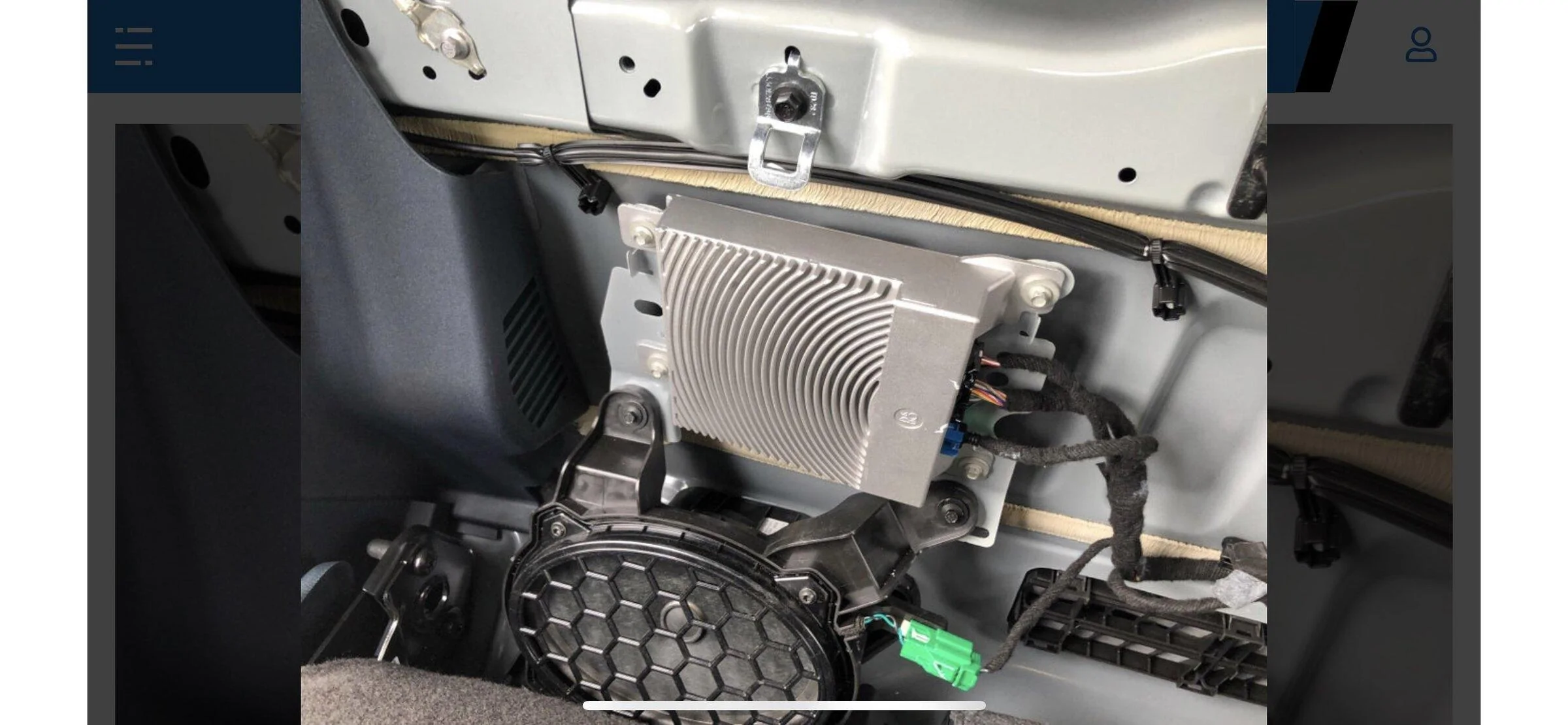

Only the Lariat w/ Luxury Package has the rear amplifier as part of the B&O audio system. If you want to tap off the front audio channels then doing it at the radio is the most convenient point.

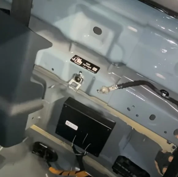

What is this "black box" behind the driver side rear bench area then? Hard for me to see what cables are coming in/out, but I just assumed it was something to do with the audio system.
Also, doesn't the B&O system already have a compact sub installed somewhere?
On the rear speakers, they appear to be on a common ground which makes using them for the signal tricky. (You also usually want to tap the largest speaker in the stock system, because they’re least likely to have signal processing to cut out the bass)…
I really didn’t want to use t taps, but this is as more “I want an immediate upgrade” while I wait for an actual t harness and more to be made specifically for the maverick and they did the job.
As for what wires, I just followed to the colors back from the actual speaker wiring harness after I took off the door panels
There been varying reports on what that actually is (I have an XL and don’t have that)…. The amp is only in the lariat (lux?) and is on the opposite side
