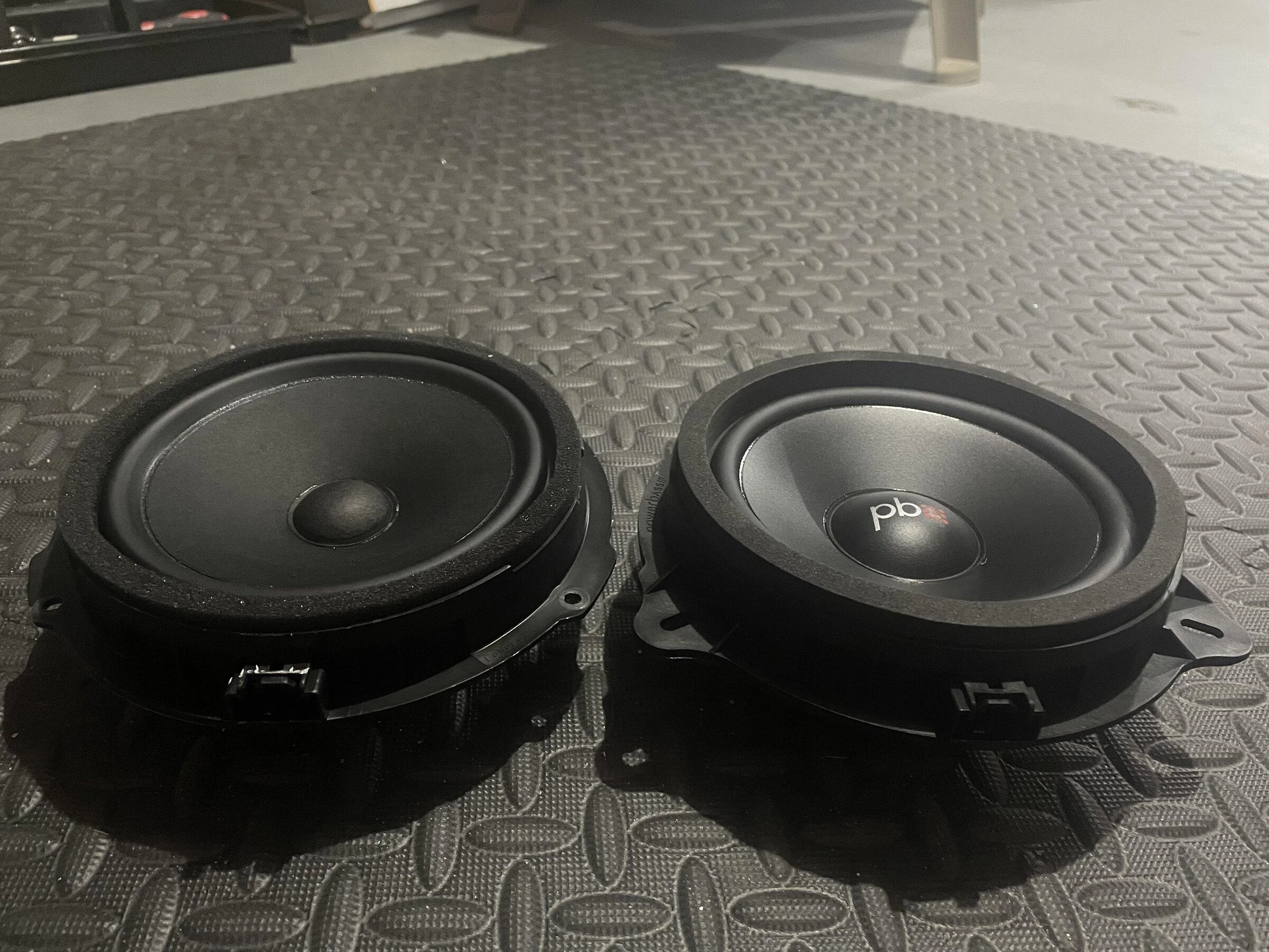

and ended up going with these because of the plug and play
Powerbass OE65C-FD
https://www.crutchfield.com/p_151OE65CFD/PowerBass-OE65C-FD.html - I couldn’t find them any cheaper than crutchfield and went with them for the free wiring harness which I may utilize on the rear speakers (had to put in a 2016 escape as the vehicle to register “fit” to get the free harness) - ***WRONG - can’t use on rear - used 72-5600 (72-5601 works as well, but pay close attention to positive/negative)

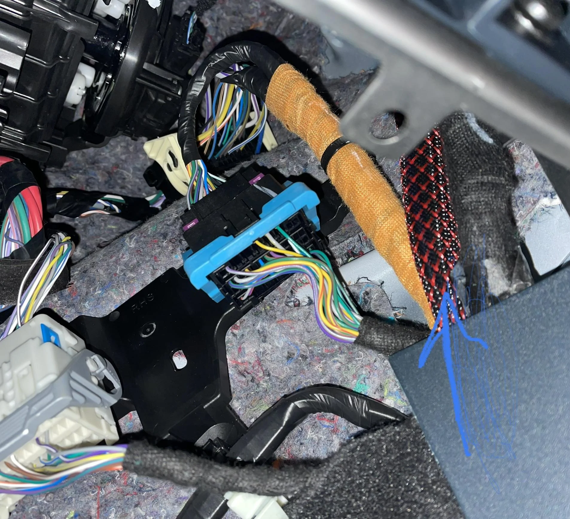

For the hideaway, I’ll be following what others have done and tap the wiring harness using high level inputs so I don’t have to worry about the remote wire.

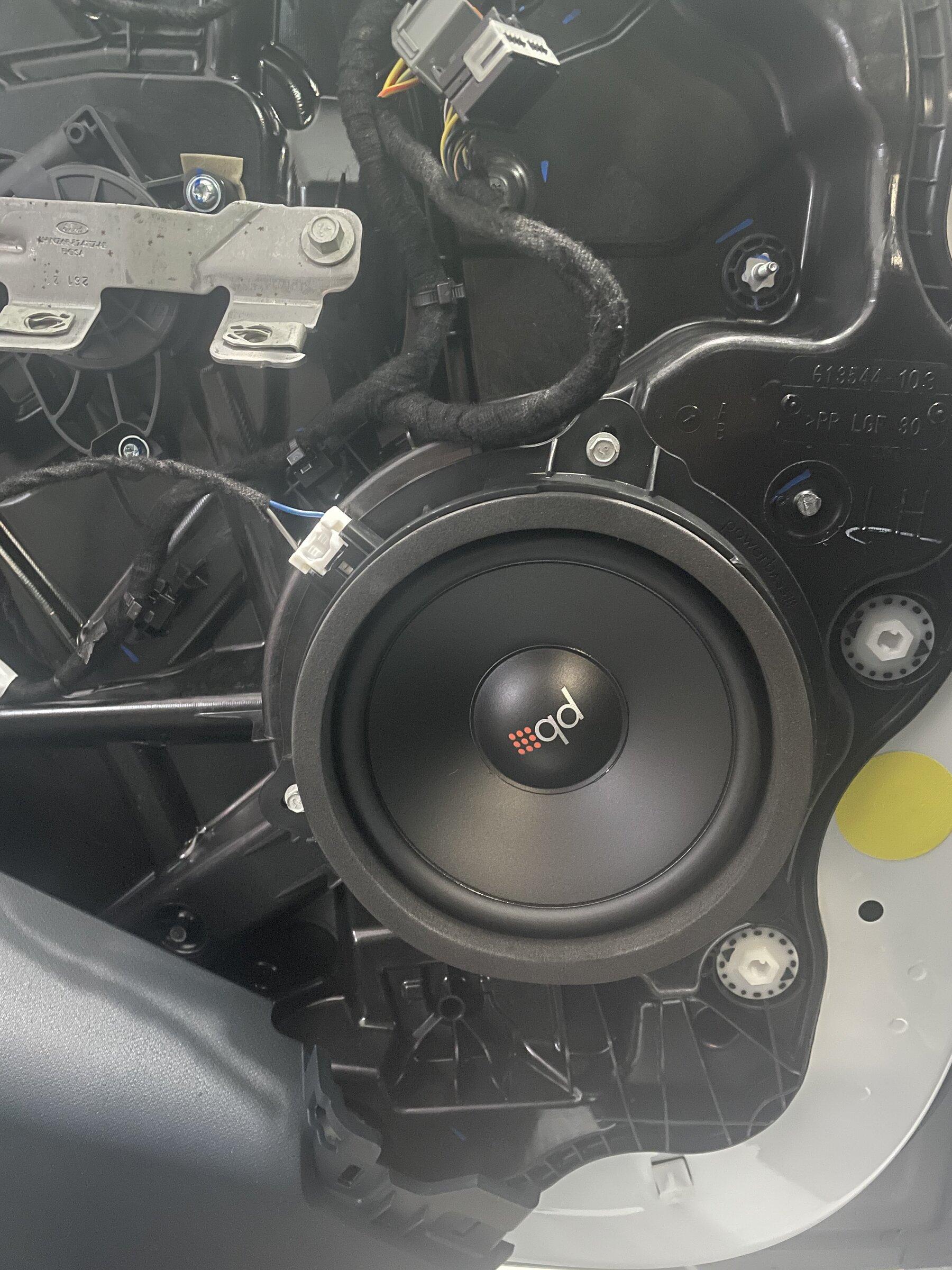

The powerbass components and kicker hideaway should be installed by the weekend.
Will be using this thread as a placeholder to update with pictures, lessons, review, etc…. I also ordered some Memphis 4x6 coaxials to try to retro/custom fit to the 4” speaker spots in the the C pillar speakers, but they’re back ordered meaning that will come later.

The Hideaway is doing some weird shit at higher volumes so while I have the rear panels off etc, I’m going to re run my power cabling as well as a 9 way speed wire for future upgrades - I’ve also ordered a do it yourself t harness from LLJ customs and want to have it ready to go so I can add more and play around with different configs - a simple factory upgrade has turned into more of a hobby)
I have an old kicker OFC amp install kit but we moved a few months ago and couldn’t find it so I used the harness wiring that came with the hideaway to get it in and to test/play around. I’ll be yanking it and running 4 gauge wire for power and ground to distribution blocks and will be playing around with a loc/controller to wipe out the sound processing from the factory unit. I’ll also be playing around with building some custom enclosures for under the seats for 8” subs. the hideaway is everything I need if I can get the higher volume issues worked out, but I’m thinking I “want” a little more (and thought about the 10” hideaway, but the more I use one of these all in one powered subs, the more I think I want to separate that - I also don’t have the extra fractions of an inch thickness that the 10” has over the 8”). If I scrap the hideaway in favor of passive 8”s under the rear seats, I’ll utilize my existing mounting board for the hideaway for an the sub amp and likely an LC2i (or different audio control unit) and amp the fronts (might go with hertz components if I do all that as well).
I’ll keep updating with pics throughout the thread, and once I’m done and happy with the final product I’ll update the main post with detailed pics of the whole process.
