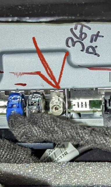

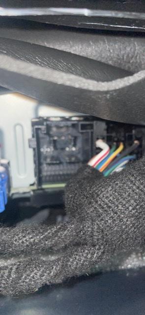

One other thing I noticed when back behind the climate control, there’s a 2nd wiring harness plug and this white cable to the left. I’m wondering if there’s a way to tap into that harness, etc for a sub (and then maybe use forscan to enable the signal, etc)
