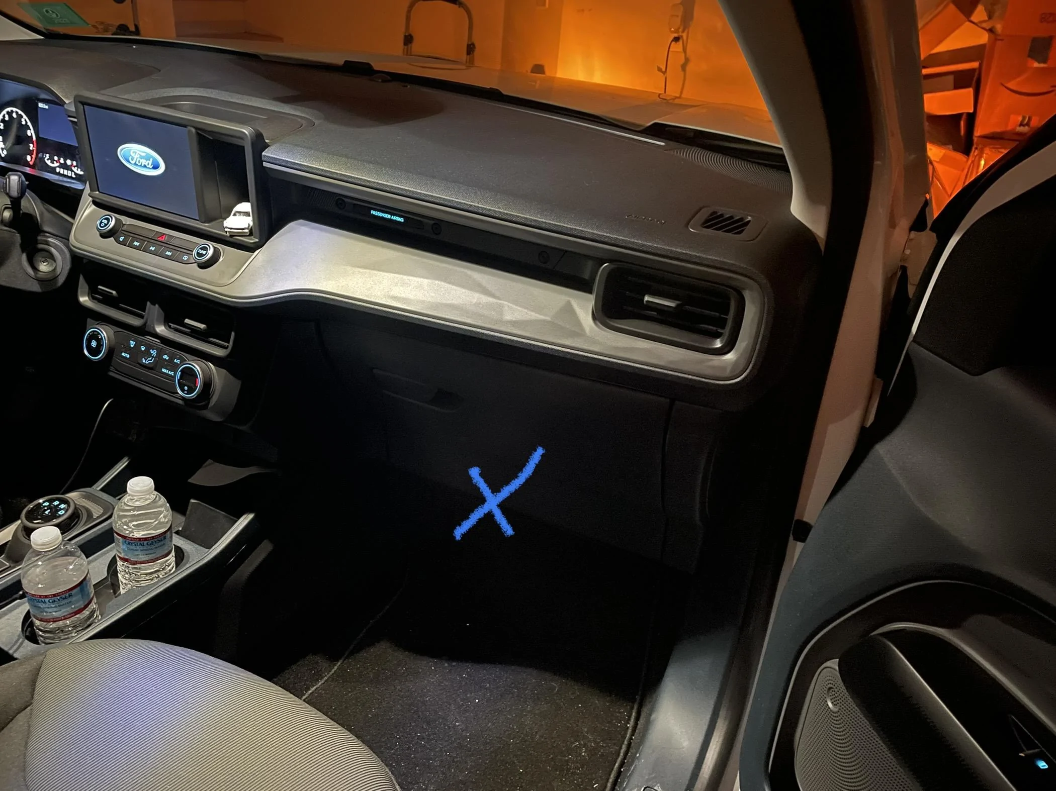

Okay I lied about no more updates til it was done, I found my spot for the Key
It’s the blue X:

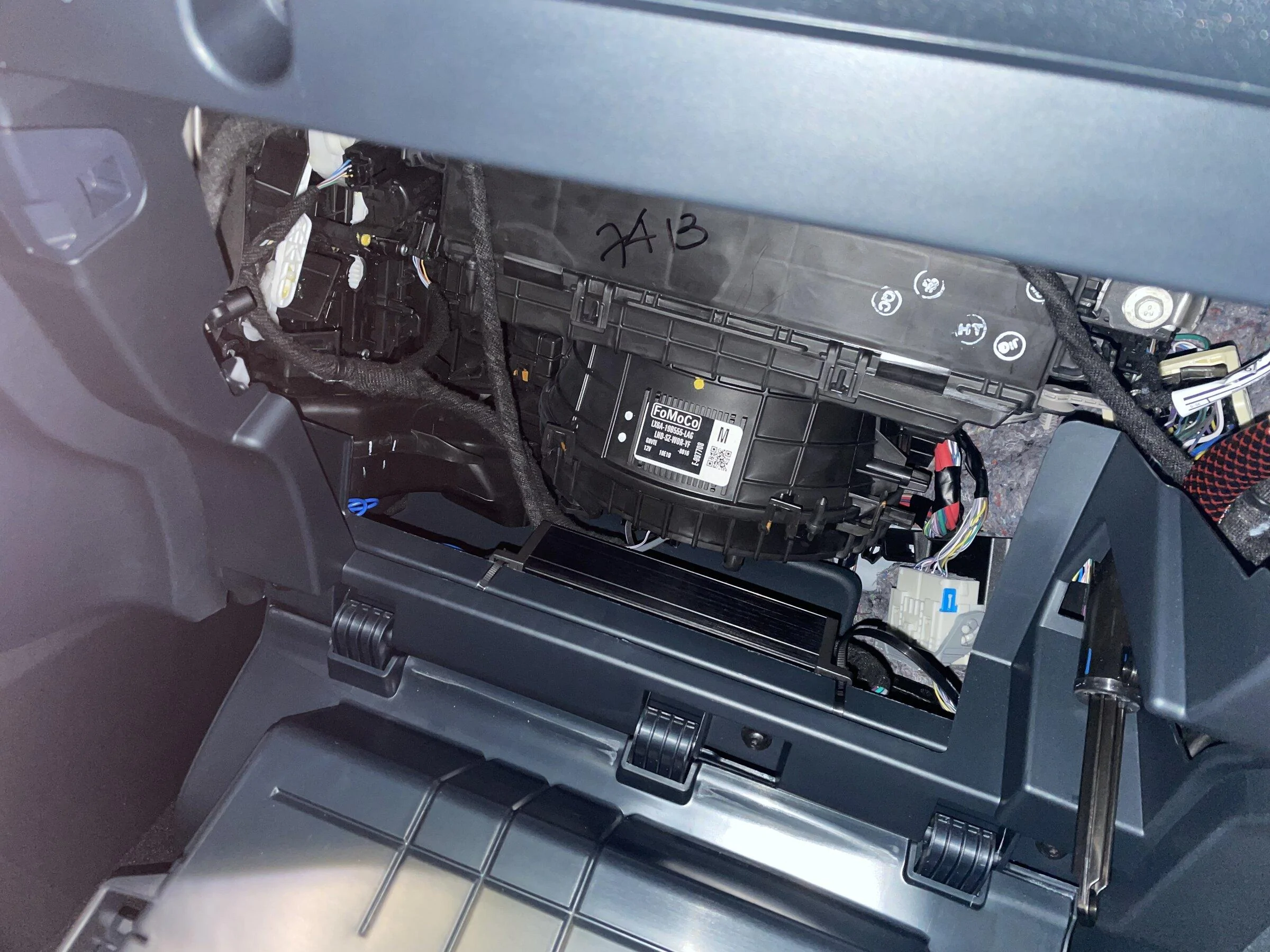

Ford Maverick Budget stock Audio upgrades (XL) - plan, research, options and experimentation 3B79AA95-48DB-45E9-984F-1B7A67725EF0
Went for right behind the glove box….
Ford Maverick Budget stock Audio upgrades (XL) - plan, research, options and experimentation 354F2F33-6321-461B-AD3B-9A1FC115543D
just zip tied it in there nice and tight…. It’s not going anywhere

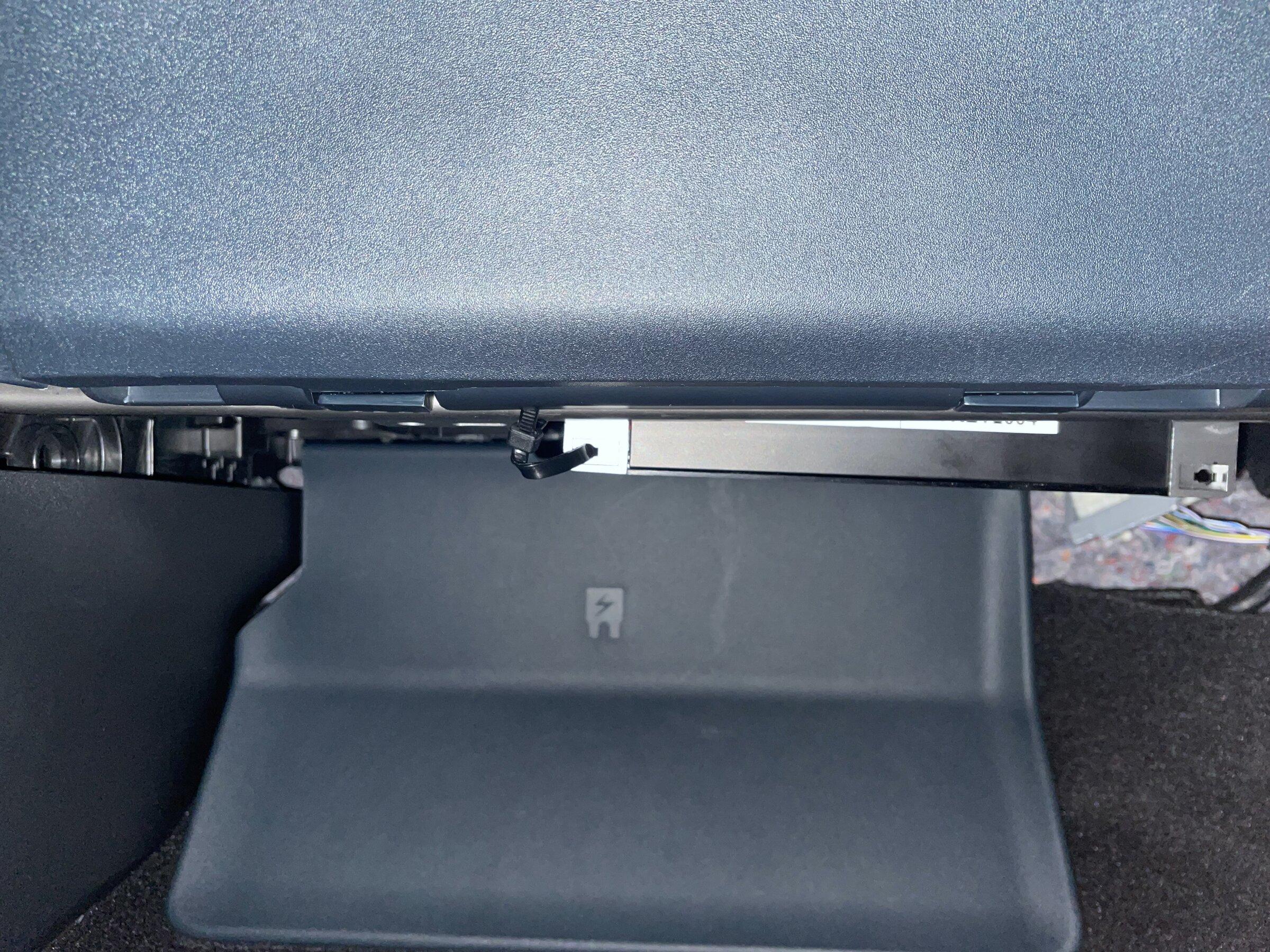

You can see this much of it if you look down underneath:
Ford Maverick Budget stock Audio upgrades (XL) - plan, research, options and experimentation B0F837AA-8AEC-4365-832E-63E32BD344D6
