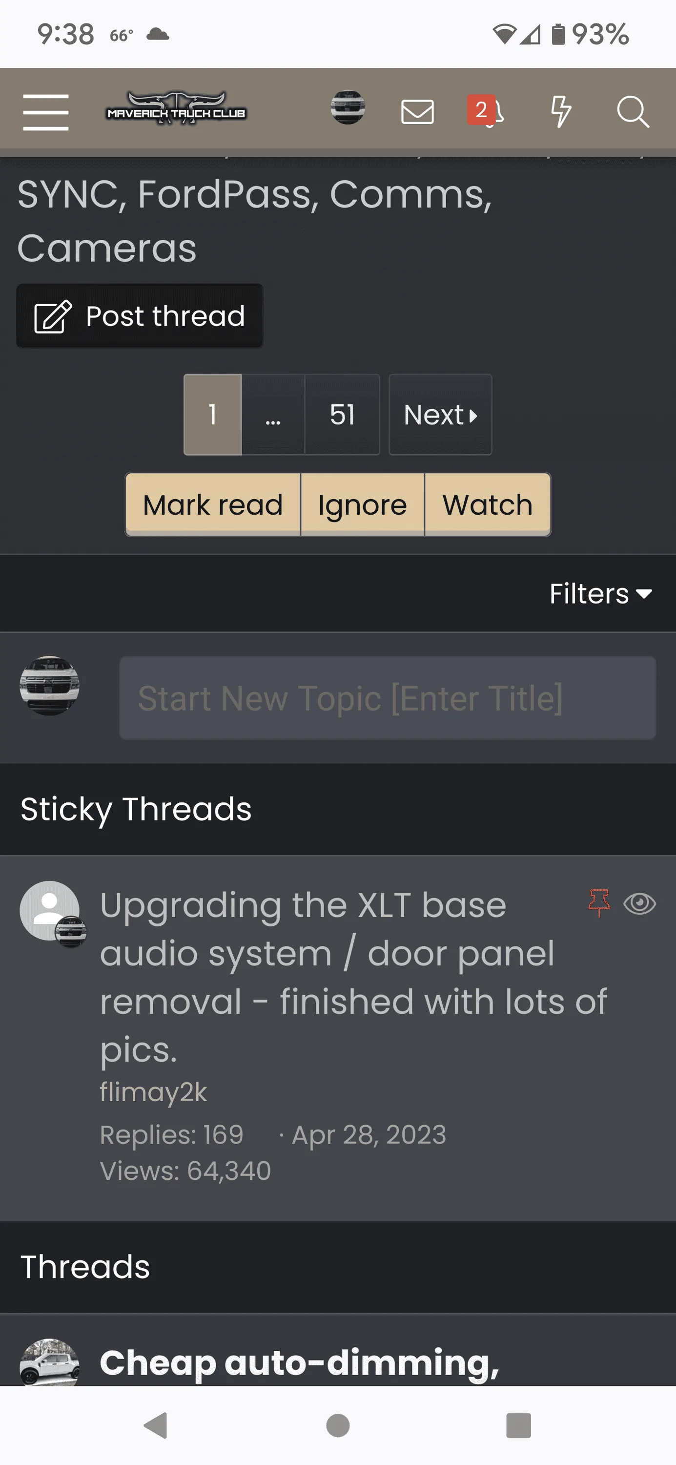

sticky thread pinned? is this a post?
Yep. Sticky threads are always at the top of the subforum.
This particular subforum only has one right now, but others have several.
