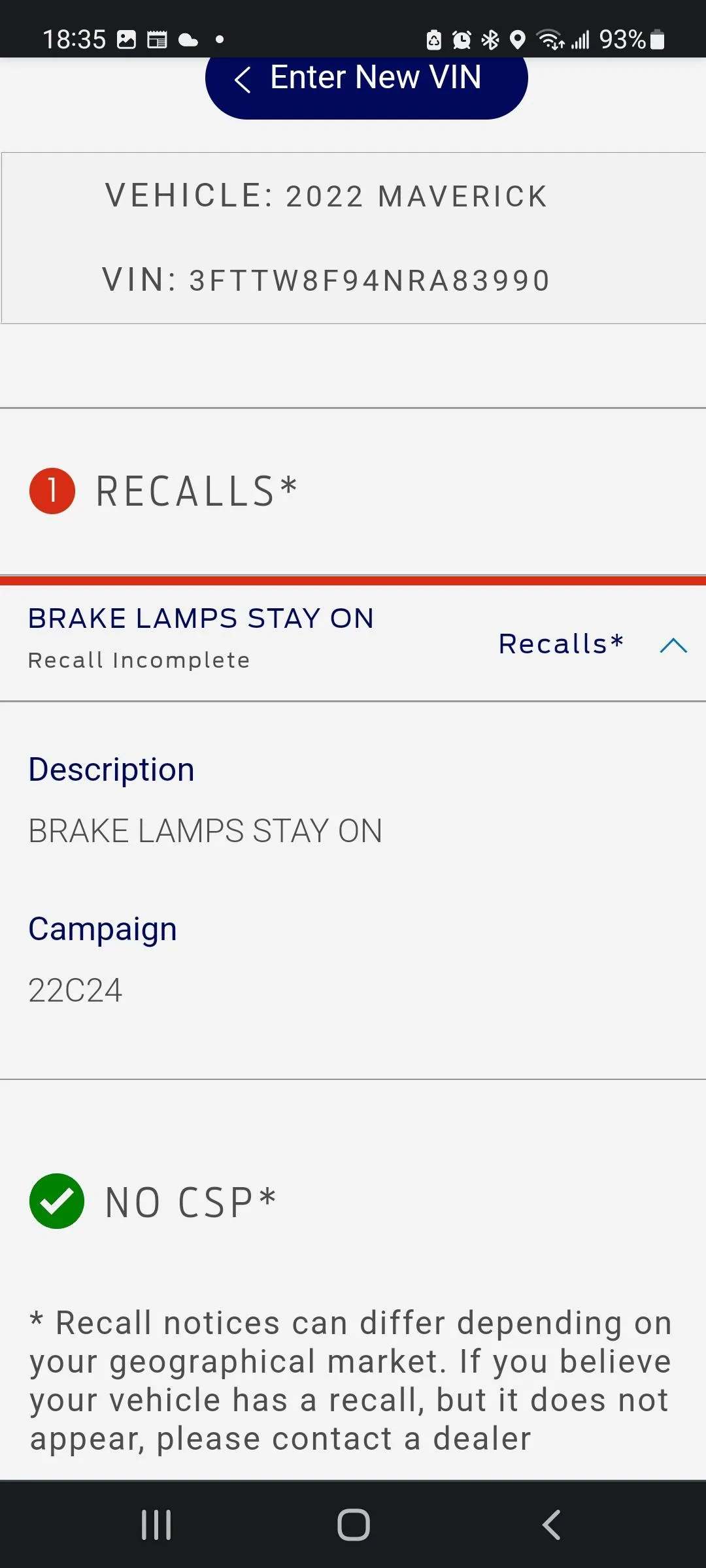

*Update*
Found the recall on the ford website, truck is currently in for that issue
Ford Maverick Brake lights Screenshot_20221031_183533_Chrom
