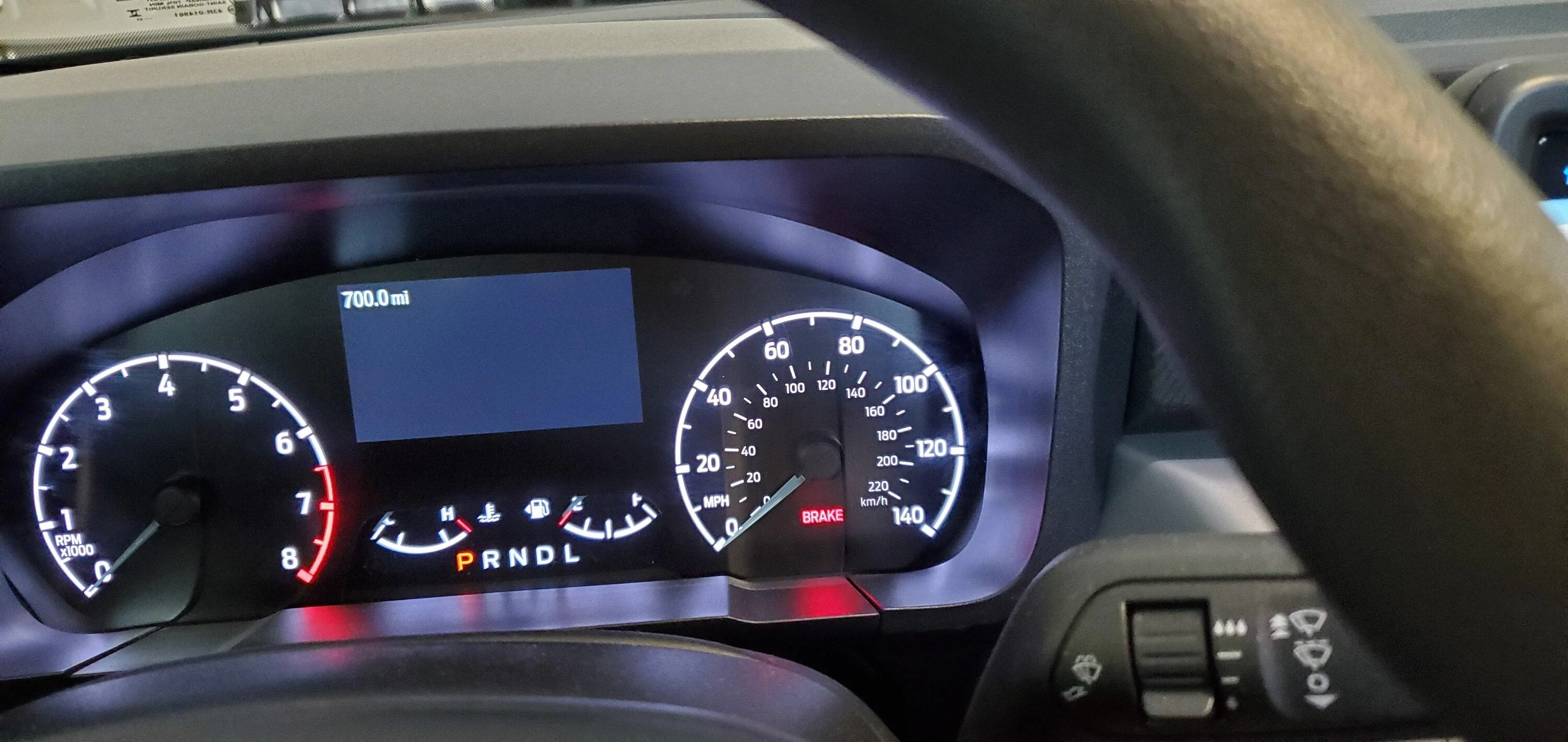

Does anyone know why I keep getting this "BRAKE" showing up on my dashboard? (Picture Attached) It seems to show up when I park my car and turn the ignition off.. sometimes the car will let me move and other times it will not... Much appreciated.
Hi there, I'd be happy to look into your Maverick concerns on my end. Will you send us a message with your VIN and dealership info? I can look into things on my end.
