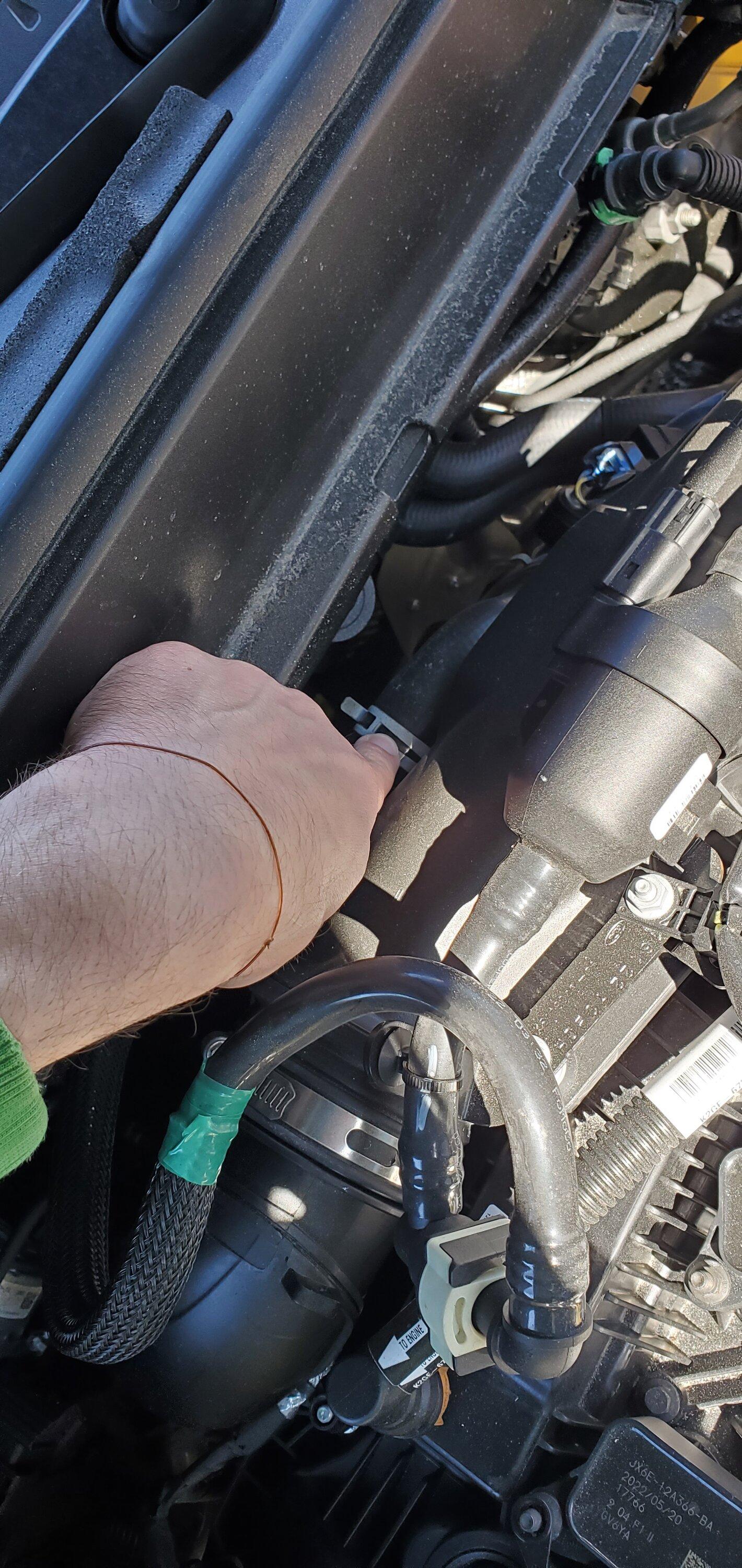

BPV Delete Homemade
The above link is a video from my YT page of my own custom mod I did to the BPV system. I pulled off the wastegate end of the hose, inserted a Dorman expansion plug into the rubber side of the intake hose piece, put a clamp around it and it sounds great. I will post pictures soon. It cost me about 2 dollars to do it.

Sorry for the delay in responding, family stuff. I will have to make a video and post it for everyone to see it. The way I did it was with my own parts and tools. It cost me about 3 dollars total for parts and I used the existing hose and clamps. I kept the rubber hose on the intake side and put an expansion plug on the open end of the hose and clamped it.
