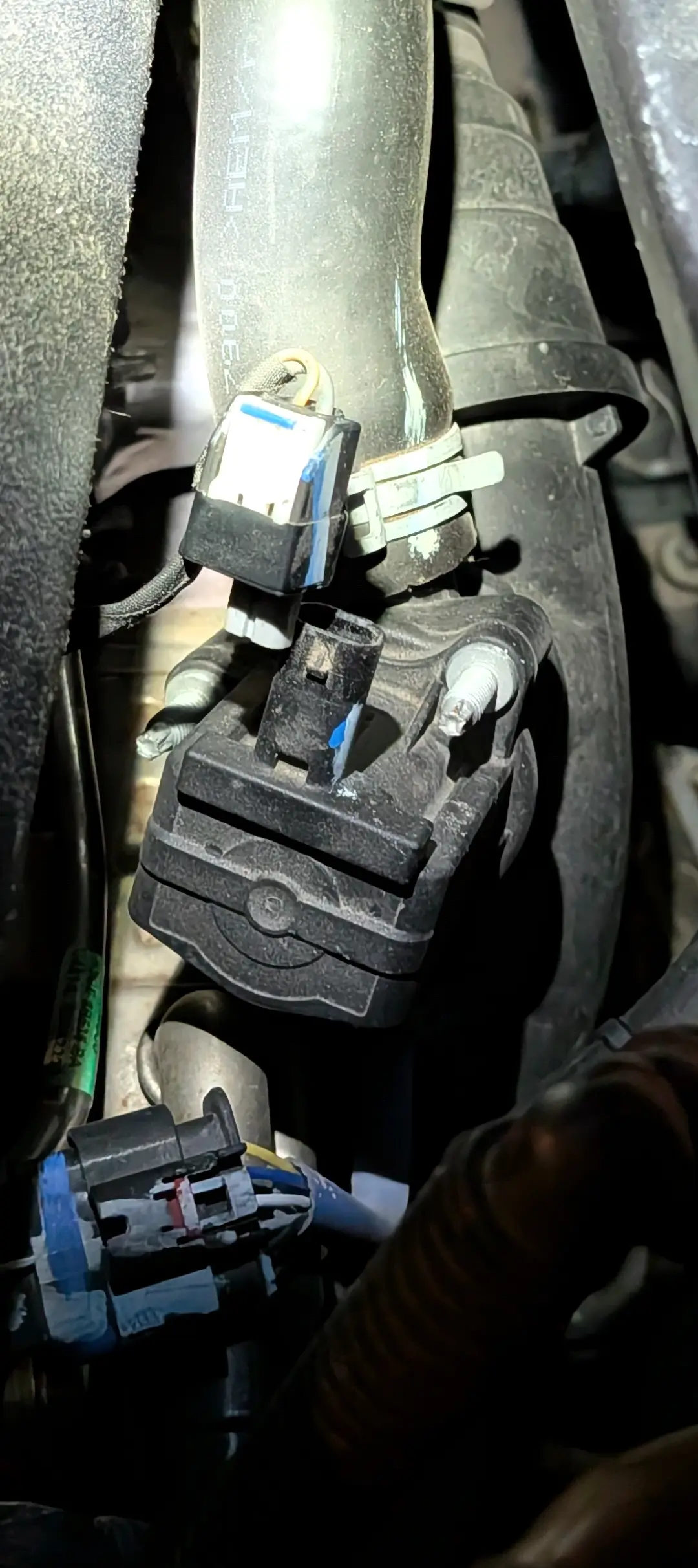

For those smart people among us, I understand this is a dumb idea.
For the rest of us morons, Maverick 2.0 StuStuStuStu happens.
I was poking around and decided to unplug the BPV and see what happens. I won't run it like that all the time, but it's turbo noises so yay! I I figured I'd bring it over here from my Facebook post.
I suppose I should explain more, I've effectively forced the bypass valve to remain closed when I cut throttle. This causes a shockwave to bounce back and forth between the closed throttle and the compressor side of the turbo making neato noises. This is a bad idea, it's hard on the turbo (a little?), and will cost excessive spending on all the women you'll attract. You have been warned.

That is even dumber than drilling holes in your Helmholtz Resonator. Good job!
Which sensors are being bypassed?

Literally nothing else was done, I knew one of you non reading "smart guys" would be here real quick.

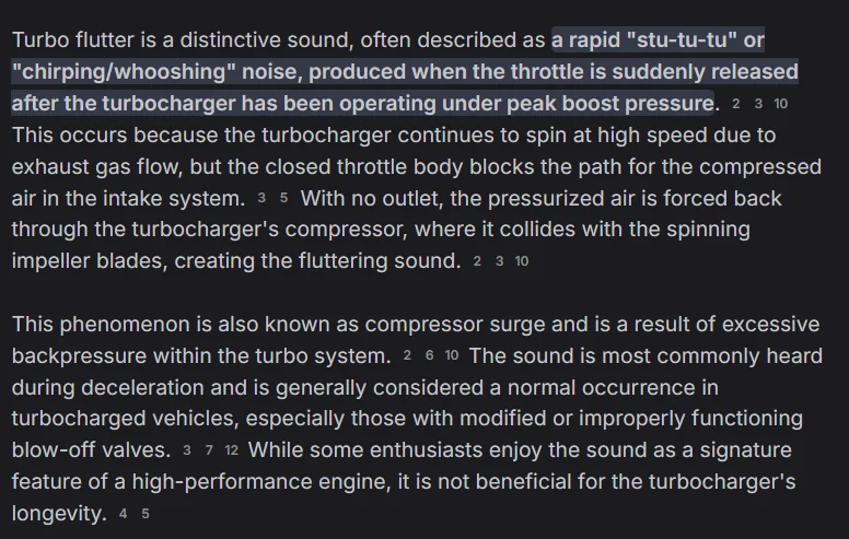

I've never heard of it as Stustustu lol so was wondering what you were talking about.
