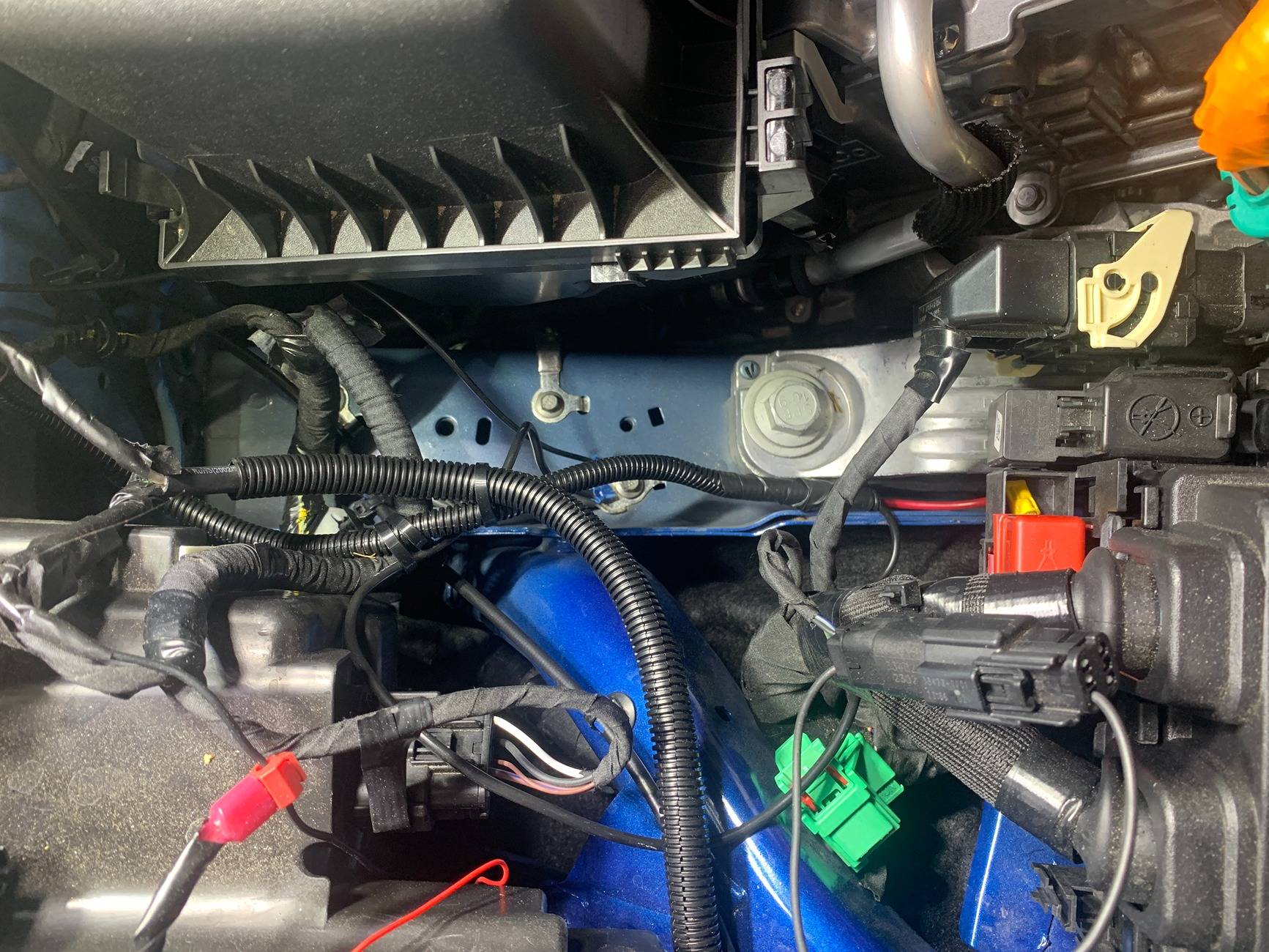

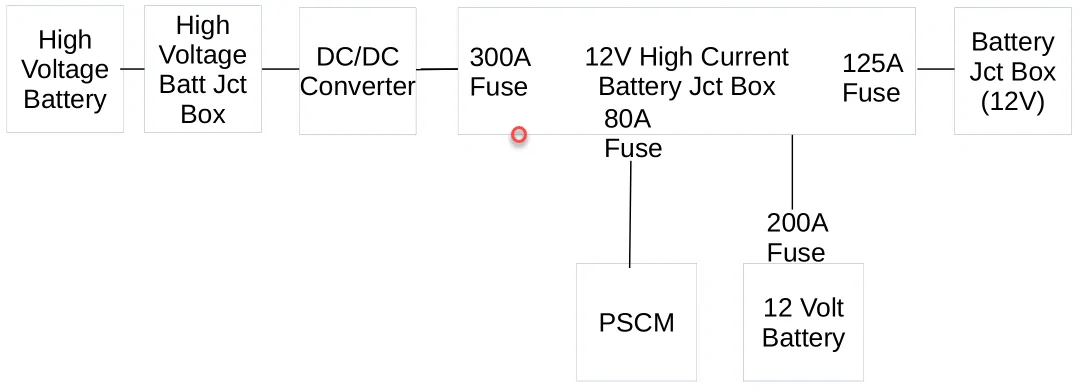

Jump Post via quick connect. Twice a month put it on charger set to AGM, Automatic.
Deltran battery tender charge
Jump Post is bolted to the high current battery junction box bus bar, about where red dot is.

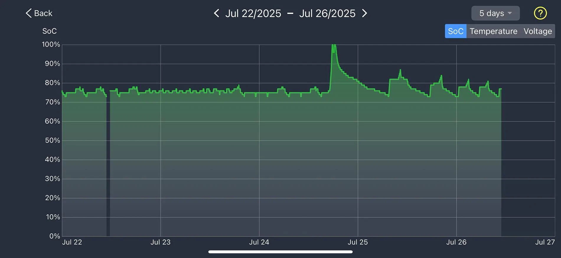

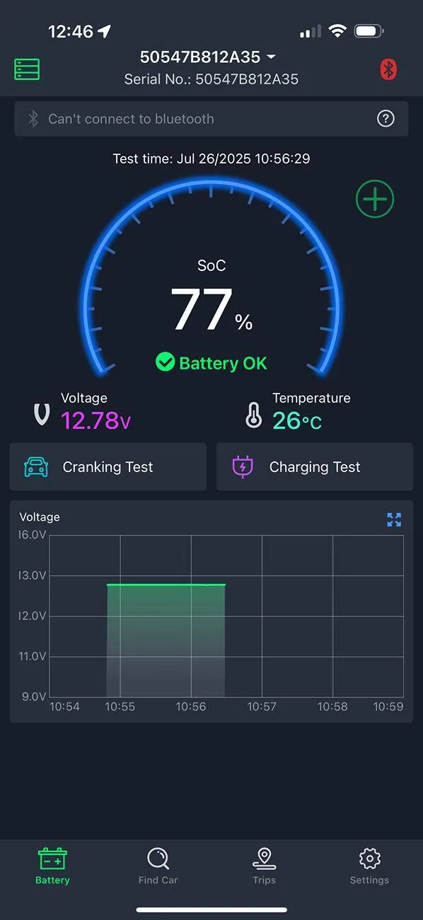

My truck has been on a trickle charger for 60 days as I am forbidden to drive (hopefully temporarily) for medical reasons. I use the jump points under the hood but disconnect them approximately every 14 days just long enough to run it for a while (although I have had updates to install the last two times, so it takes a little longer).

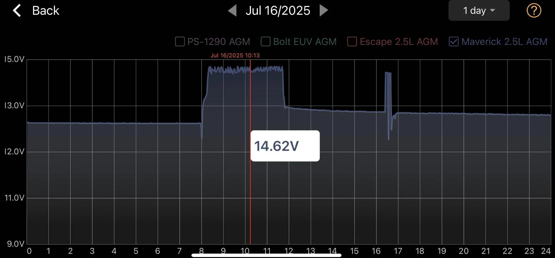

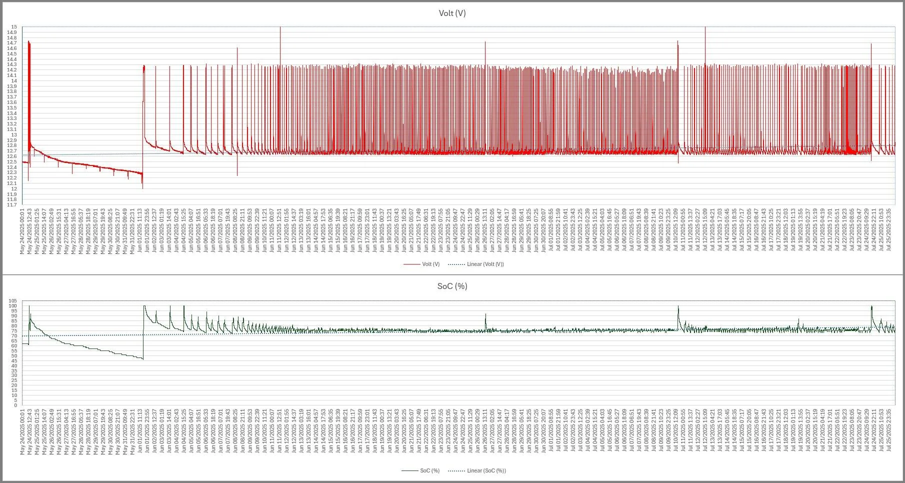

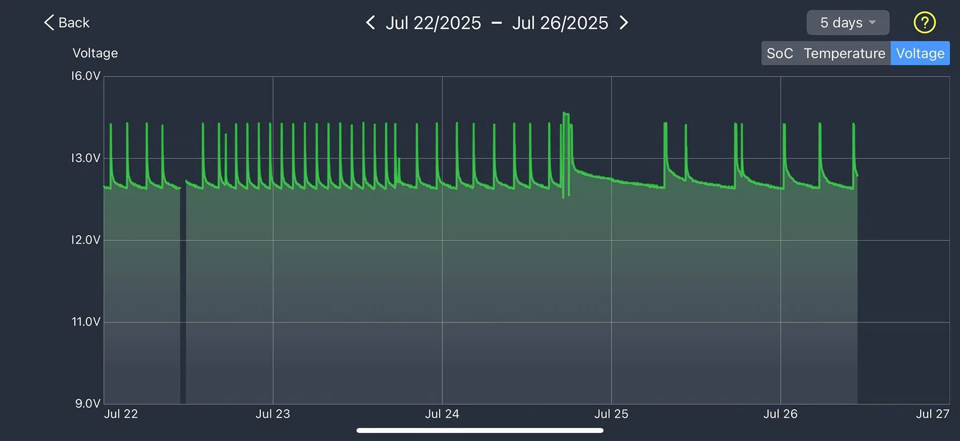

I will add my insight about the BM2 battery monitor. I have had one installed since my truck was about 1 month old. I keep the data uploaded into a spreadsheet that I wrote which allows me to analyze it. Here is some looks at the data.
Playing with data is sort of a hobby.
