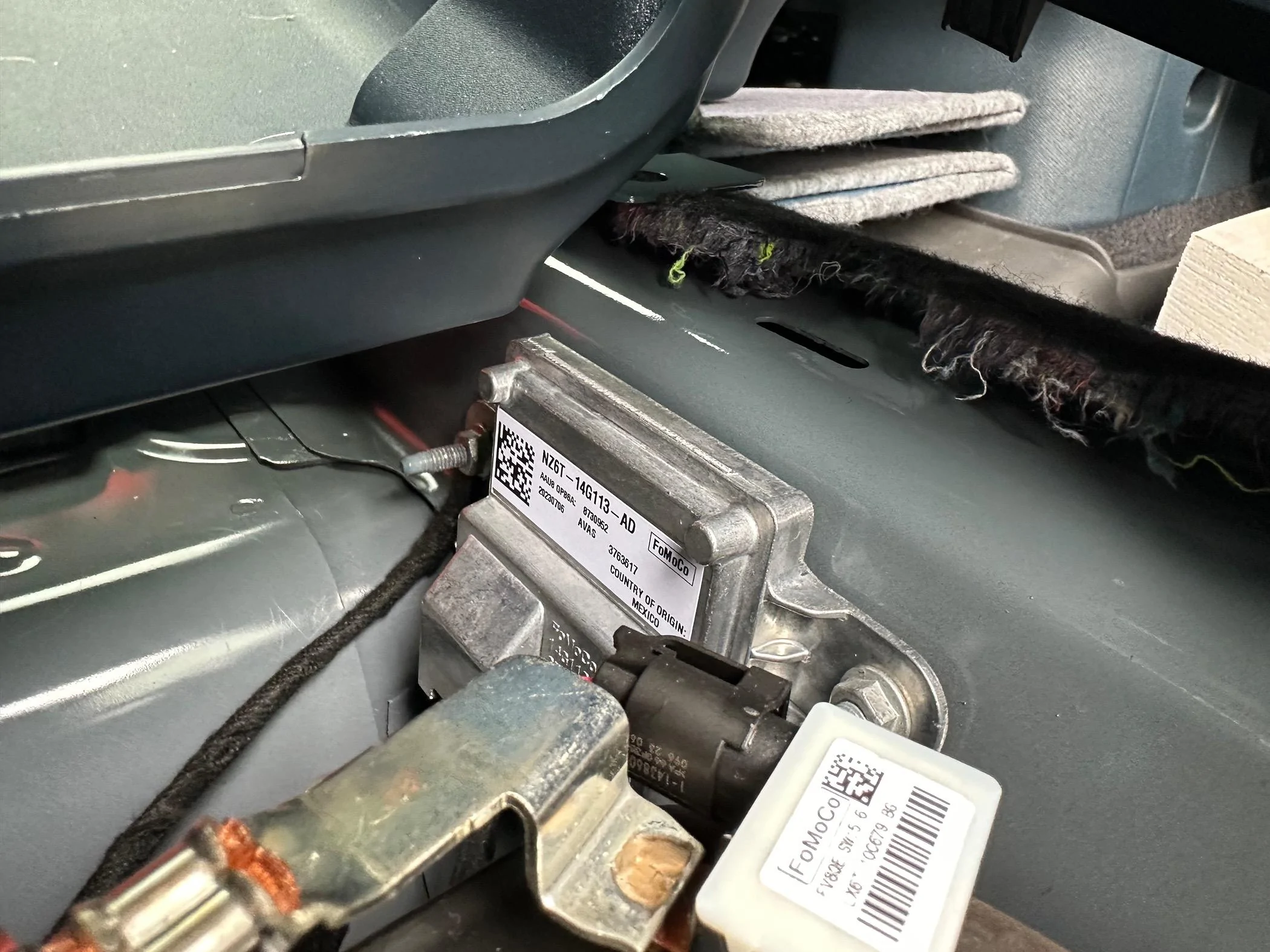

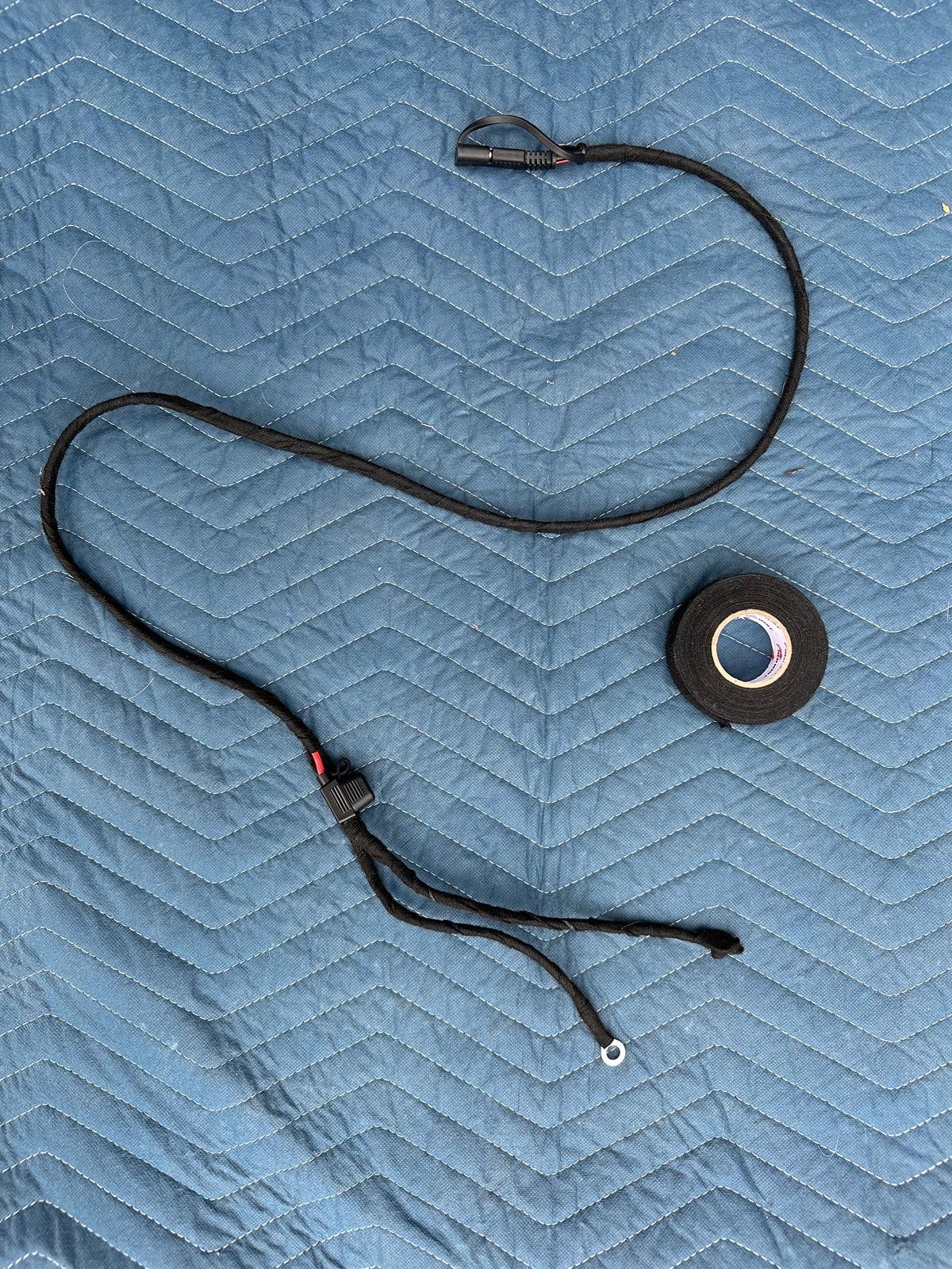

The cigarette lighter connection turns off after a few minutes. You can find an OBD2 plug on Amazon that will allow you to connect to the solar panel and charge your battery.
OBD2 to Cigarette Lighter Female Connecter Vechile Car Constant Power Cable 16AWG Safely with 15A Fuse
https://a.co/d/bKzrHcg
wondering where you plug in the OBD2 side?
There's only one OBD2 connector on the truck and that is under the driver's side dash.

The OBD2 port is on the driver's side, under the dash, very close to both the side panel and the bottom edge of the dash.
If you can't find it, ask a mechanic or someone at an auto parts store like O'Reilly's.
