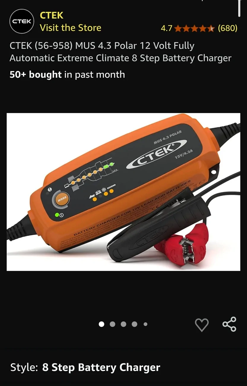

My Lobo is parked for the winter.
I have a Ctek extreme weather smat charger connected to the battery.
The charger monitors the battery and keeps everything tickety boo.
Just FYI - the symbols and writing big enough to read - don't say anything about AGM, which does have it's own limits to charging amount.
You have an AGM battery - you might want to check.
Most chargers make that claim if it supports AGM.
This charger is good for all types of lead acid batteries.
