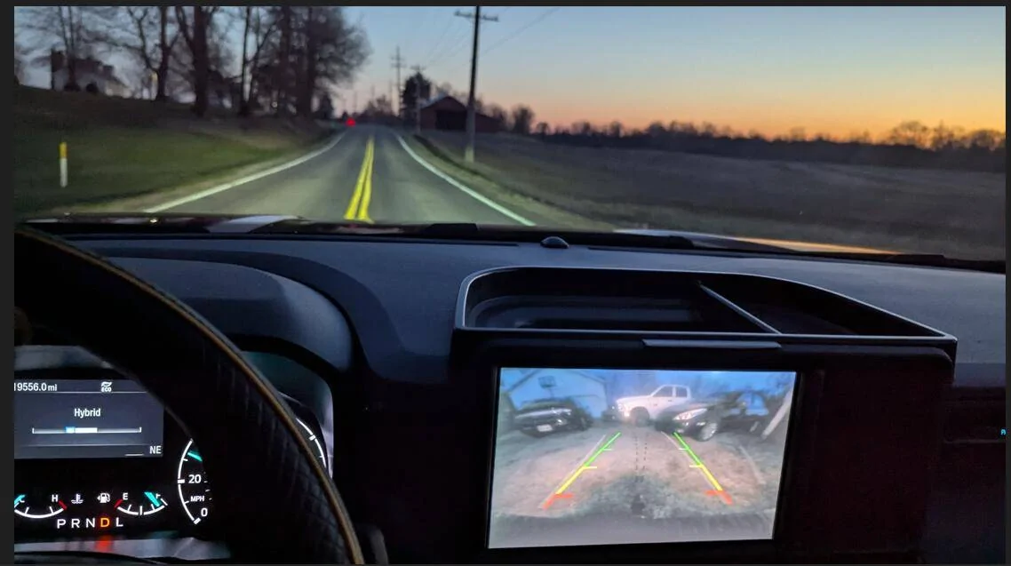

Since the frozen backup camera issue was announced, even in my Lariat with Sync3 [which was not affected by that recall], I make sure the image is moving as I back up.
Here is a picture of my frozen backup camera not moving while I was driving forward. I am scheduled for reprogramming next week and hope it does resolve this.
