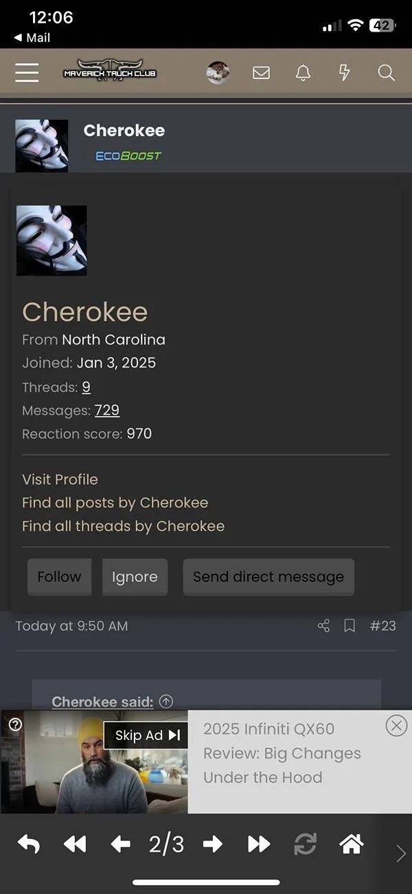

That is exactly the useful info I discovered is missing when I looked at the replies on a mobile device, that I'm very much in the habit of noticing on computer browser when folks don't seem to notice the difference between trims/years.
Thanks for posting that so mobile-only users can see what they are possibly missing, which does appear when using computer browser.
Of course not everyone fills that out completely with the useful details.
Only this shows on mobile. And there's room along the top of o post to show rest of that info.
