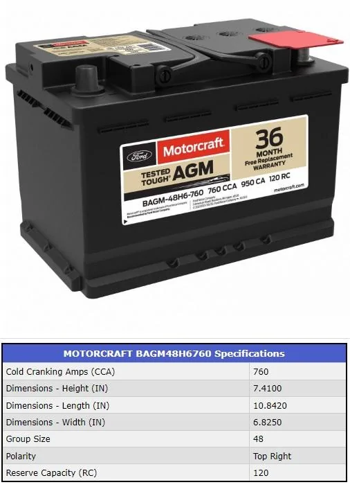

I actually consider to get a new battery myself and install it. One of these batteries, "Group Size H6", would fit (URL shortened):
https://tinyurl.com/m589863r
https://tinyurl.com/fnvfdprp
The question is, would it void the warranty? That's pretty much the only thing holding me back from replacing the battery myself...

Does yours not already have an AGM? Mine came with one from the factory. I tend to agree it sounds like a battery problem, though. I only drive mine 2-3 times a week due to working from home but I've yet to see this other than on days when Alabama returns to form and it is 90 degrees outside.

Yes, mine did come with AGM battery:
Ford Maverick Auto Shutoff/Start doesn't work... eb2.0 battery
The EverStart/ Diehard batteries have the Group Size of H6, with these dimensions (inches):
  • Height: 7.50
  • Length: 11.00
  • Width: 6.94
Both of them would be a suitable replacement in my view, but correct me if I am wrong....
I just need to know, if changing the OEM battery to EverStart would void the the warranty, or not.
Thx...
