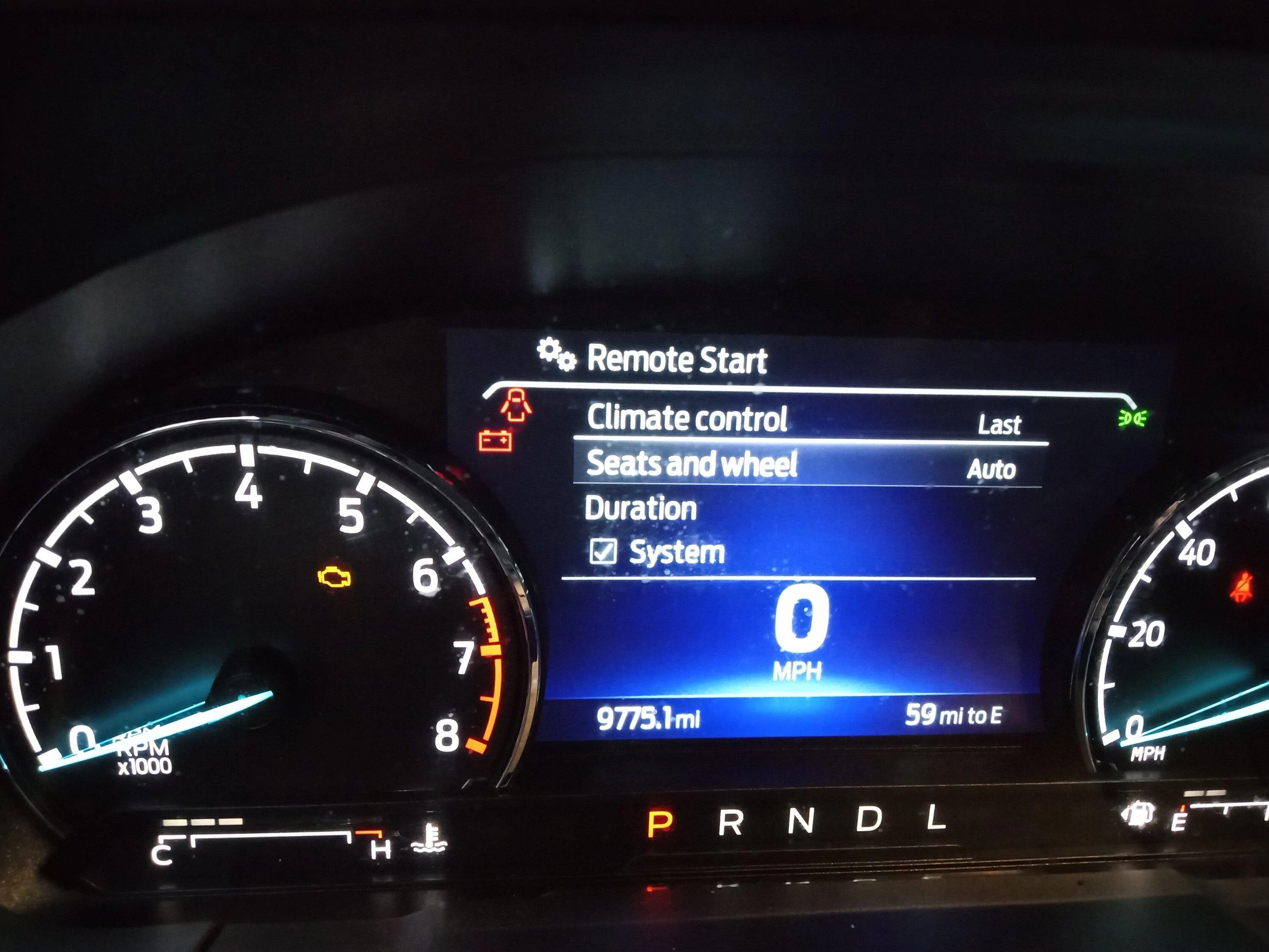

It's getting cool out and here are the settings in my Tremor that turn on the heated seats and steering wheel when the vehicle is remotely started from the key fob. Page 124. Instructions a little confusing.

Some individuals claim they were having trouble with the heating seats not turning on when the remote started it so I decided just to put a photo of my settings up there.

Some individuals had an issue when they use the remote start the heated steering wheel worked however the heated seat did not until they inserted the key and turn the ignition on OR pushed the start button. And yes when the key or push button was done the seats got hot right away. I had the same problem until I figured it out. Did you read what I wrote? Here is what I said' ( It's getting cool out and here are the settings in my Tremor that turn on the heated seats and steering wheel when the vehicle is remotely started from the key fob. Page 124. Instructions a little confusing.)
