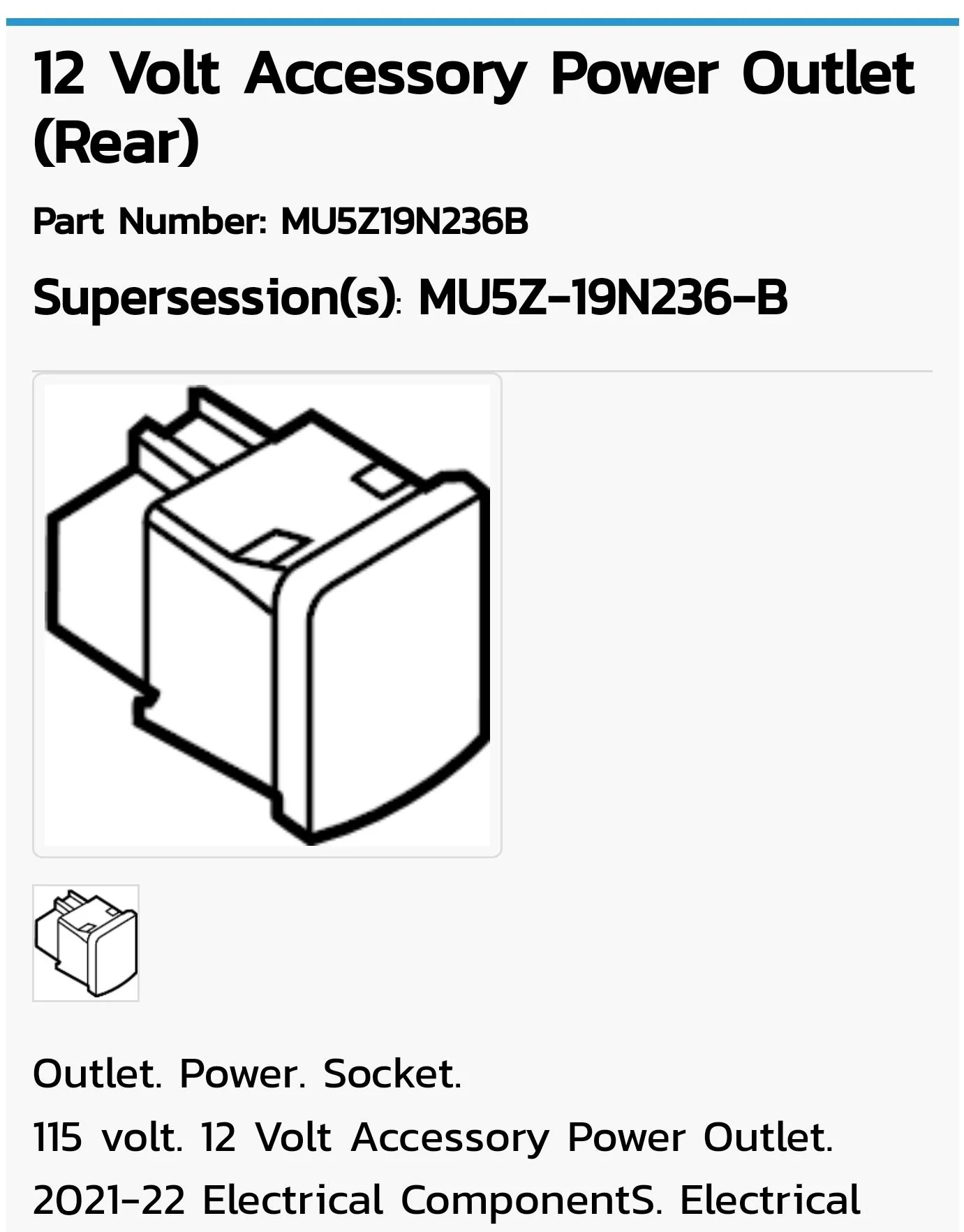

Just wanted to share my inverter story here in case it helps someone like me down the line. I bought my maverick used, and I don’t think I ever checked the bed and cab plugs to make sure they worked, but after installing a turn signal stalk and activating LKA with Forscan, I saw I was getting the DTC that the inverter didn’t work. Might have been there before, I don’t know. I made sure to not touch any forscan settings in the BCM so I know it wasn’t forscan.
The cab plug would light up for one second when I started the truck, but it would then turn off. I checked all connections, and everything was connected. The bed plug never lit up and didn’t work at all. I was worried it would be the inverter itself, but I remember reading that neither plug will work if one is broken. Since the bed light never lit up, I decided to take a chance and buy another OEM bed outlet for $55.00. After installation, both outlets have an orange light and they both provide electricity. So if your cab outlet flashes once and goes out, it could be that it’s starting up, but when it sees the bed outlet is dead it kills everything.
Like I said, just wanted to put this out there because it worked for me, and if you have the same symptoms, trying a $55 new outlet might be better than a $400 new inverter.
