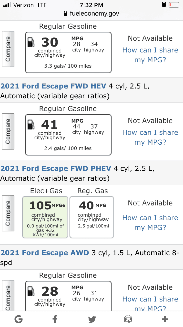

Peps
Jul 22, 2021
386
439
New England USA
2020 Volvo XC40
regular gasoline on both the 2.0 and 2.5 hybrid.
for the escape these are the EPA stats with the type if gasoline.
