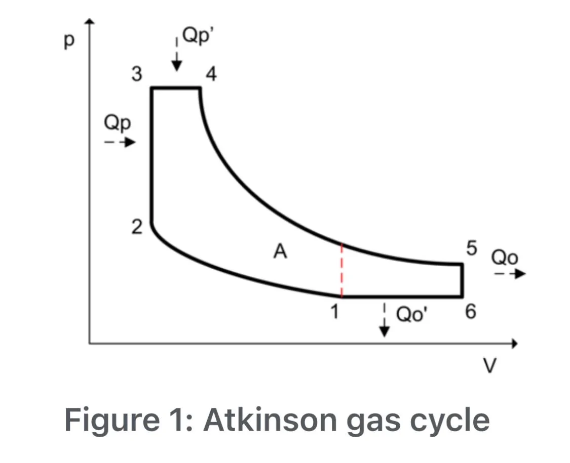

I don't know if this has been posted before. If so, it was a long time ago. I've not seen it recently.
A diagram of the Ideal Atkinson Cycle. Not specific to any vehicle. But shows an example of the theory behind it.
pressure vs. Volume inside the cylinder
Ford Maverick Ideal Atkinson Cycle IMG_2406
6 to 2 the piston is moving up
3 to 5 the piston is moving down
1 to 2 is compression
3 to 5 is power stroke
2 is spark
The distance (ratio) from
6 to 2 and from 3 to 5 may be
"13:1" in both cases.
But really only the expansion ratio is 13:1 and the compression ratio is a more typical 9:1 as the low octane requirement for hybrid engines would suggest.
