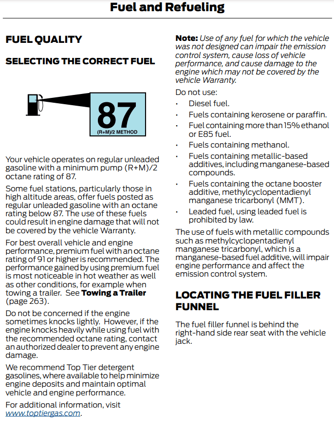

I want to believe this. The problem is tests keep coming out that say otherwise. Like Car & Driver sticking a dyno on and testing each grade's horsepower:
https://www.caranddriver.com/features/a28565486/honda-cr-v-vs-bmw-m5-ford-f-150-dodge-charger/
Now, Car & Driver's testers don't even mention ethanol but if that's not the reason, and octane grades do nothing more than avoid knock, then where's the extra horsepower coming from? Or is Car & Driver being paid by the Big10 O&G companies?
Because when the created a base timing map they used premium. Anything less results in the knock sensor retarding timing.We talk a lot about compression ratios in this which is absolutely true, but you can't forget the timing curves based upon load, RPM, IAT, etc, since timing stresses the fuel a lot and impacts efficiency.
All cars will have a base map of timing created using the intended fuel (I think we are fairly confident that the intended fuel for the hybrid is 87) in fairly ideal conditions. Basically it's just a 2 matrix based upon load and RPM. Then there will be tables that generally multiply, or add or subtract based upon certain parameters. Like if you have really high air intake temps or the knock sensor starts getting pre-ignition, or fuel trims are way off, the motor will pull timing.
The more timing the better. But in my experience, I haven't seen maps that increase timing and try to get better efficiency. Because that is tough and requires instrumentation that engines don't come with. (think individual egt and wideband O2 sensors for each exhaust bank). The only real learning I see is in STFT, and LTFT's. Which are fuel trims based upon closed loop operation. ie. the ECU is looking at the MAP of MAF sensor in relation to the wideband O2 sensor and learning how to hit your desired lambda - AFR, because fueling is always a moving target based upon many variables.
TLDR: intended fuel is 87 and the motor would have been tuned using that. You shouldn't see a performance or efficiency increase using a higher octane since all maps are tuned to take away timing.
On the power question, that's a bit more complex, I could speak to the ICE side, but I think there's more potential on the battery motor side. But regardless of either, the ECU needs to be cracked, and software to modify to make any significant gains. But there probably is not enough interest, so there won't be a lot of support.
