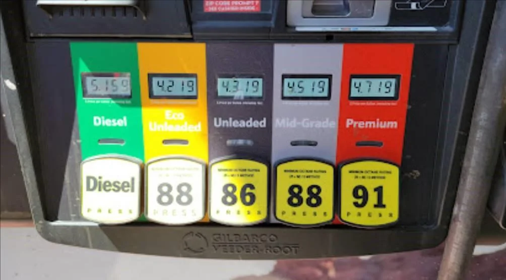

Um, there is no such thing as 88 octane or E88. There is 87 octane which is regular gas and fine .
There is E85 which is 85% alcohol and used ONLY in flex fuel vehicles and is NOT ok to use.
I strongly suggest you both read your owner's manual in detail and spend some time on wikipedia or something educating yourself about gasoline.
Thought a visual might help the nonbelievers. Approved for all vehicles 2001 & newer, along with all flex fuel vehicles (FFVs). Been available since July 2012, and now has grown to 31 states.
Ford Maverick 88 Octane Gas in Maverick Hybrid? Maverik Eco 88
Unleaded 88 (15% ethanol) is all over the place here in WI and Upper Michigan especially at every Kwik Trip.
KT went all in on E15/88. They built their own ethanol splash rack in Madison.
By splash I mean they go to the Flint Hills or US Oil terminal and get however many gallons of base fuel, then drive half a mile down the road to their rack and splash in 10% or 15% ethanol into the tanker compartment. Apparently it was cheaper to buy the ethanol in bulk and splash it themselves.
