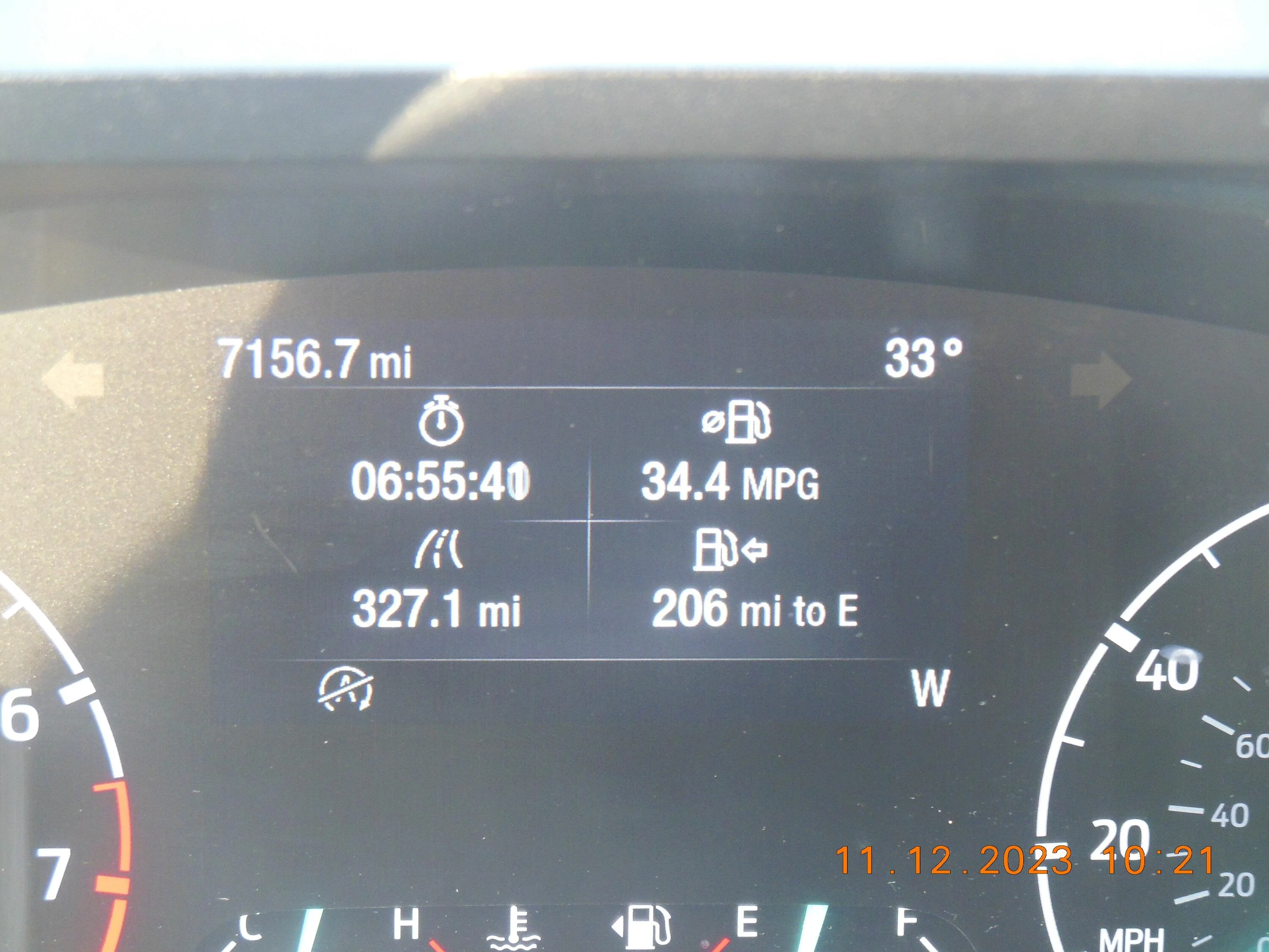

Premium is $4.299/gal. here, that's what have been using. I'm old and drive that way also.
