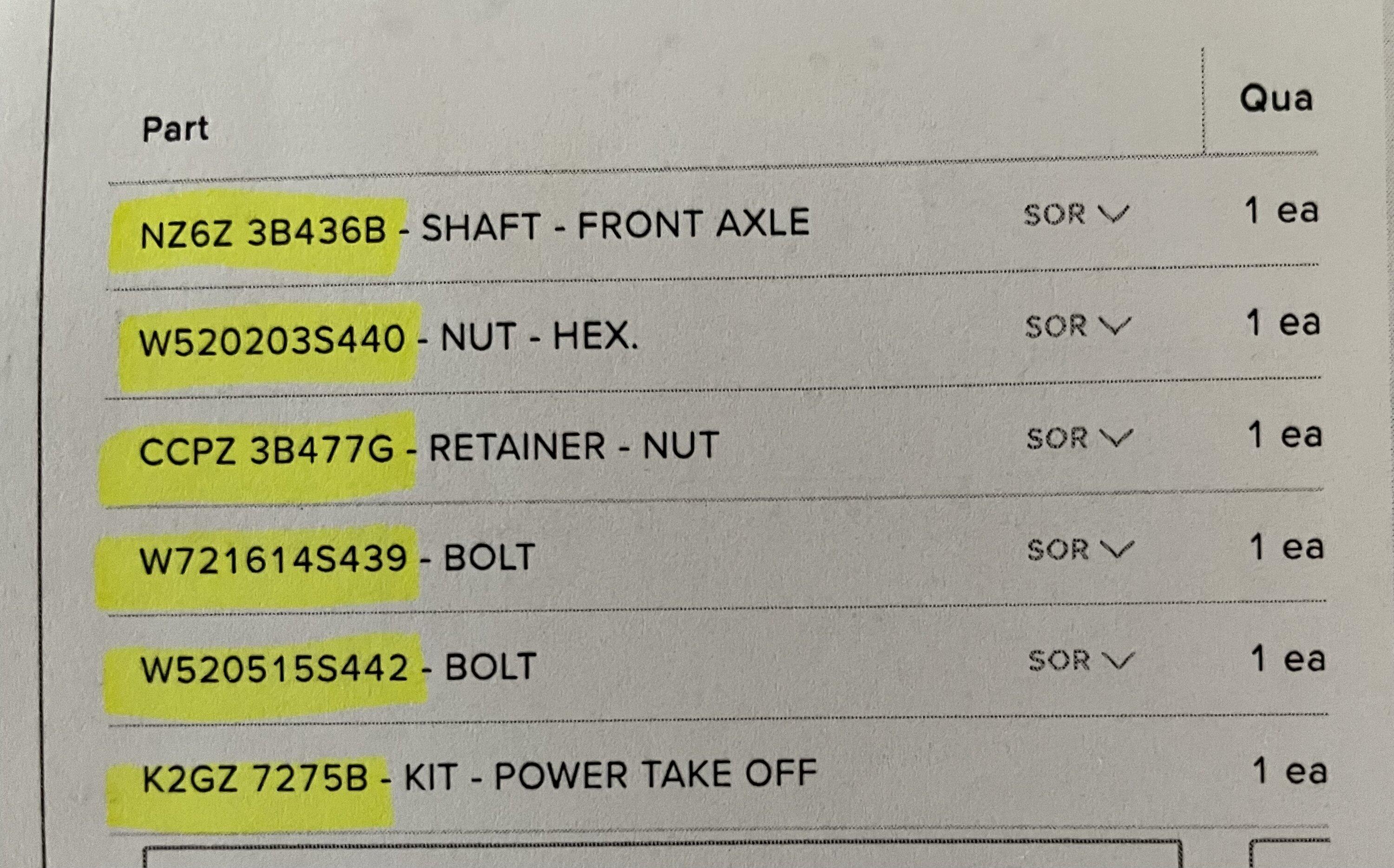

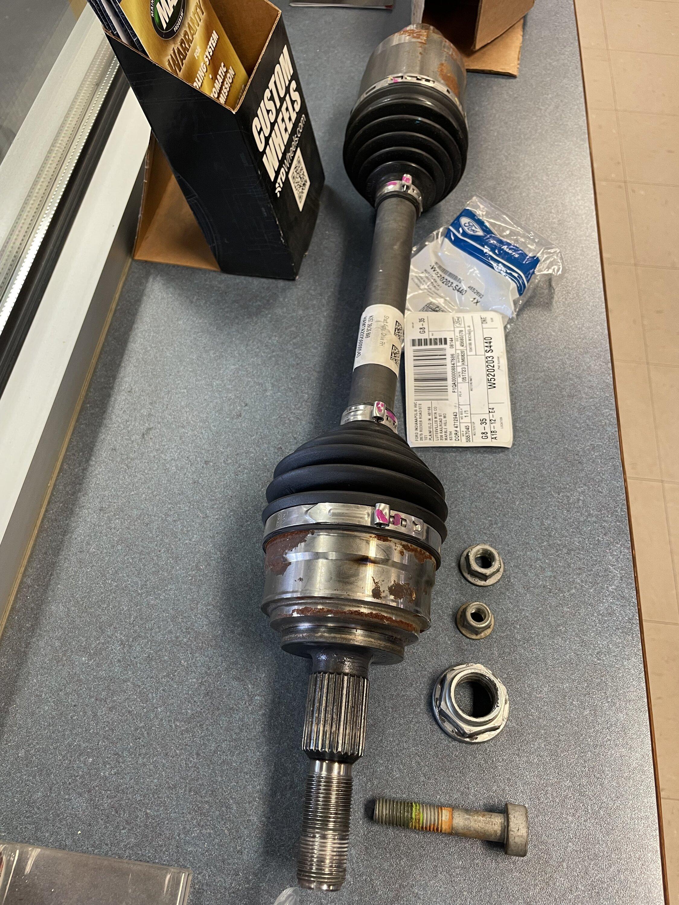

I think it really depends on the actual dealership you’re dealing with. I screwed around with Ford and the dealership that I bought the truck from for over 6 months with no support whatsoever.
Supposedly the Ford engineers told the dealership that the first thing to check would be the wheels and tires. Since I have a lariat I was told they could only use wheels and tires from another lariat. None of the local dealerships had a lariat in stock, or on order, so someone would need to order one, have it arrive about a year later and be rejected for acceptance. Only then would they be able to get past the 1st step of determining that the wheels are tires were not the problem and diagnose further.
I told the Ford rep how asinine that sounded but was told that any path forward was strictly between the dealership and Ford engineers. So, I requested the rep contact the engineer and tell them how stupid their idea was, but they have no insight into who the specific engineer is.
At my request, the Ford rep found another local dealership that was willing to help. That dealership actually looked at the Maverick and decided that the problem was most likely the front axle, but the parts required were on back order with no ETA. The rep requested a rush on the parts but said it may have no impact due to part shortages. To everyone’s surprise the parts showed up in 2 days. Took a week to schedule it in for repair and a half day to fix. It’s been about 4 weeks now with no wobble.
Evidently, the dealership takes their direction from the Ford “engineer” and must follow that path for warranty reimbursement. So, I guess if you find a dealership that takes the initiative and happens to deal with a real Ford engineer it could be a fairly smooth process if the parts are available but as far as ordering the parts first to have them ready to go I doubt that would never happen.
Hopefully I’ve answered your question correctly. I’ve tried to attach a list of the parts that were replaced.
