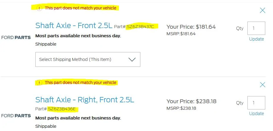

I'm sorry If I missed this someplace or I just don't understand the part number system, but I need to replace the passenger side CV axle and I cannot find any reference to the part number on my 2022 Lariat Hybrid. I was able to take a picture of the axle, and the part number is clearly NZ67 3B436 CAB. I cannot find this part listed on any forum and a new part with that number does not seem to be available anywhere, I can only find this part on ebay. I assume is has been replaced with an SZ part number, maybe SZ6Z-3B436-E, that looks like the part most 2022 Lariat Hybrid are using, but they all seem to be replacing NZ6Z 3B437 B. Mine says NZ67, not Z and I suppose its possible that its damage to the label and the 7 could have been a Z, but I still cannot find anything that ends with CAB. Has anyone else replaced NZ67 3B436 CAB, and can they tell me what the new part number is?

I recently had the same part # CV axles put in my truck.
