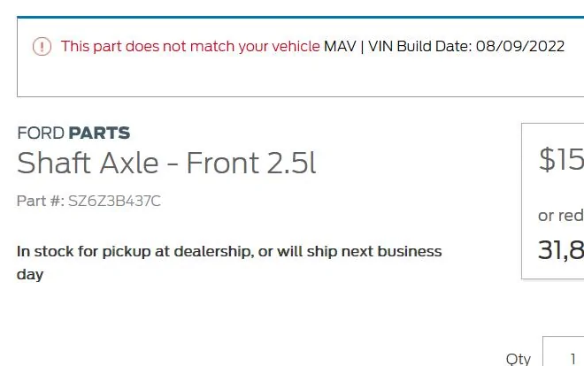

Also why is that SZ6Z-3B437-C ( I believe its the driver's side) shows as "this part doesn't match your vehicle" for the MAV Hybrid in parts.ford.com and other ford parts websites?

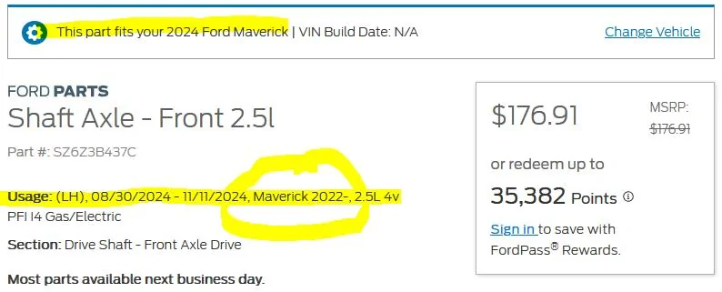

I was going by my VIN (Model year 2023).
If you search the same part for a 2024 Maverick (hybrid), it "fits".

I just did the same on their website, put my VIN in.
looks like the passenger side is ok but this one still show up as a non match for my VIN.
Mine is a 2022.

Ahh ok I see it now.. however its still weird as I have a 2022 not a 2024... so i was just wondering since its still not good... but i guess they installed what they thought should fit... i didn't provide them the part numbers this last time.
