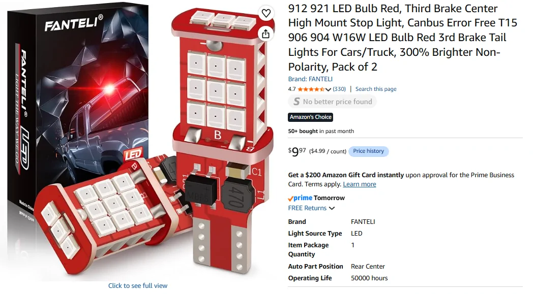

Went with the Fanteli LED the non flashing model. We'll see how long these last. I also have the Lasfit cargo lights and have no issue with them so far. Don't want to change the whole unit yet. Thanks for all the recommendations.

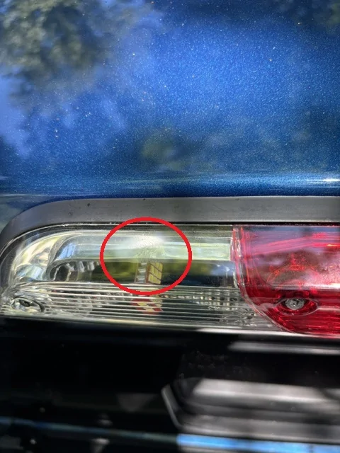

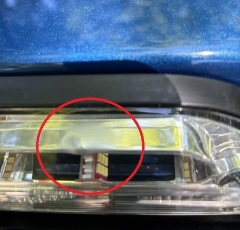

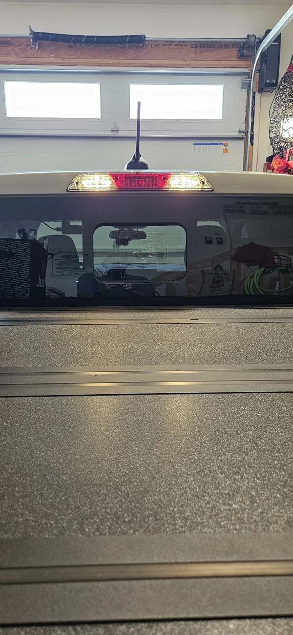

I installed these LEDs last week. They started to melt the reflective material inside the housing. I do not recommend using if you want the housing to remain in pristine condition. Long term effect? Removed.
Ford Maverick Any Reliable LED for 3rd Brake Light? Right Third Light
Ford Maverick Any Reliable LED for 3rd Brake Light? Left Third Light

Noted I will have to keep an eye on it. So far no issue. These look like the cargo light LEDs. I'm using the 3rd brake light LED. I kept my Lasfits in for the cargo lights.
I left the brake light LED installed. It isn't on long enough to harm the housing. The cargo lights were very hot to the touch. Damage noted after 10 minutes.

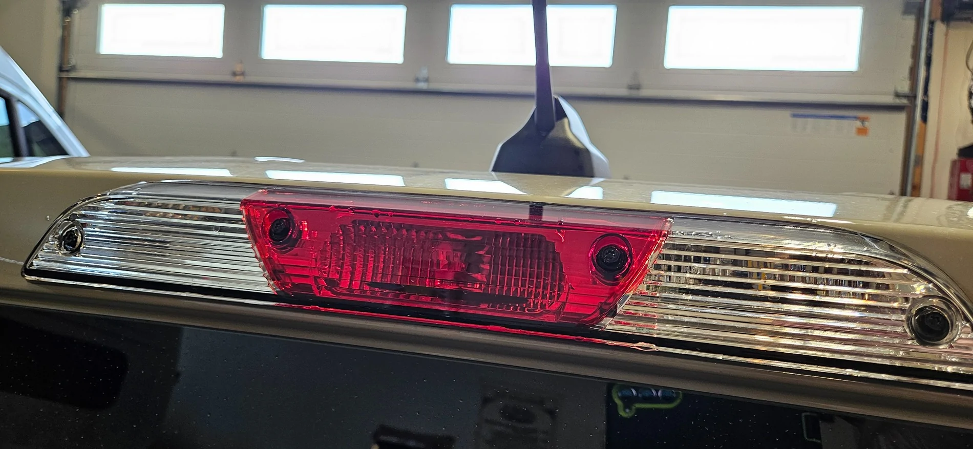

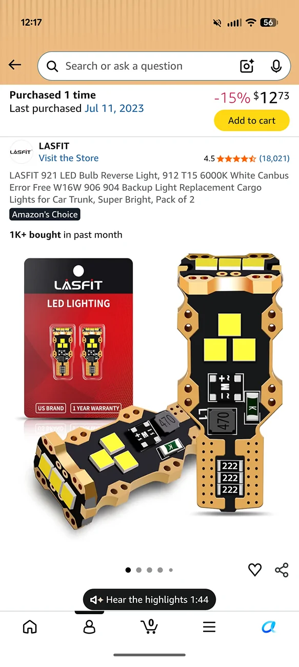

So I see you can use the Diode Dynamics cargo light LED for the 3rd brake light. Any other decent brands out there?
I've had good luck with Sylvania LED bulbs in the past, and they're super easy to find.
bighap
Aug 27, 2021
762
1,351
Oregon
2023 Maverick Lariat Hybrid
I must have gotten lucky with Lasfit. I purchased mine in July of 2023. They weren't installed until November 2023 when I got my truck. Still going strong.

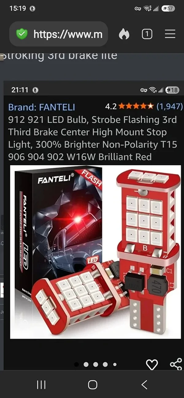

I used the strobing several times Fanteli light only for the 3rd brake light. No problems after over a year of being installed for all my lights, though my LED signal lights do make my turn indicator inside the cab hyper click...the exterior signal lights flash at their normal speed.
