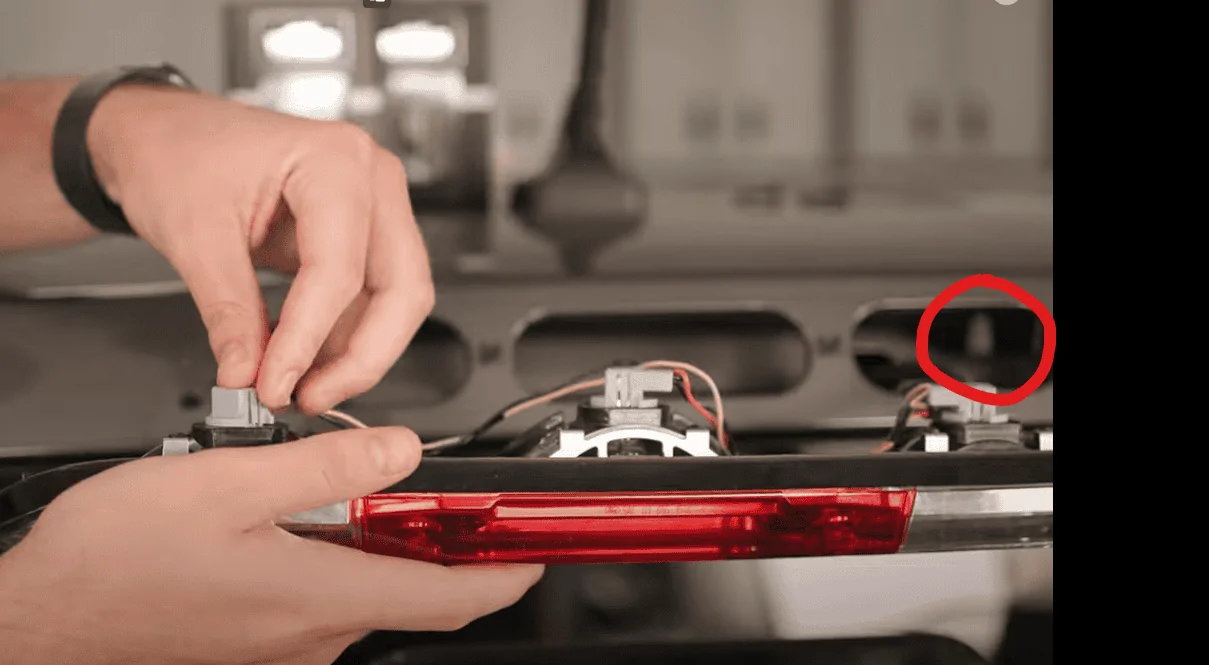

Yea the plug actually goes deep into the truck so you have to remove an annoying as hell clip (circled in this picture) then you can pull the flex tube enough to find the plug, although it will only come out a little so it can be annoying to plug in as well.
Thanks, I still want to swap, but I'd have to reorder. Did you have to pull the headliner inside the cab. Looks nice!
Nope! Once I got that clip out I had access to the plug from the outside so no need for tripping the headliner. Thank ya!

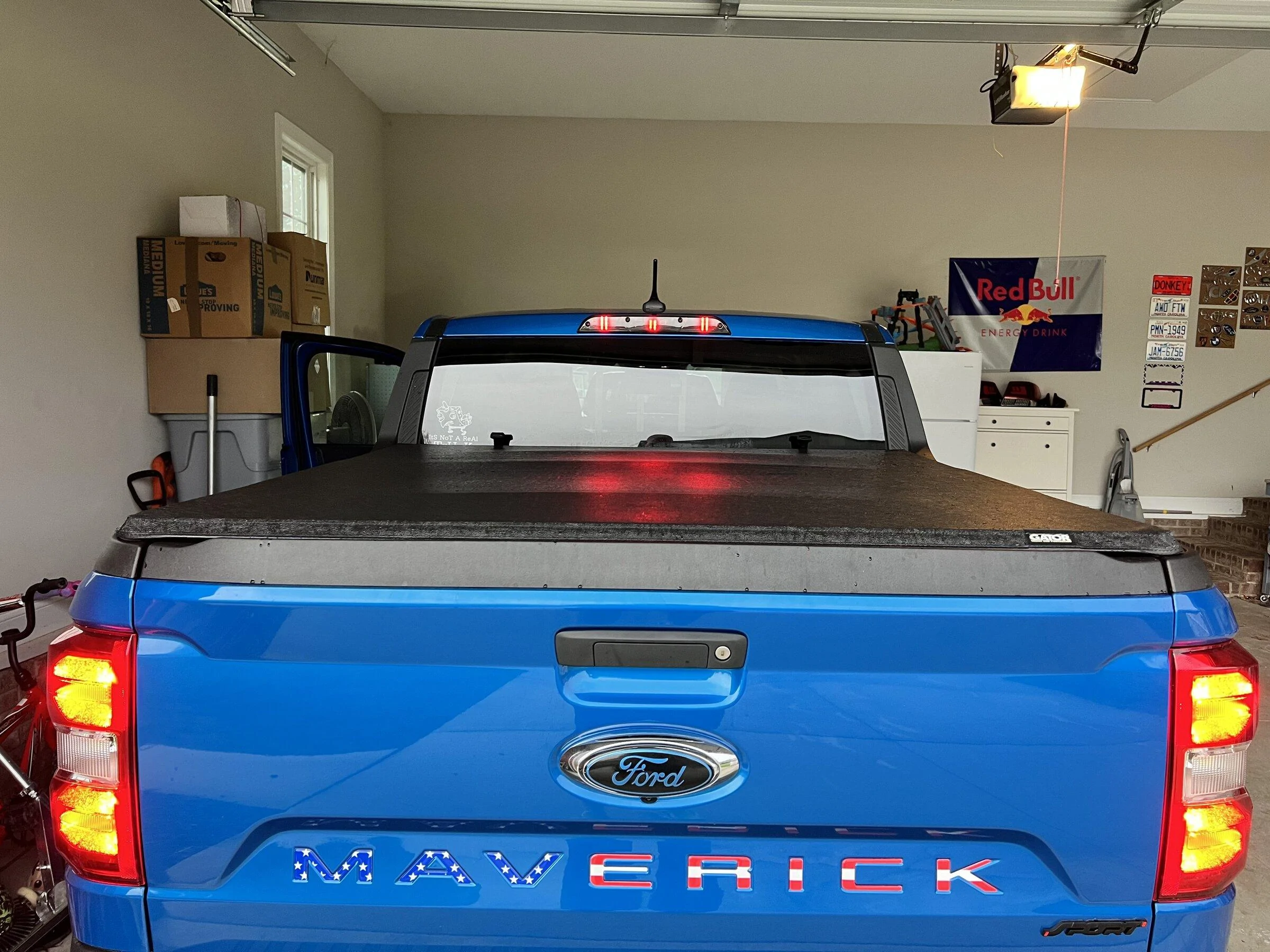

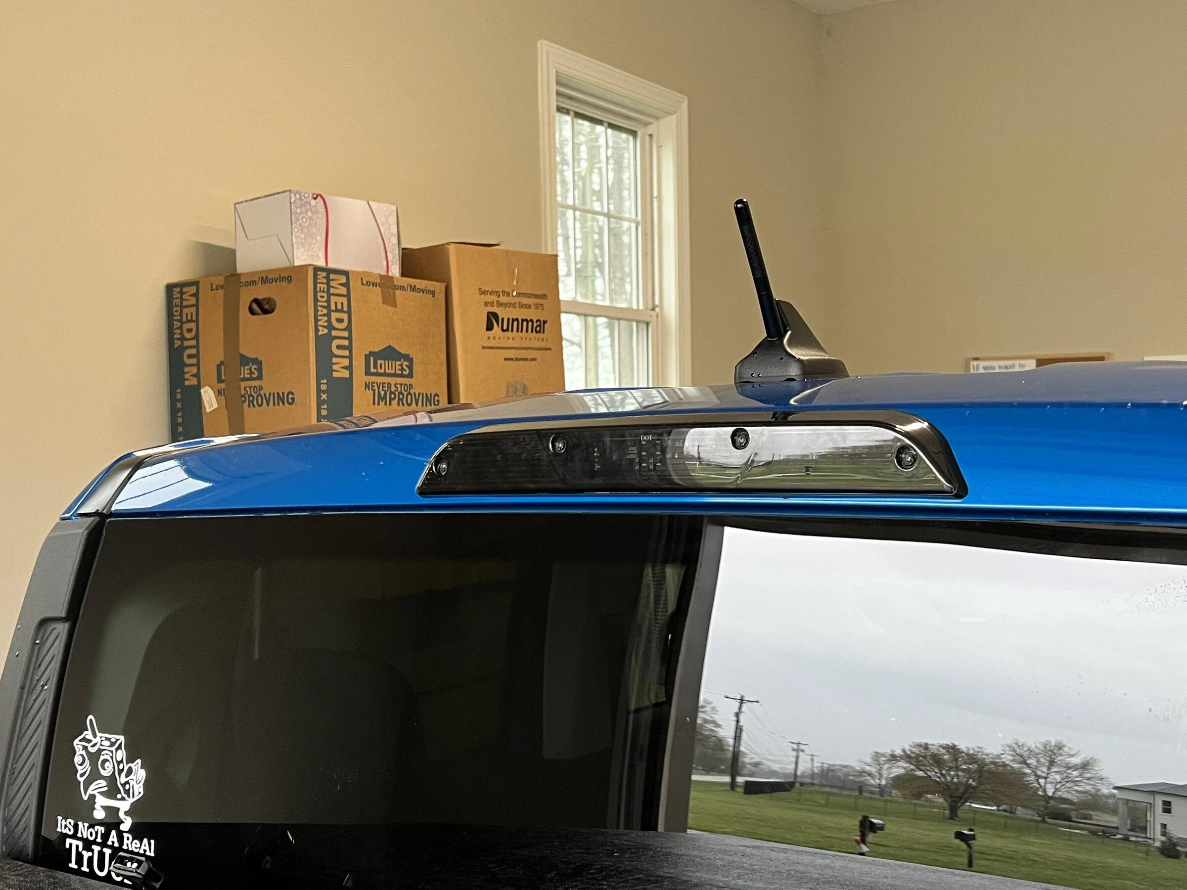

Swapped to this today…wanted the “three dot” look from the raptor!
Where did you get the spongebob sticker, I NEED IT
