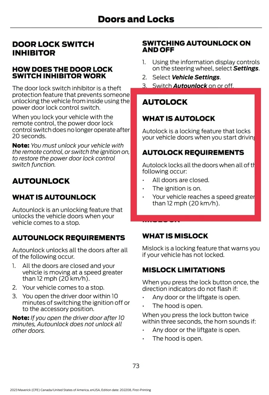

The doors automatically lock at 12 MPH as indicated in the owners manual.

It's working as designed

Normal/standard for most vehicles these days. Some if not all GM products do that as soon as you put it in drive.
