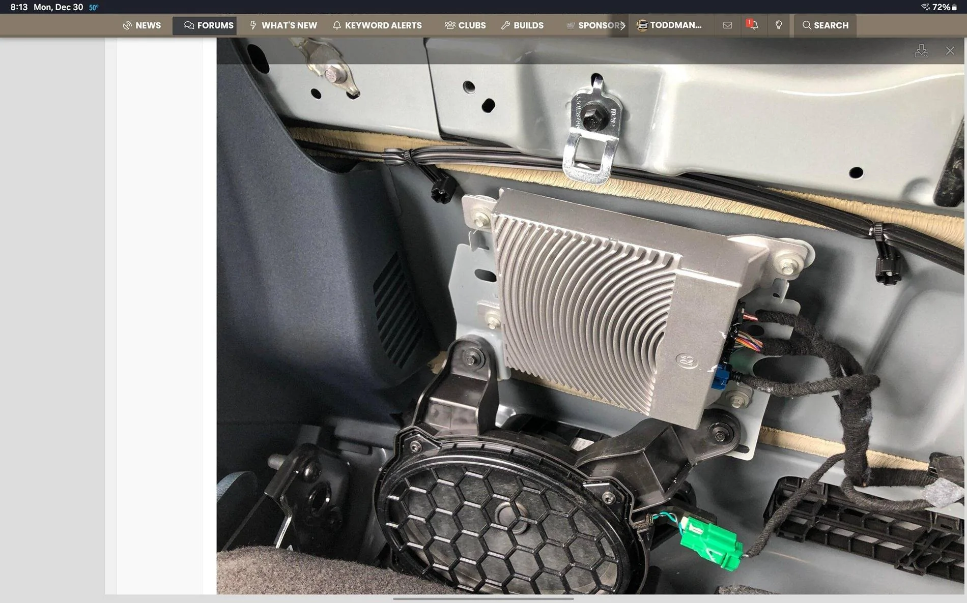

Hey guys! I drove a 24 lariat today, and I gotta say, the speakers sounded really good to me! Even the little woofer had more kick than I imagined it would. And after getting hands on with it, I want to keep all my under seat space.
im going kicker hideaway behind bench route. That’s what I’m doing. The amp that is with the speaker on rear wall, is that just for the little woofer? Or is that an amp for all speakers? Need to find out if I need to remove that or leave it.
I ordered mine today. Fingers crossed I get it sooner than later
The amp on the rear passenger wall is for all 7 your speakers.
I figured as much, just wanted to double check. I’m sure there’s enough room to fit the hideaway in there somewhere on the wall. Can’t wait

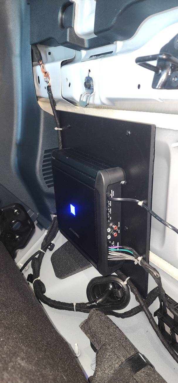

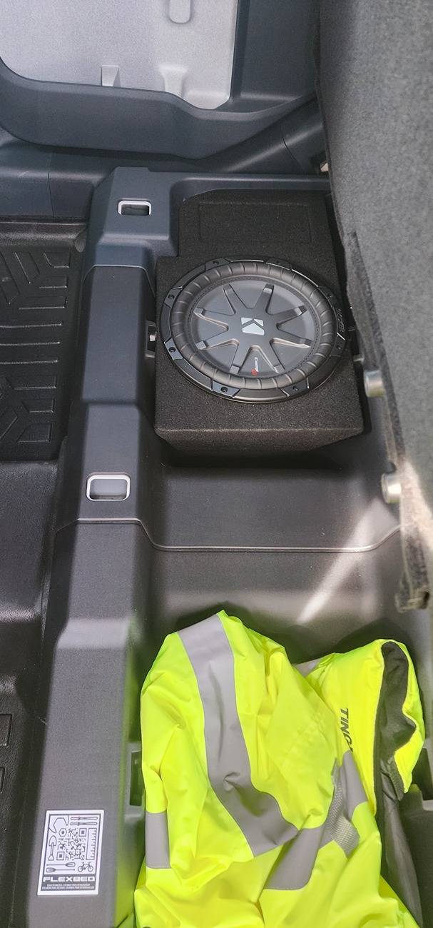

Honestly for the price of the kicker hideaway you'd be better off removing the b&o sub & tapping its wires for a signal and installing a sub under your driver side rear seat. A 8-in or 10 in shallow mount will hit three times harder than that kicker hideaway ever will.

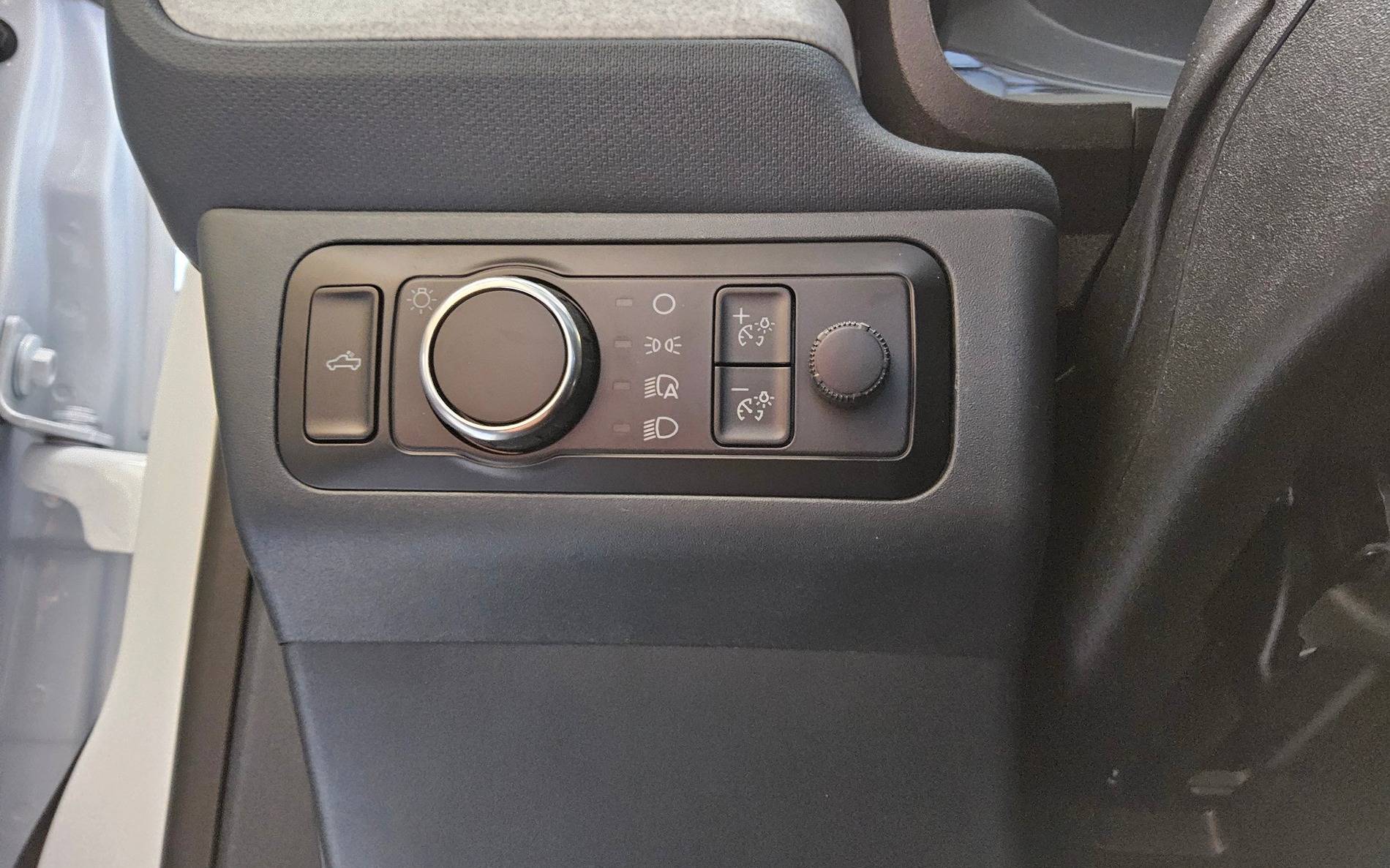

I have the EcoBoost so I installed my 10" sub box on the passenger side. My sub amp is where the b&o amp would be, since I have an XLT there was no b&o amp in the way. I installed my bass knob behind the headlight switch for convenience and aesthetics.
Hybrid only has half of that storage space, after seeing it and such, it’s valuable storage real estate

I saw a 25 Maverick yesterday and pulled the rear seat down, and saw this stuff (took off Google) the dsp is for all the system so I need to leave it, but would plop the sub and use its wires for hideaway
but is there enough room to put a hideaway back there w the stock amp? Maybe I can relocate it, pull off the mount and use Velcro stick it somewhere on wall. Make room for a hideaway

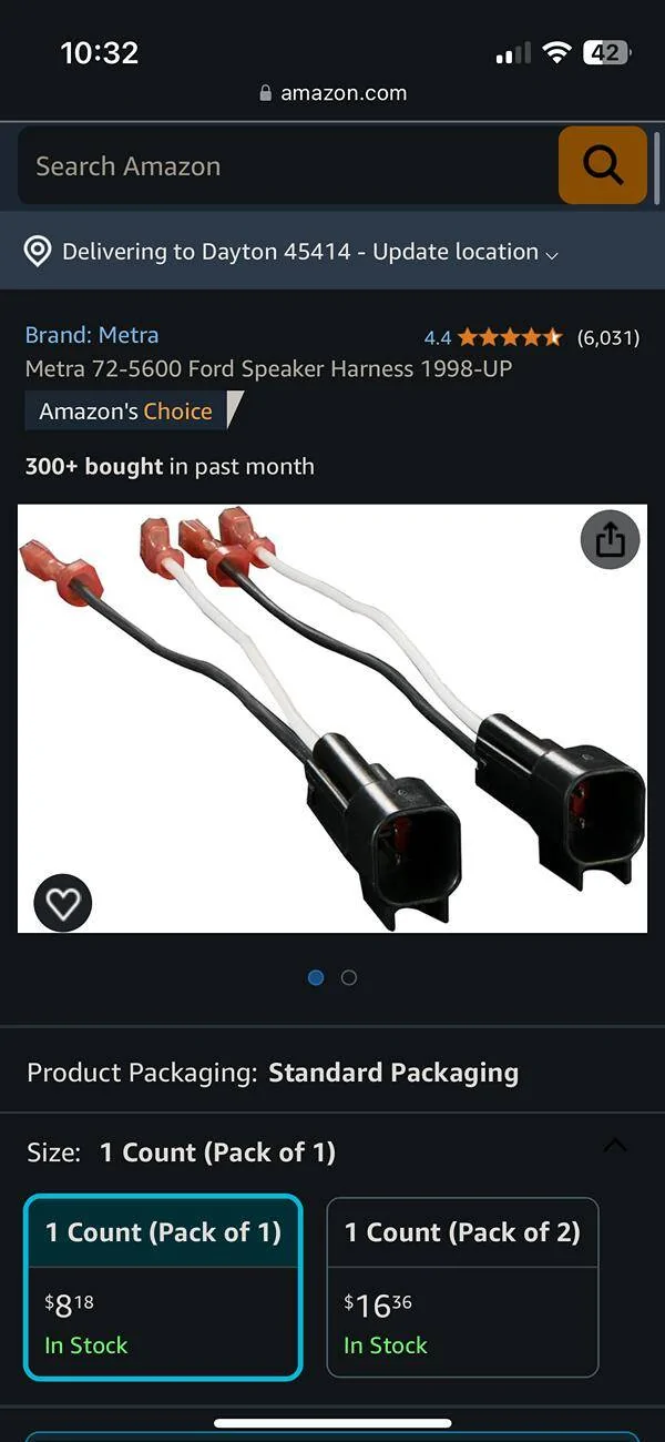

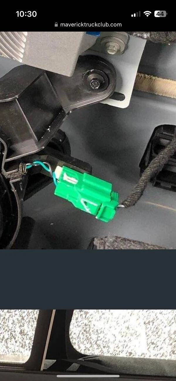

anyone happen to know what style female clip is on the sub? If I bought one for a buck or two I can make a factory quick connect into kicker incase needed to go back stock for sell or something—- it might be this
