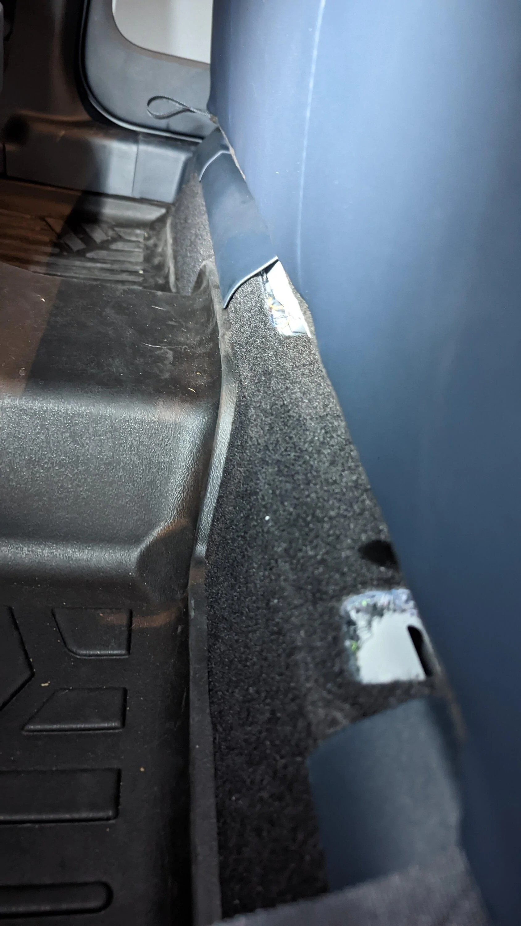

Exactly. I thought it would be harder to cut and I scored along the edge of the tape with a utility knife, thinking that I could easily follow the groove I made with the dremel. It turned out to be wasted time as it was harder - and less accurate - than just cutting along the tape with the dremel. Measure, tape, cut. I do think the dremel is a way better tool than trying to do this with a jigsaw. The material is thin and easy for a dremel cutting wheel.
Here's some more pics. It does not look pro, but it looks better to me than tub-less. If you want pro, there is a guy named Chris Hilbert selling boxes on FB that look super nice, they're $350ish plus shipping last I checked.
At any rate, it's cut this high because that is about the minimum to remove the FITS mounts. And those FITS mounts are one of the big things that limit the width of a box you can use here. That said, many people have made boxes small enough to fit in this tub without modifying it. The blue stuff is Amazon Basics sound deadener.

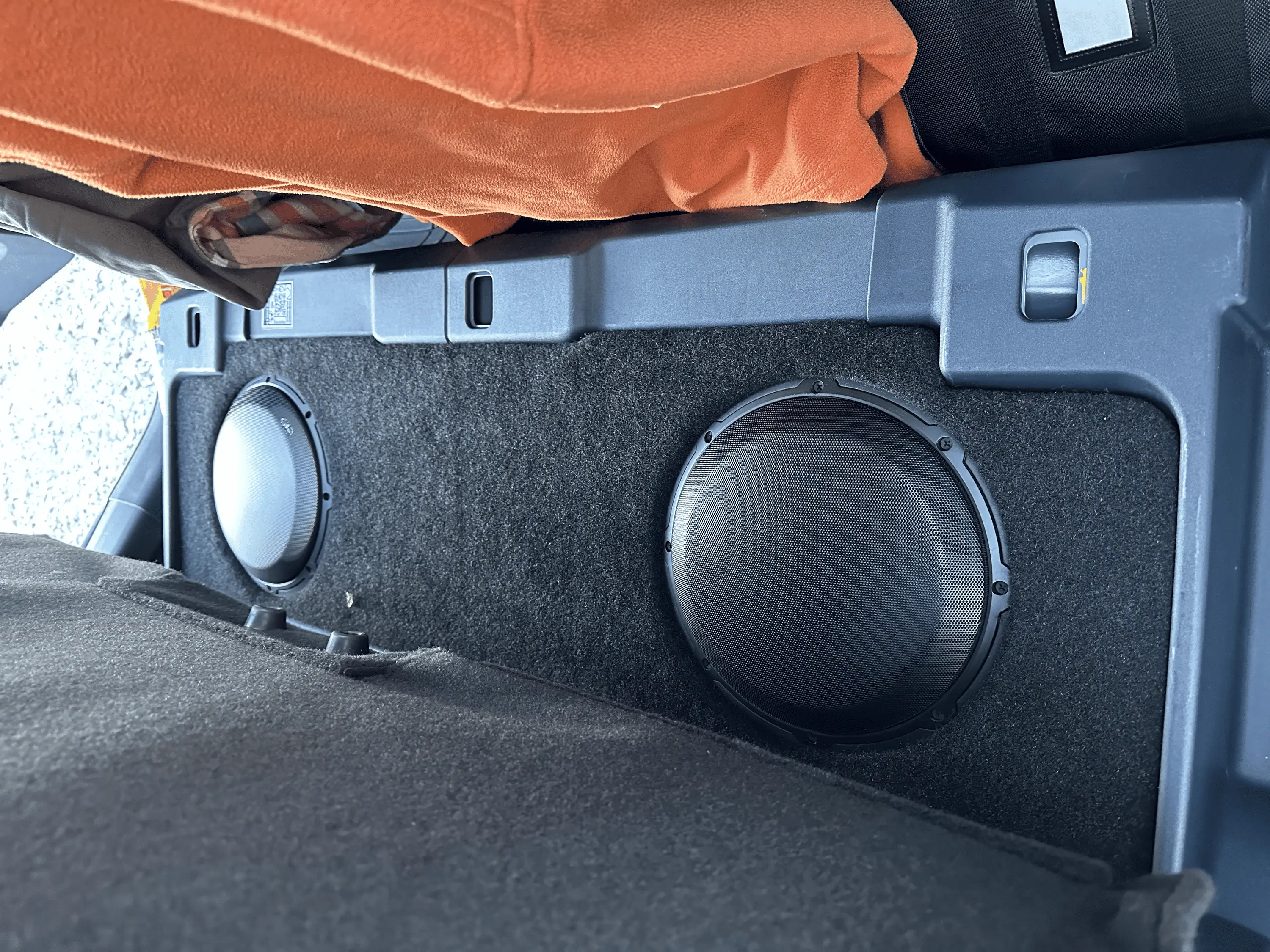

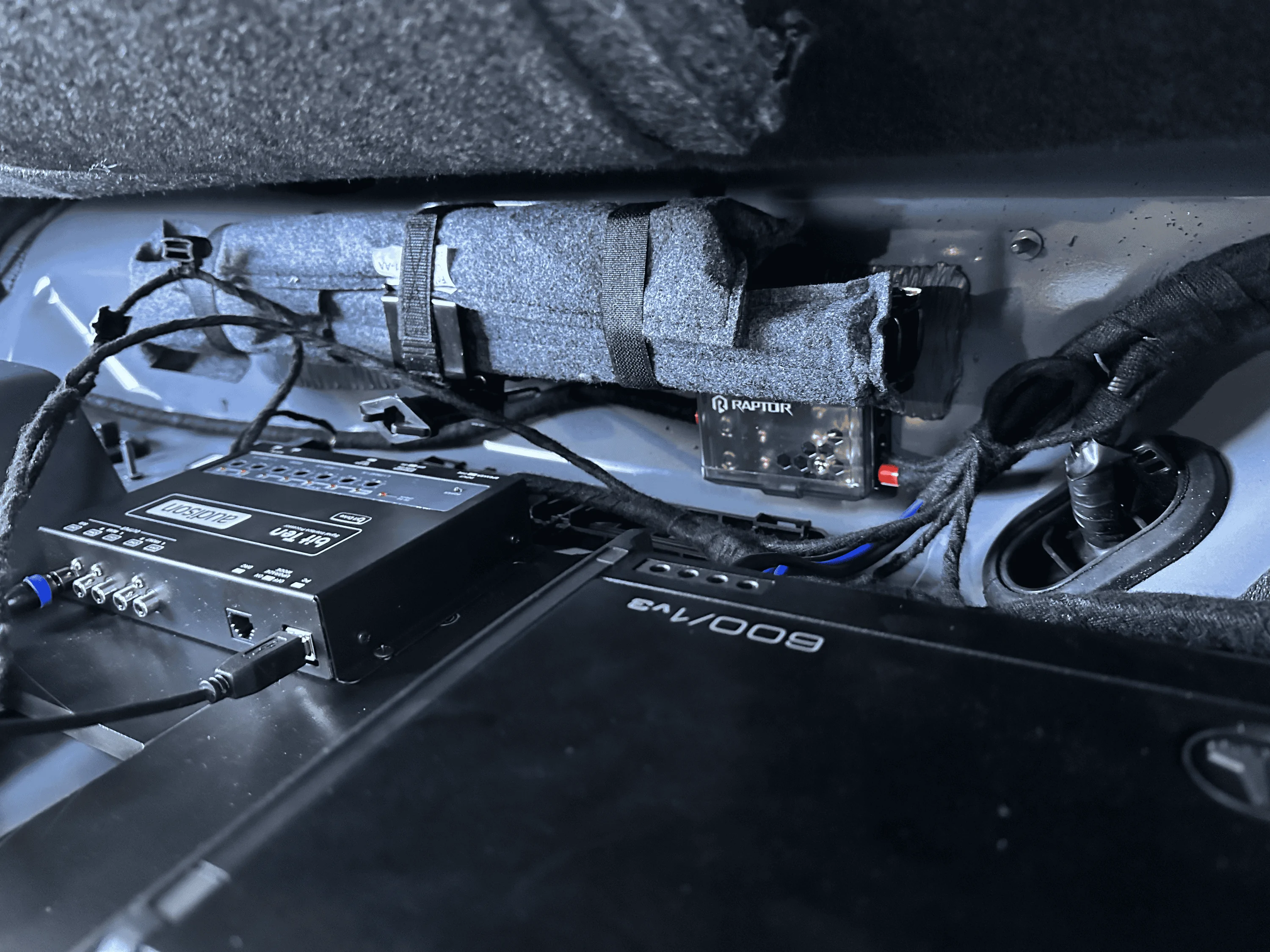

Got the box built last night and it fits great as expected... carpet is next. I'm in my 40s and I've had systems in a number of vehicles, all done by shops. This is literally the first box I've ever built. :oops:

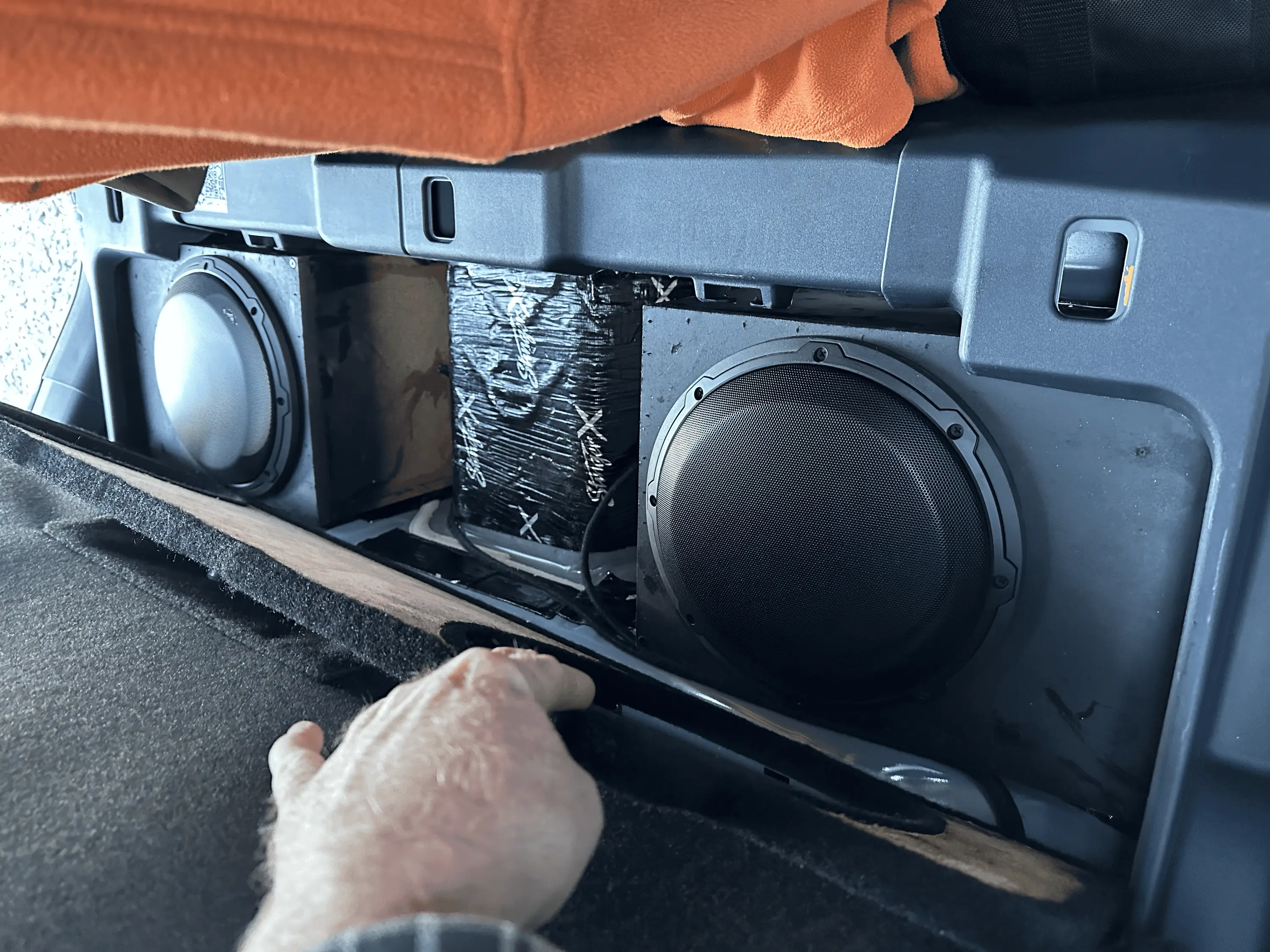

Got 2 (one on each side) 10" JL Audio 3v3s in MDF boxes with a JL Audio 600/1v3 600watt amp pushing them. Using an Audison bit 10 DSP which will help more when I swap out the doors & tweets later. But for now it's sound pretty amazing for only having quarter sized magnets in those 6.5 inch door speakers. I think a lot of that is due to the headhunt being pretty clean for factory.

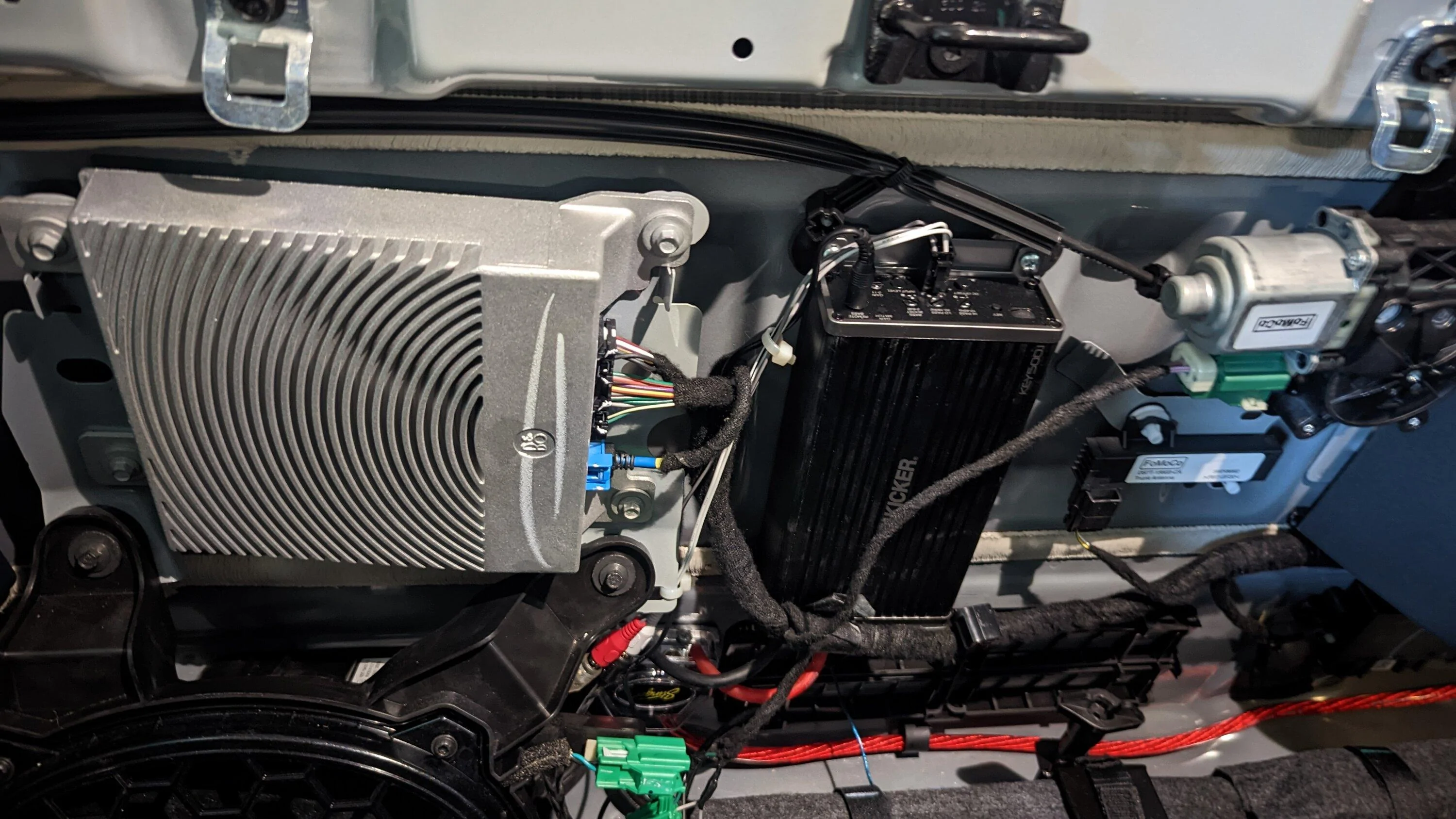

Nice! Your amp install is very clean, I probably should cable wrap mine. It's not necessarily messy, it just looks nicer with the black wrap.
did you also cut the plastic out?
assuming you are quoting the right message, a shop did that install.
looking at his pics, I can see the top portion of the plastic tub inserts, and I see the fits mount on the forward portion, but I see (painted) metal on the rear. they didn't cut it the same as I have done, but they did cut some of the plastic tub out.
it's pretty ugly under there but with the top overlay, it looks good.
the plastic is no big deal, but I recommend that you don't cut any metal for the bench rest if you're going to use the rear seat. the corner brace is a nuisance to work around for subwoofer enclosures, but it's also bearing a lot of weight.

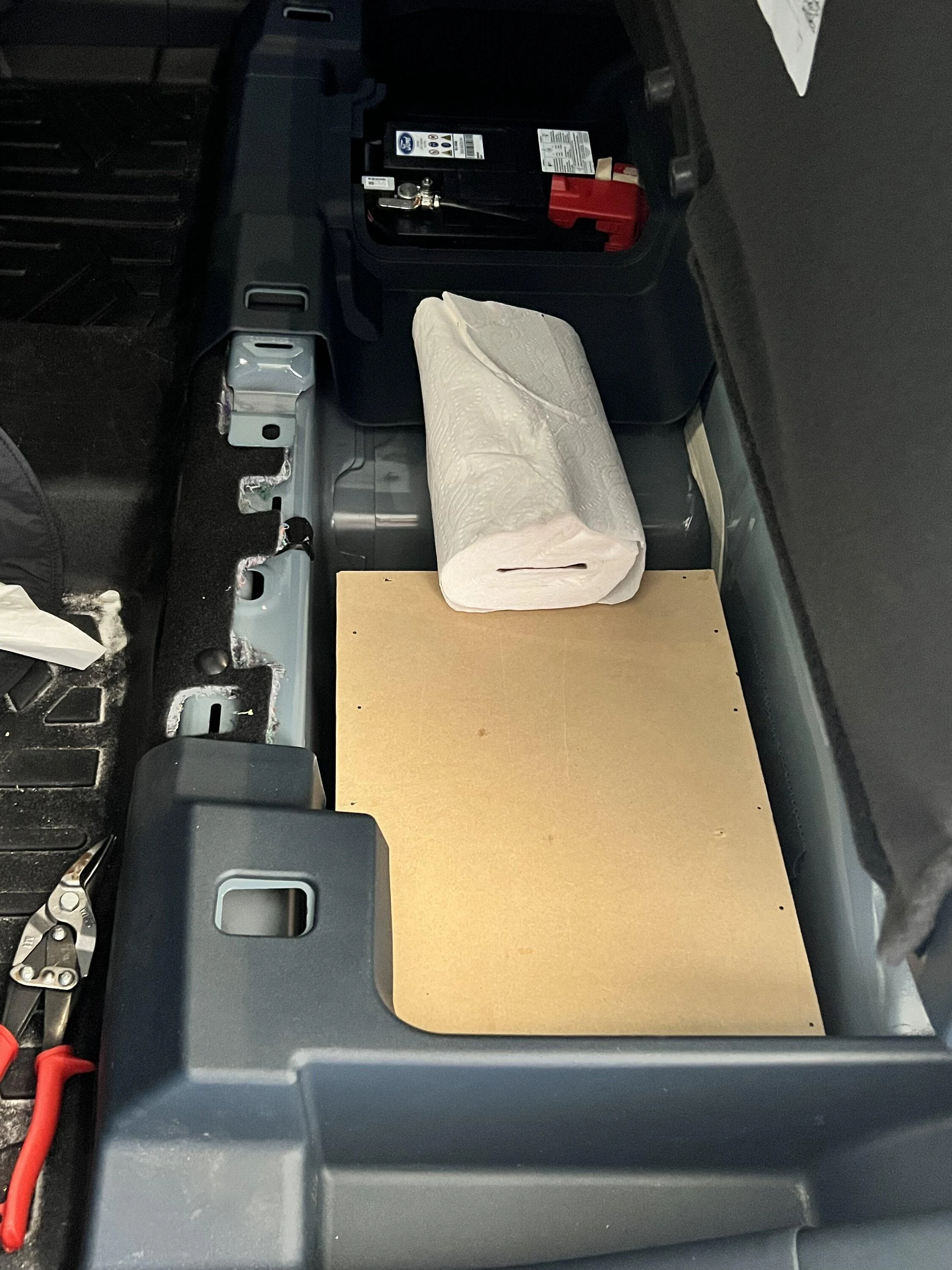

just built a 15x10.5x6.5 and it fits perfectly. Easy in and easy out but tight enough I can jam foam around it hold it in place.
Sub comes tomorrow which is when I will cut out the hole for it and the wires. I plan on mounting my amp where the paper towel roll is likely with industrial Velcro which has served me well in the past.

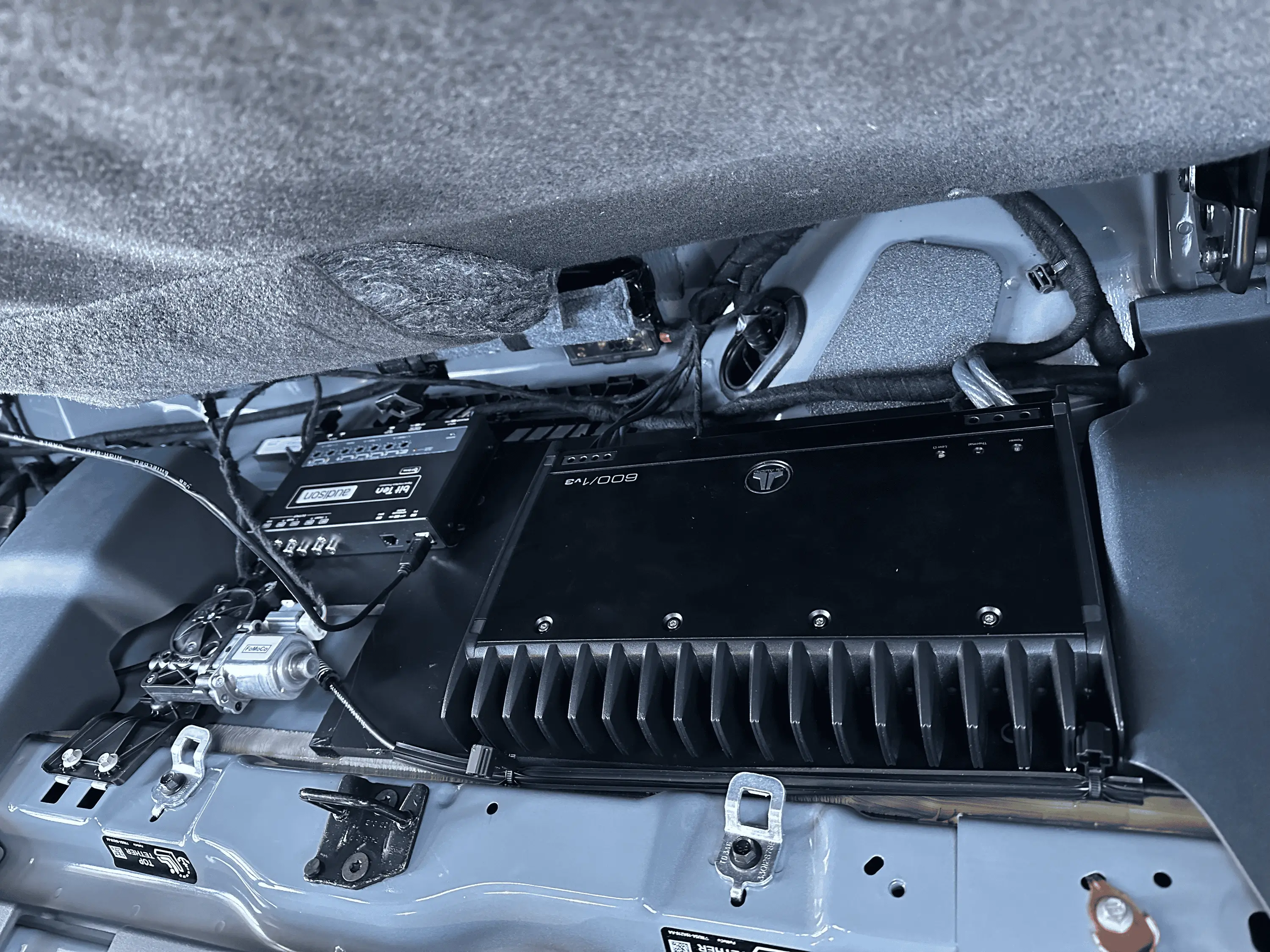

Just wanted to know what you mounted your amp to? I have the same amp I plan on putting in my Maverick but not really sure how to mount it.
Jb welded footnuts to the back wall of the cabin. In hindsight I would've mounted it on a plastic cutting board instead, or plywood.
