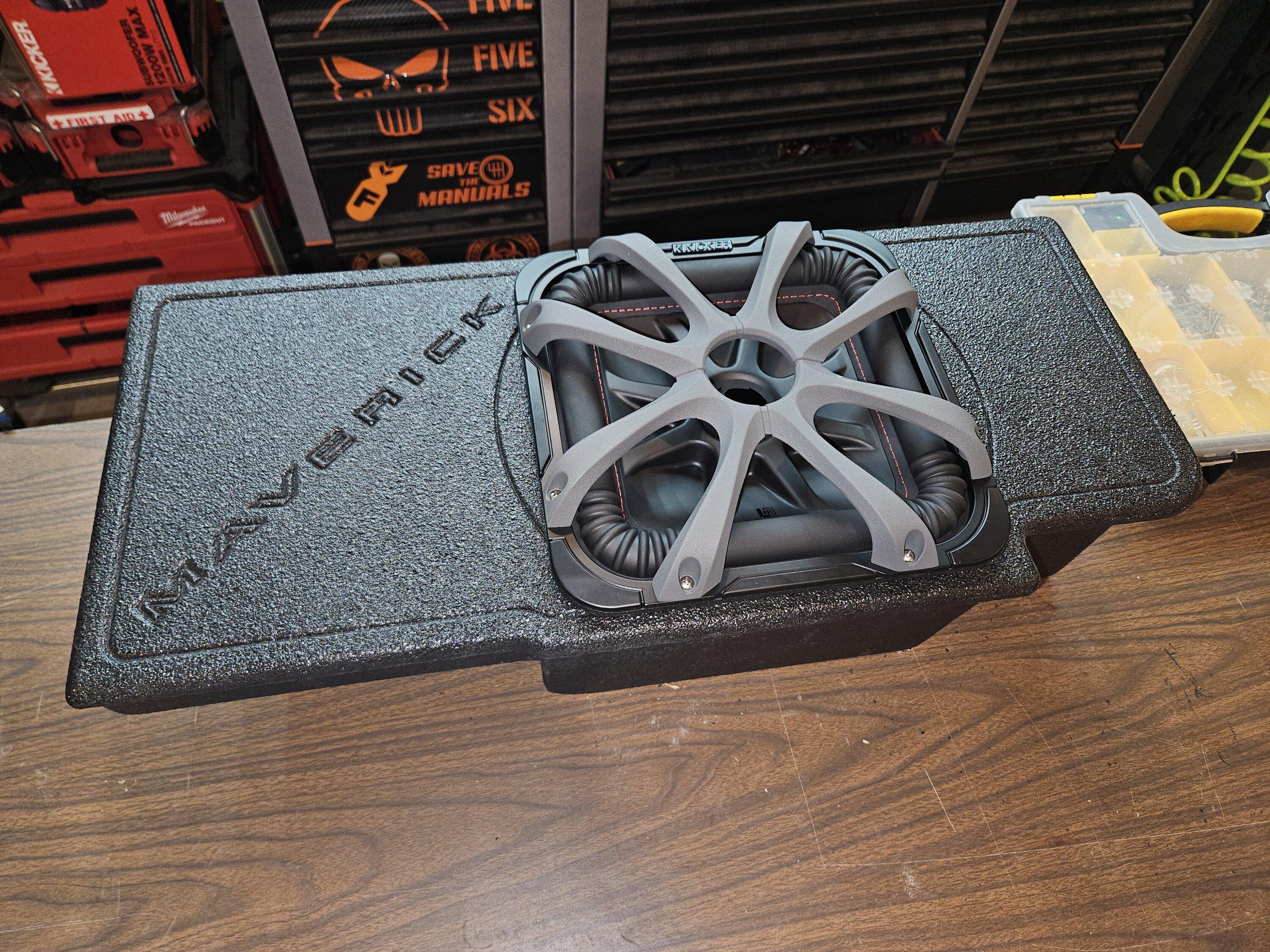

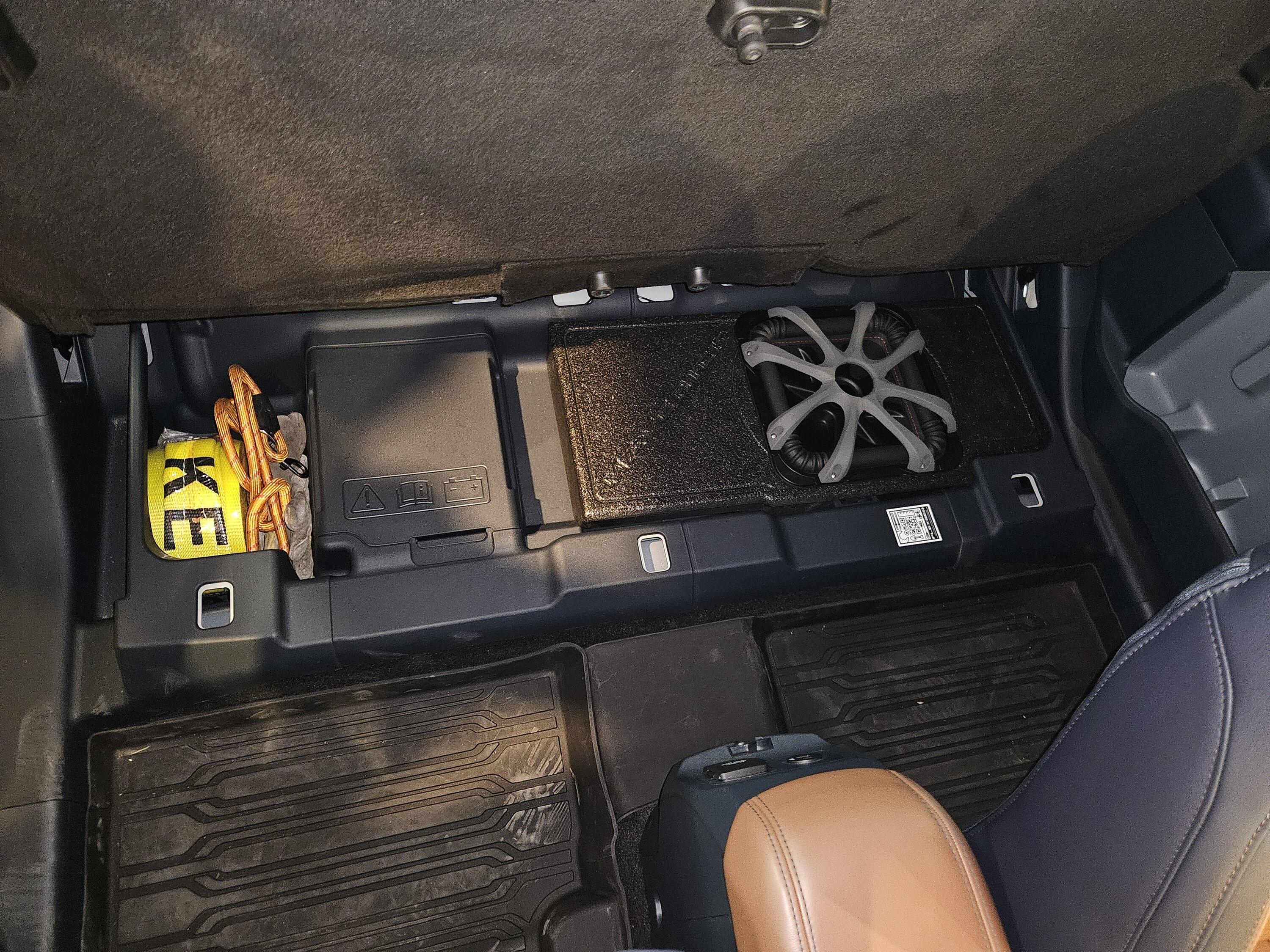

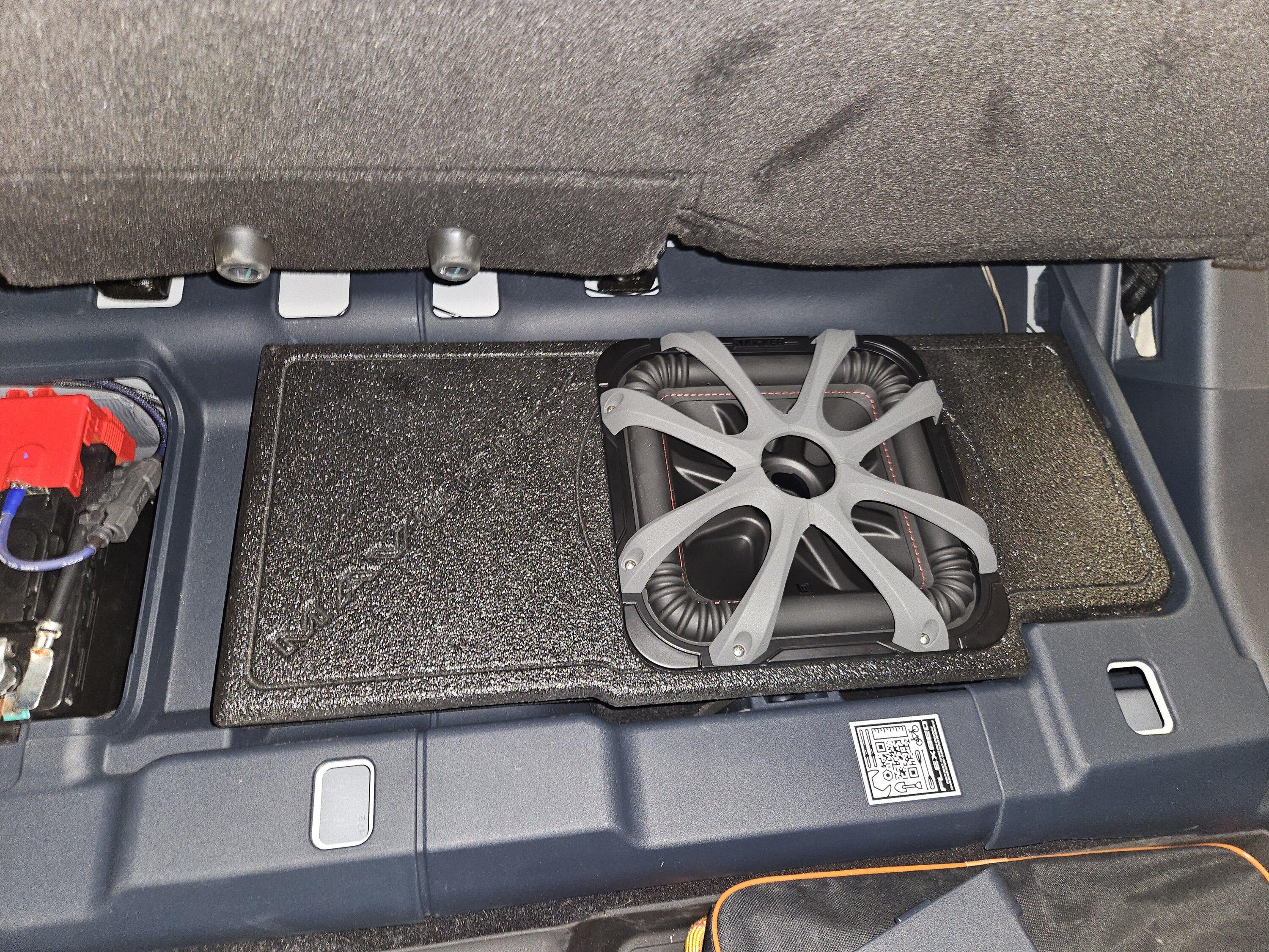

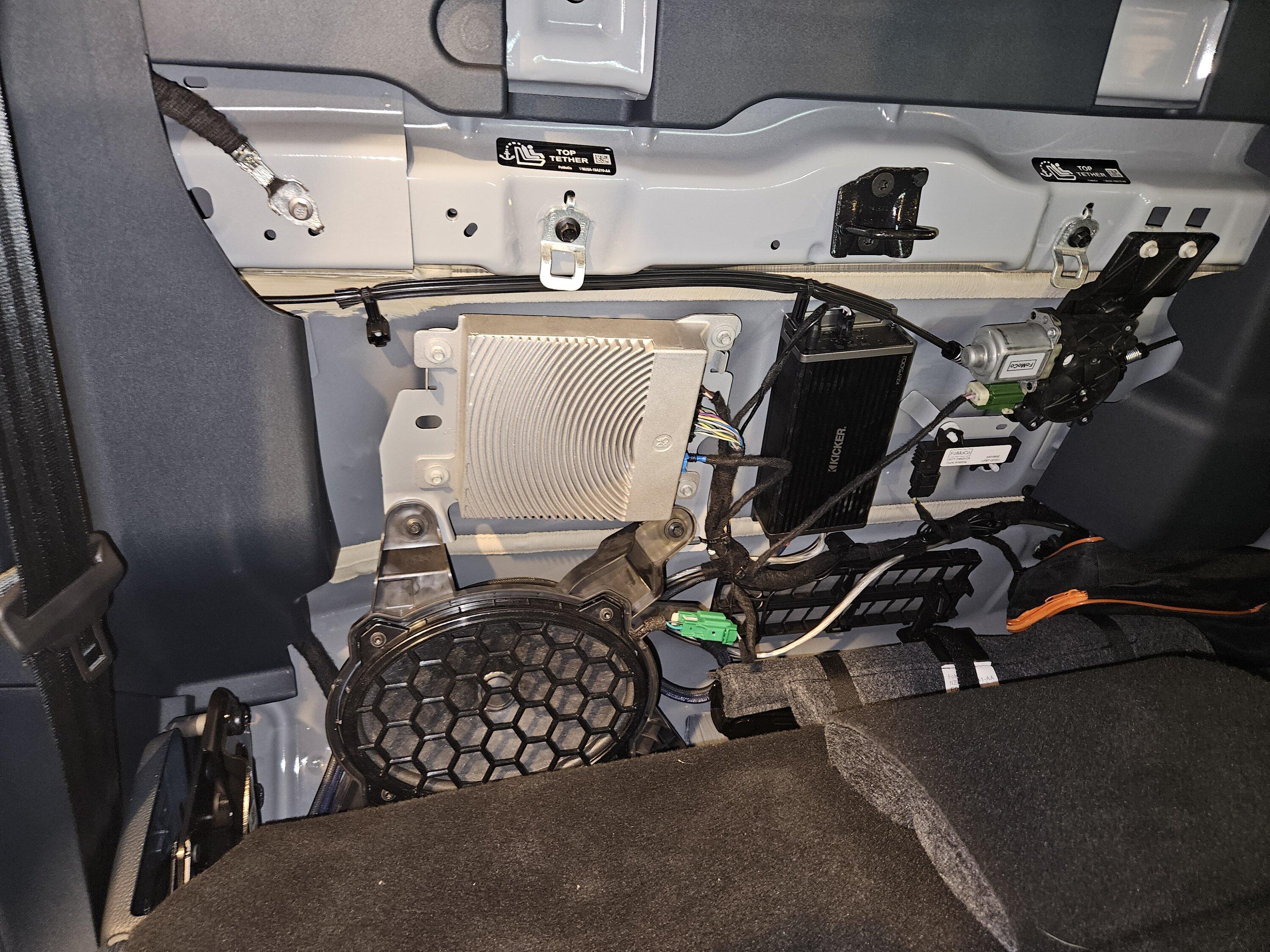

Installed a Kicker L7R 10” with a Kicker Key 500.1 last night.

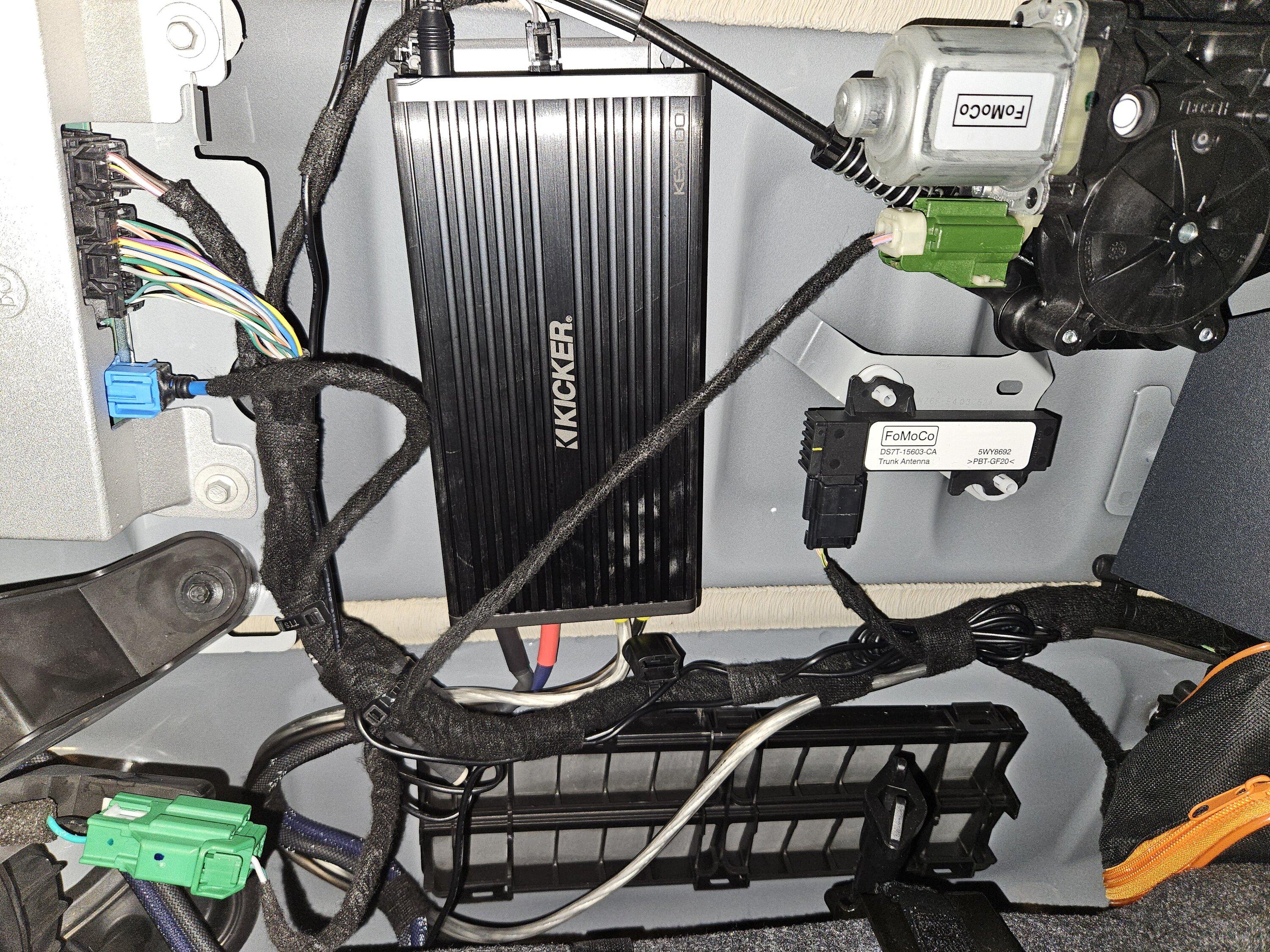

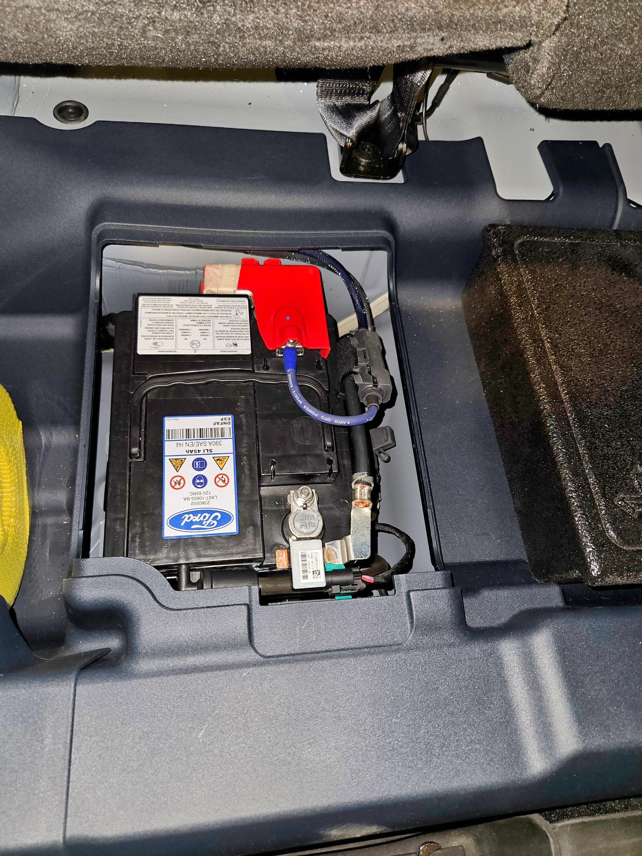

install was pretty straight forward. I used a 6” powersports amp kit and hooked up power and ground right at the battery. I used high level inputs of the key to utilize signal sensing (no need to run a remote wire).

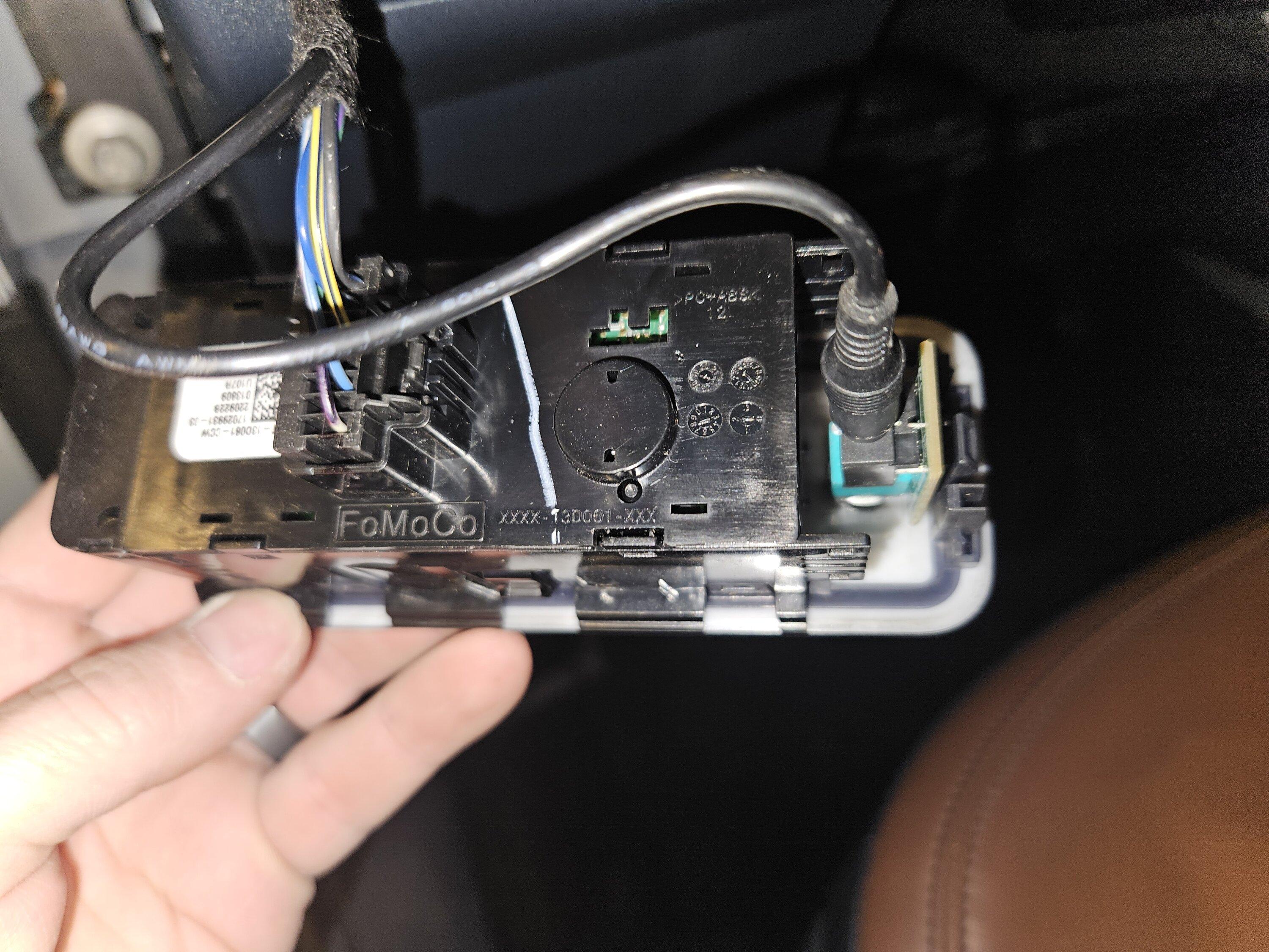

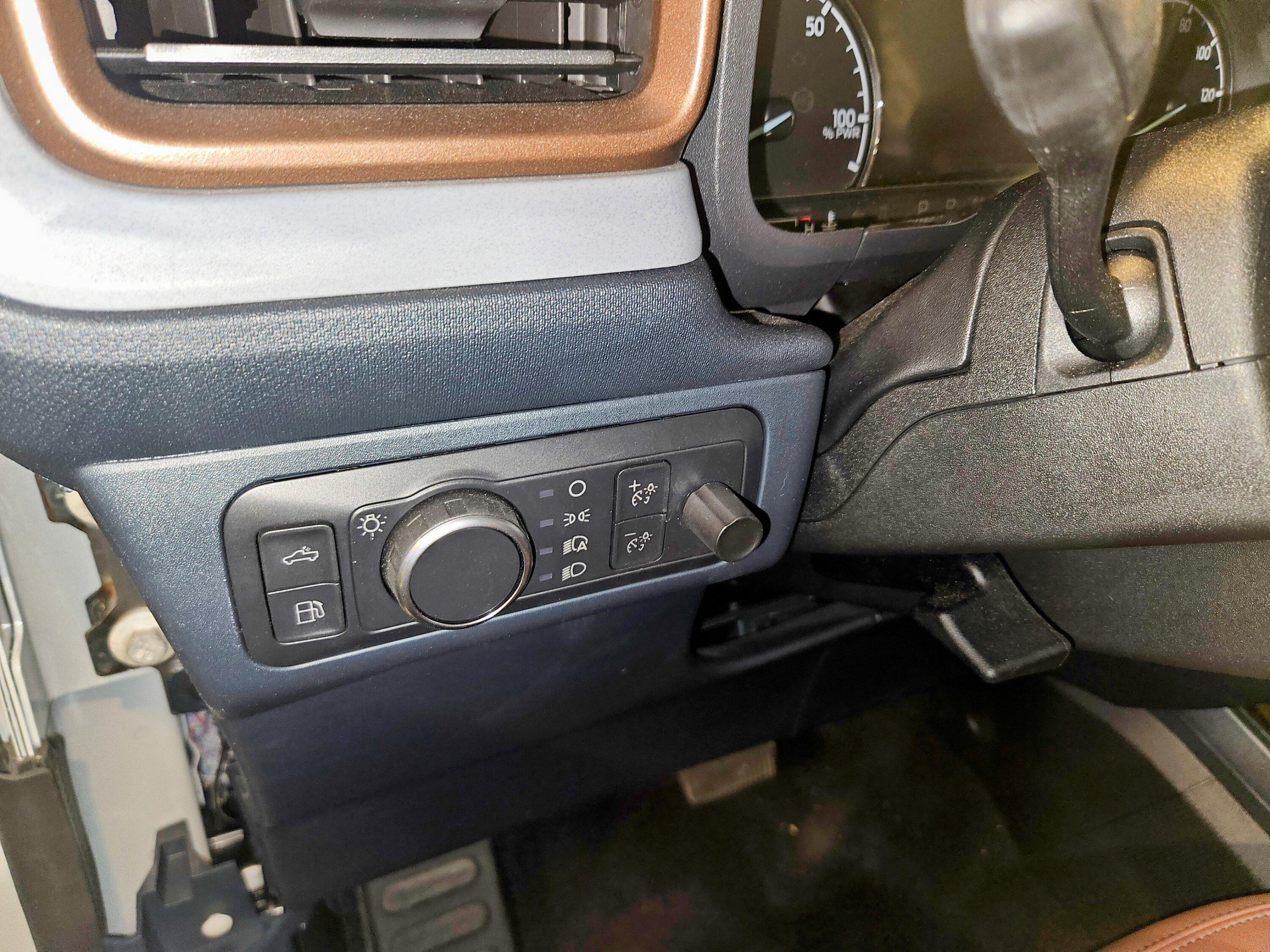

I removed the light switch and mounted the bass knob in the black space. It’s a good location and doesn’t look out of place.
I spend a good amount of time playing with amp settings but ended up using my own vs the auto tune ones.
When mounting the amp to the back wall I used two existing bolts and just elongated 2 mounting holes on the key. I used some aggressive double sided tape on the back side as well and it’s super solid.
Special thanks to Chris at Sound Decisions. After the transaction I had my box in 2 days. High quality and made this install easy.
Does that speaker grille allow seat to close all the way? I have the ground shaker boxes with the L7T 10" and was debating whether to get the grilles.
seat sits all the way down and latches

Where are you running the amp ground to behind the seat? Just wondering if there's an existing ground bolt that people are using.

Kicker 45L7R102Solo-Baric L7R Series 10" subwoofer with dual 2-ohm voice coil.
that's a great sub, but you might have some difficulty making an enclosure large enough for even the minimum sealed volume (.66ft3) and even moreso large enough for the ideal sealed volume (1.0ft3).

But you left the 6x9 in there? You crazy? 😭
lol. Pretty sure that thing is pointless now. I do wish they made a larger enclosure for it for a simple swap to a better one though. My testing with a SKAR 6x9 did not fit. You'd have to get a pretty underwhelming 6x9 to make that solution plug and playable.
I'm using the factory ground strap that the battery is grounded the chassis with. I believe it was a 13mm bolt. I used a powersports amp kit where it runs the ground and power wire together in loom.
