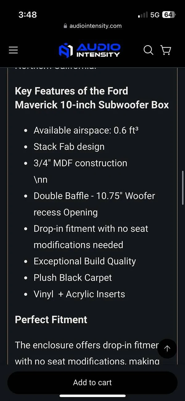

So do you think the proline box is too small? Airspace says there’s enough space, I can put some poly fill in there maybe to make up for it if slightly undersized- it also does fill the void between the 2 spaces
https://audiointensity.com/products...WKFsV-RsVXBosmNVdklDxKWSMf3zVWza7LLjYZ7oCRP3a
that box is basically the same as the sound decisions box. it should work ok, slightly undersized.

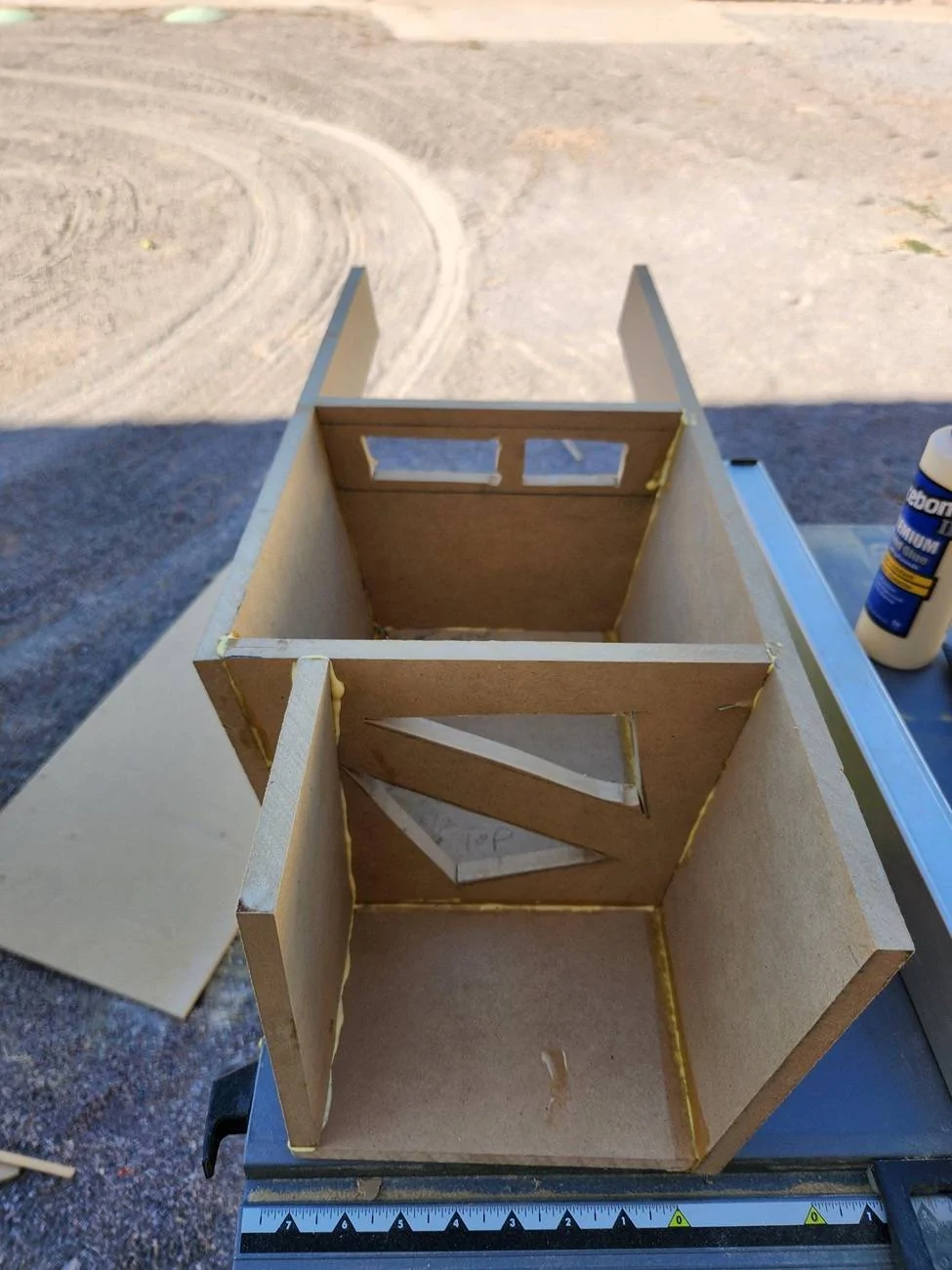

I wonder if it’s like the sound decision box, I looked up sound decision box and it has some structure inside taking up air space
all my JL stealth boxes never had internal supports like this
If one had no supports and other one did, I’d pick one without for more airspace personally

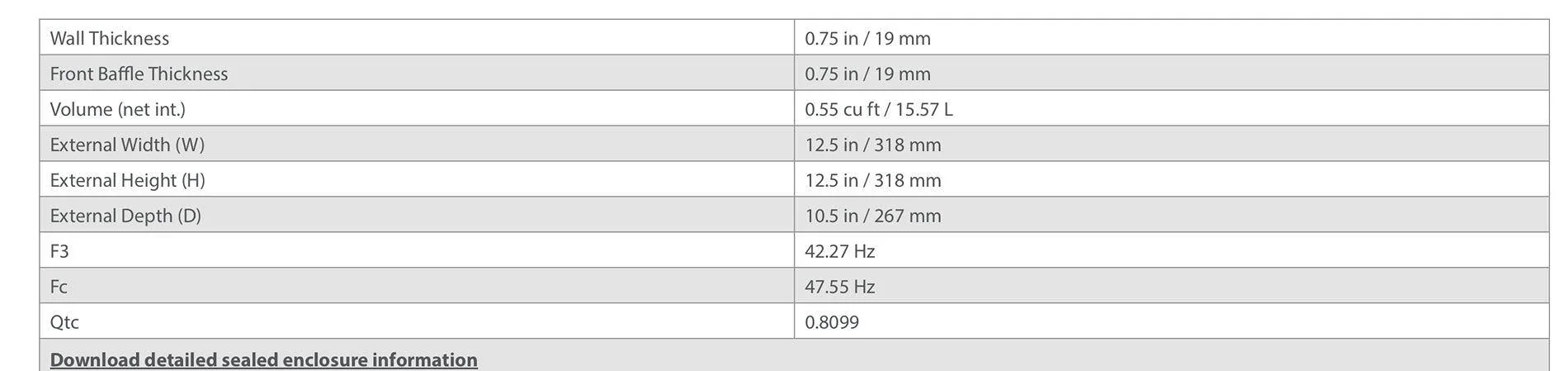

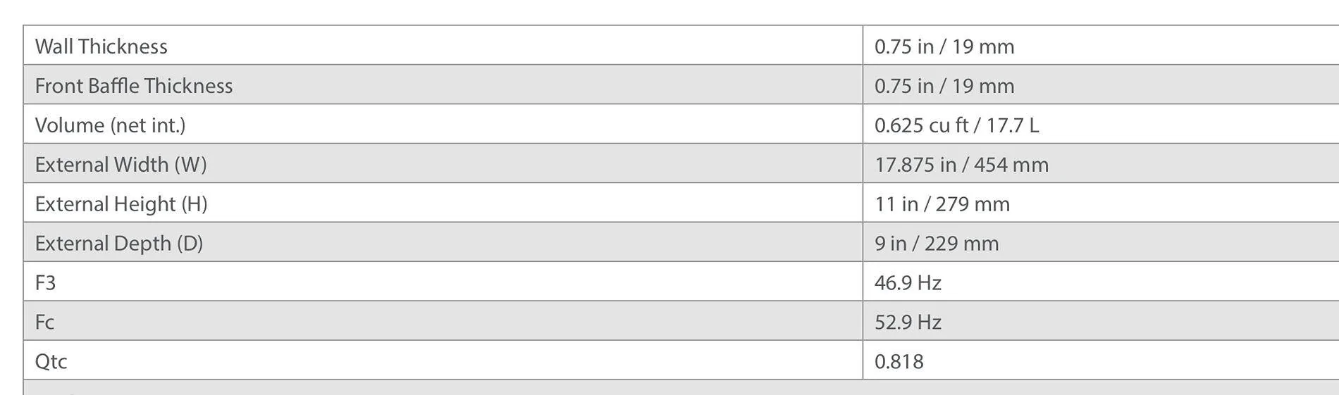

if doesn't work, I could break the bank, and toss a 10w6v3, its .55 vs .625 for the w3. or just go to a tw3 or something else entirely. I know that I really enjoy my 10w3v3, so I bet the 10w6v3 is insane too.
the JD500 would fit perfectly for powering it as well. (it'll power anything I need in the vehicle regardless) its a good amp to me.
