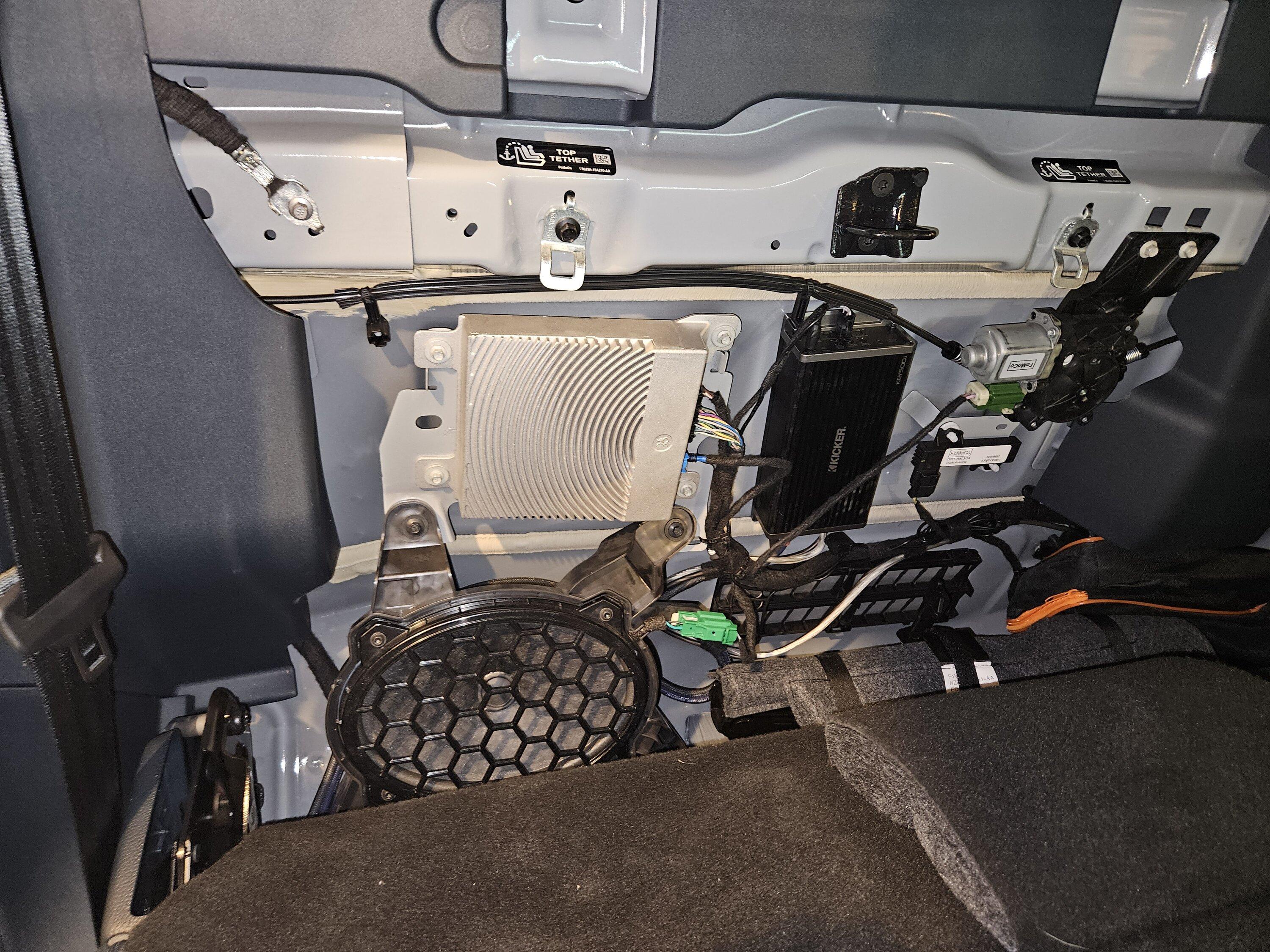

Where are you running the amp ground to behind the seat? Just wondering if there's an existing ground bolt that people are using.
In the OP's pic below ..in the upper left ... there is a cable bundle going to a ground.
That is factory .. so i figured it would be safe for amp install too. I used that. No issues.

Installed a Kicker L7R 10” with a Kicker Key 500.1 last night.
install was pretty straight forward. I used a 6” powersports amp kit and hooked up power and ground right at the battery. I used high level inputs of the key to utilize signal sensing (no need to run a remote wire).
I removed the light switch and mounted the bass knob in the black space. It’s a good location and doesn’t look out of place.
I spend a good amount of time playing with amp settings but ended up using my own vs the auto tune ones.
When mounting the amp to the back wall I used two existing bolts and just elongated 2 mounting holes on the key. I used some aggressive double sided tape on the back side as well and it’s super solid.
Special thanks to Chris at Sound Decisions. After the transaction I had my box in 2 days. High quality and made this install easy.
And sound ....how does it sound?
All the bass you want/need without rattles?
I got the Key500.1 also ...but not the bass knob ... i may end up ordering one.
Nice work/setup on yours.
Plenty of bass for me. I’ve had all sorts of subwoofers and installed hundreds of them and for the 550 dollars it sounds really good. Bass knob is key and the spot I found looks like it was made for it.
The only rattle I get is from the cab vent.
