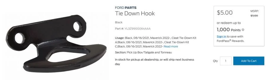

Just finished adding the extra tie downs in the back. Instead of buying the cheaper 4-pack on Amazon (I only needed 2), I just ordered a pair of OEM ones for $5 a piece from parts.ford.com -
Ford Maverick Adding Bed Tie-Downs to 2025 XL -- DIY Instructions Writeup tiedown

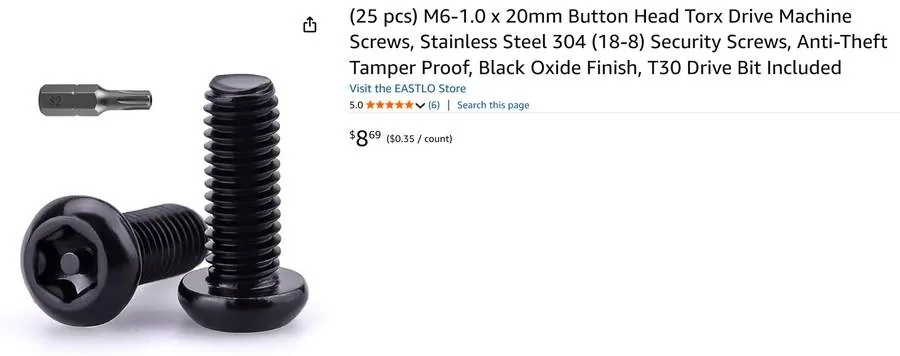

and instead of using allen-head screws, I bought a 25-pack of Torx screws on Amazon that look pretty much just like the factory screws, but with a glossier finish instead of the zinc/flat black of the OEM (plus, 2 of my OEM screws had the heads partially stripped from the factory). The only downside of the Torx screws is the company (EASTLO) on Amazon takes about a month to ship them (I'm sure they're coming from China, so there's gonna be a delay)
Ford Maverick Adding Bed Tie-Downs to 2025 XL -- DIY Instructions Writeup torx
I replaced all the factory tie-down screws with these, and they look and work great. Just thought I'd let others know an alternative to the Amazon tie-downs and bolt/screws in the original post - but the original ones listed above by MavMeister25 will work just as good. It's just a matter of preference. I didn't need 4 tie-downs, and I wanted Torx head screws so I switched it up. Thanks again to MavMeister25 for the excellent instructions and tips.
