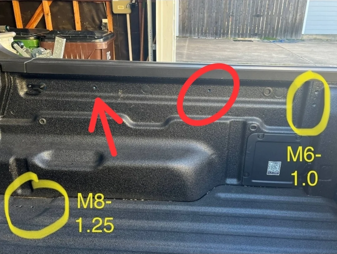

The base XL only comes with 4 tie-downs. I added 4 more. I used an aftermarket tie-down on the side wall rear at the TOP similar to the one already installed by Ford. For the ones on the FLOOR towards the front I used a flip anchor ring. I’ll leave a link to all these parts below.
You’ll need a tap wrench with bits that can cut M6-1.0 and M8-1.25. See image attached for which one is which. I can confirm that my job was done 100% correctly and that I used M8-1.25 on the front end floor holes even though Ford says they are M6-1.0. Don’t listen to them. They’re flat-ass wrong.
You’ll also need 4 hex bolts that are 20mm long and match the M6-1.0 on side wall holes, as well as 4 hex bolts that are 20mm long and match the M8-1.25 floor holes.
Ford uses nylon or plastic washers on the side wall tie-downs between the tie-downs and the bed. Seems odd to me since washers typically go under the bolt. Anyway, I included ones that match the specs Ford used. I didn’t use any washers on the floor flip ring anchors.
One tip when tapping the threads is to use some oil. I used WD40. Im sure somebody will criticize that but it worked fine. Also make sure to be as straight as possible when cutting and go in reverse a little bit every time you make a full turn. Blow out the holes with compressed air afterwards to remove metal shavings. Wear goggles or close your eyes!
I didn’t put anything on the side walls where the optional rail goes on higher trims. Some people put in eye bolts but I don’t like that idea since they can turn easily when torque is applied and they’re not as stable. But those pre-tapped holes are M8-1.25 if you’re planning on adding something.
Good luck and enjoy your Maverick 🍻

What size for those holes, I got M8 and it feels tighten up more than suppose to be
Look red arrow

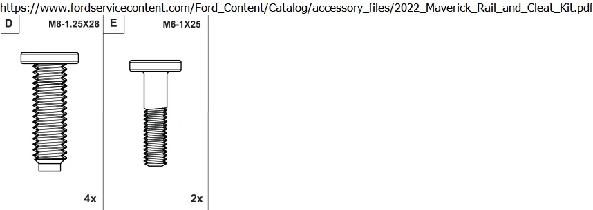

Might need to chase the threads in case spray-in material is on ford's rivnut threads.
I used M8 x 1.25 on those some of those.

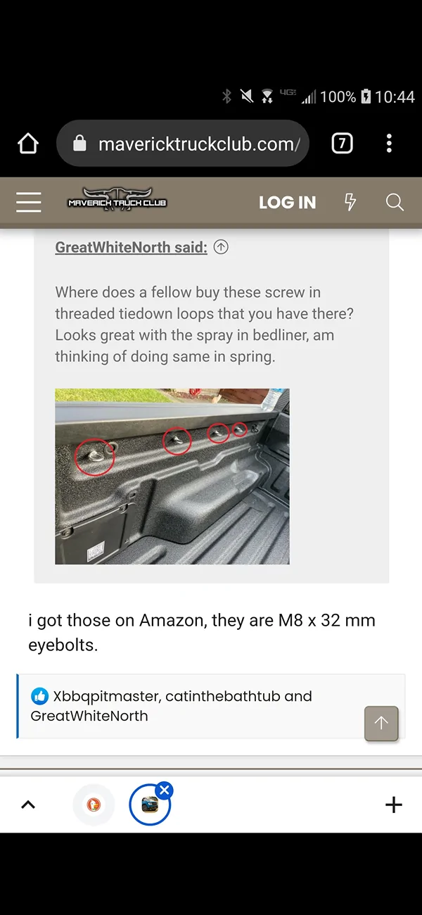

M8 means the diameter and 32mm means the length... right?
Yes.
I got these from Amazon long ago.
Have worked great; no issues.
I had the Line-X spray bed liner already, but no problem with over spray in holes.
Did have to get a wrench to help tighten down each one to completion. Lots of turning each one to make it flush.
https://www.amazon.com/Eowpower-5Pcs-Stainless-Steel-32mm/dp/B074K53HRB/ref=mp_s_a_1_3?crid=26FZFUWQIZP7O&s=industrial&sprefix=m8+x+32mm,industrial,224&sr=1-3

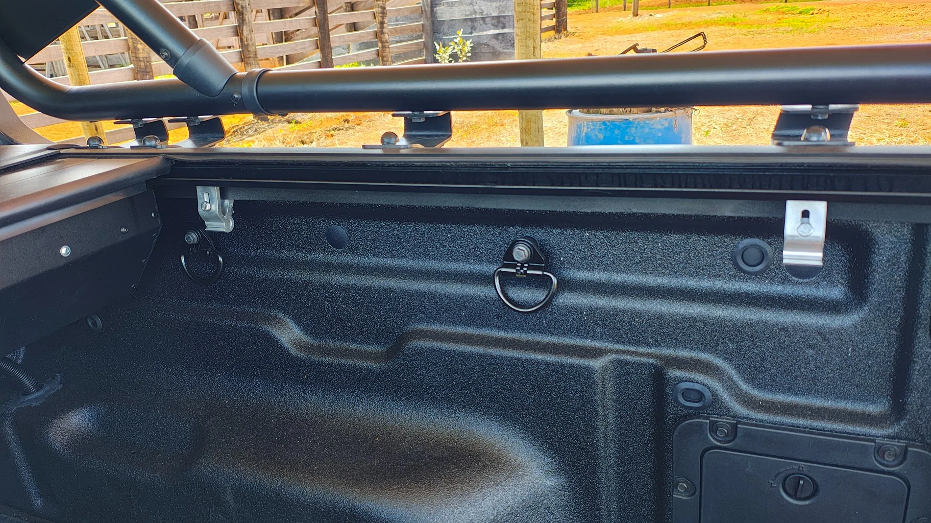

So ... I was looking ate this thread and decided to share what I did on my 2025 Tremor.
I choose to change the stock bed cover for the electric hard rolling bed cover, since I dont carry equipments that are big enouth to the estructure of the cover to get in the way.
But, with this decision, instaling a rail system lost his sence, so I decided to add some extra hooks to hold cargo...
Ended up getting some Ford Transit tie down hoocks ...
(https://www.amazon.com/REAXOAL-Compatible-2015-2023-BK21V550A74AD-V550A74-AD/dp/B0D7ZZP3TR)
it's a nice option, because they have this extension that make possible for them to swive and not bump into the cargo wall...

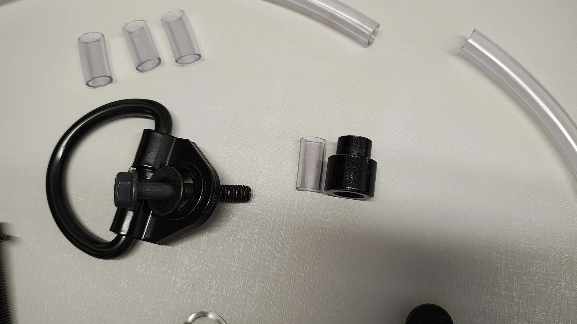

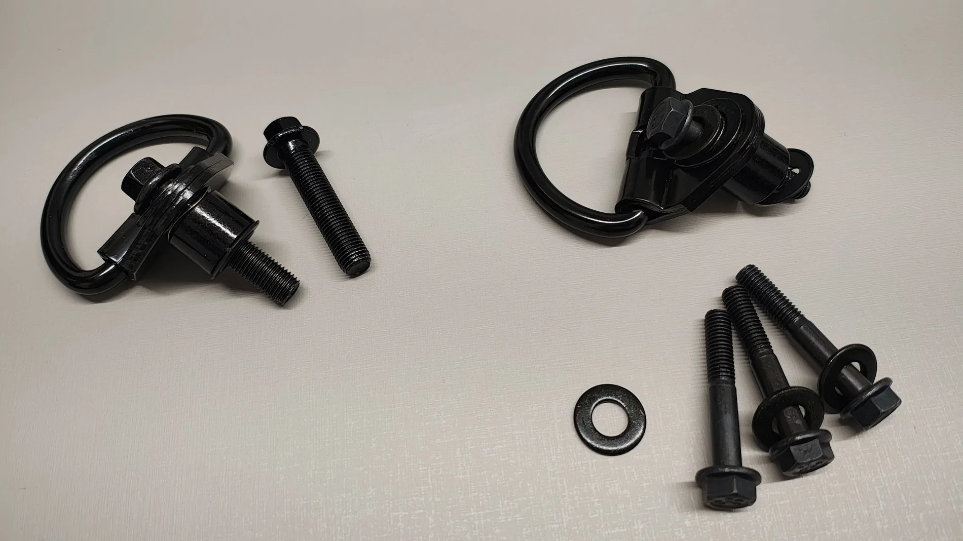

The hooks come with M10 bolts, só a got some M8 - 1,25 - 5,0 cm (02 in) with M10 washers and use a small crystal hose to fill the diference of space from the M10 to the M8 !
