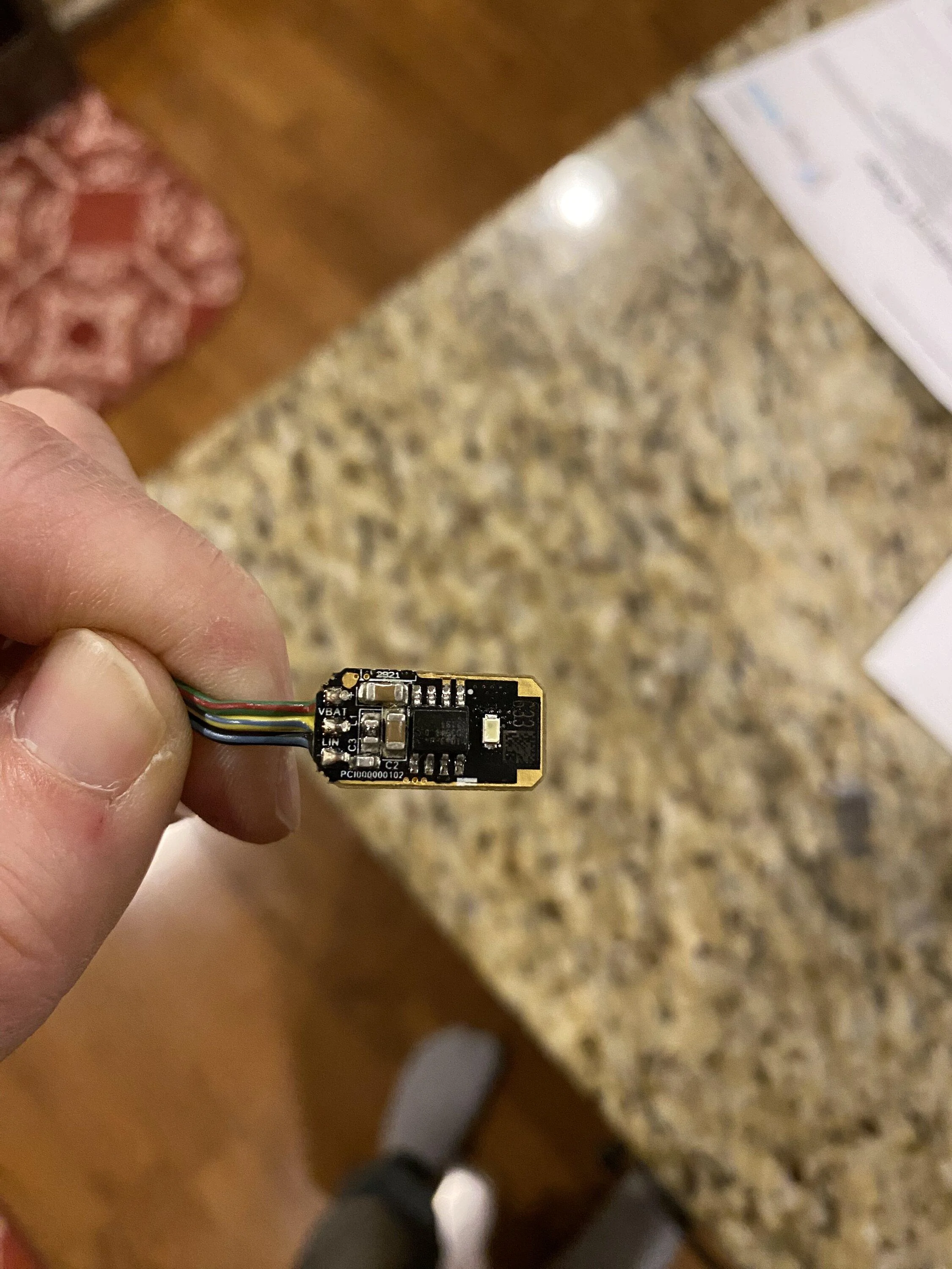

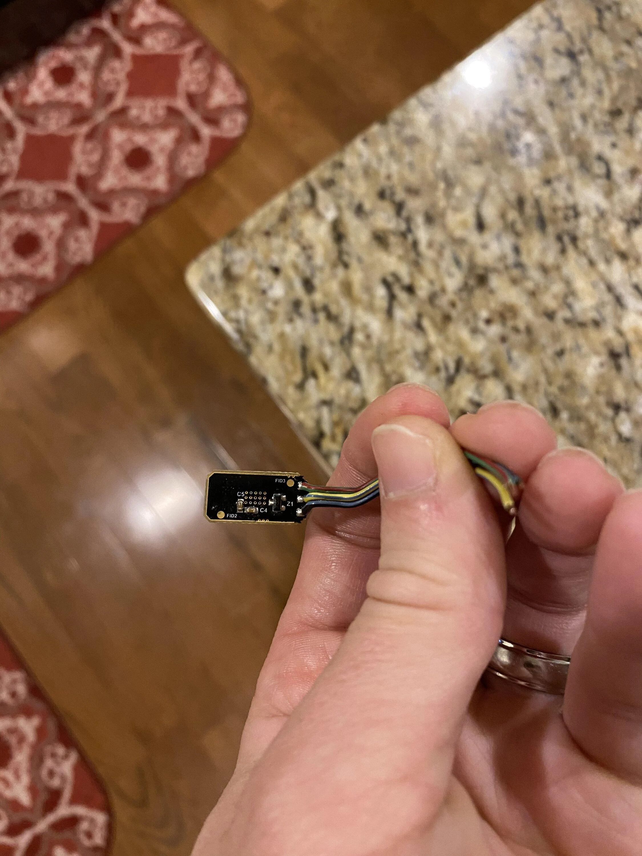

Bought the Ford ambient light assembly and hooked it up to a 9V battery and it did not work. Tried hooking it up to my 12V riding mower battery, also did not light up. There are 3 wires on the Ford LED, one is labeled VBAT, one is labeled LIN, and the last is unlabeled (assuming its ground). I think the LIN wire is some sort of communication link and perhaps it is required to be hooked up to run the light. The assembly is it’s own circuit board so there’s some other things going on there. If anyone might have a clue on how to power this light I can ship it to you to test it out.
Yes LIN is likely Local Interconnect Network, a control protocol used in vehicles. Would need to find and tap the corresponding wire for it.
Did you try applying power to both vbat and lin while grounding the last one (or some combination of that)? Without having someone with a 2022 and a multimeter actually test the wires, it's a crapshoot.
I tried every combination of the 3 wires and nothing worked. I ended up using the 12v mower battery and wiring directly to the LED and it lit up for a second then went out. Now it just dimly flickers white when I do that. Maybe I shorted it…
Yeah, especially if you didn't use a resistor. At least you tried!

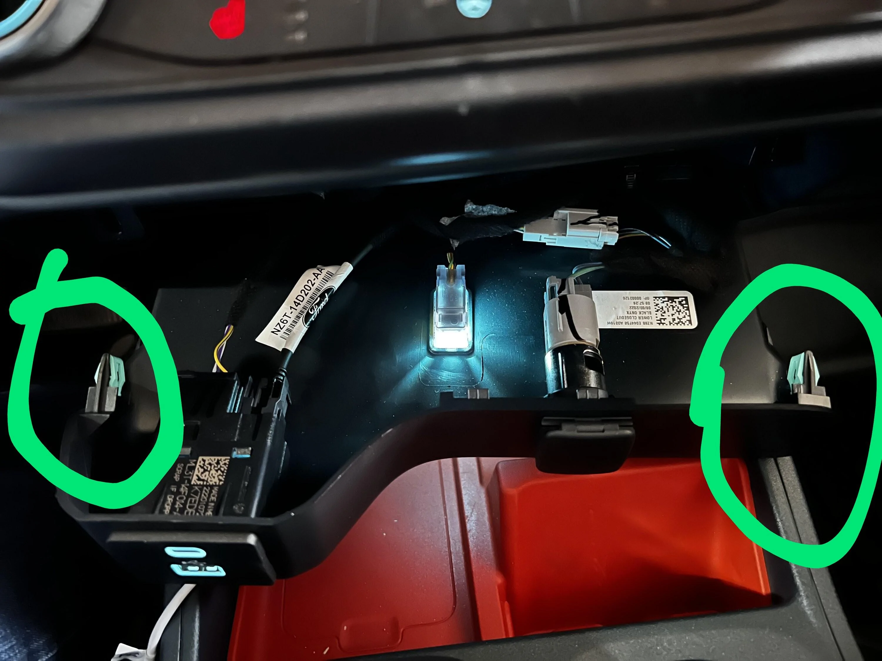

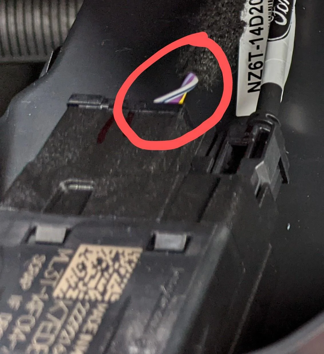

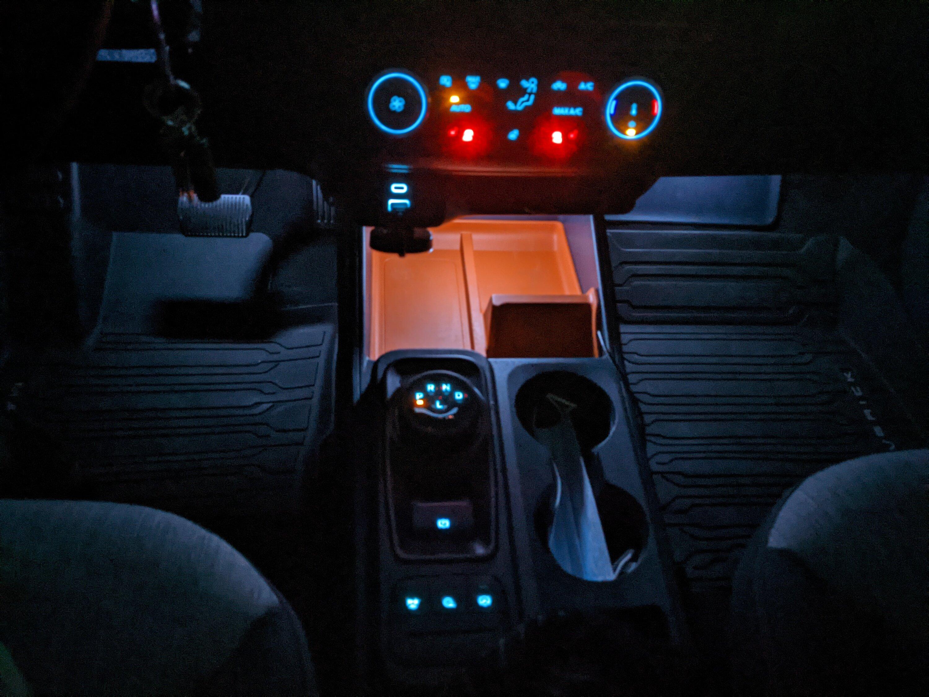

Instead of ordering the factory part, I decided to just make my own ambient/console light.
Remove the lid (clips circled in green, other clips are hidden towards the back) and unplug the harness (red circle) that is used to illuminate the USB ports.
(picture credited to @Executech)
You'll tap into the white/stripe for your (-) ground and purple/stripe will be your 12v (+) positive - these will dim along with the dimmer switch on the dashboard. The yellow/stripe is switched 12v that can be used for some other low power accessory. Dash cam, etc...

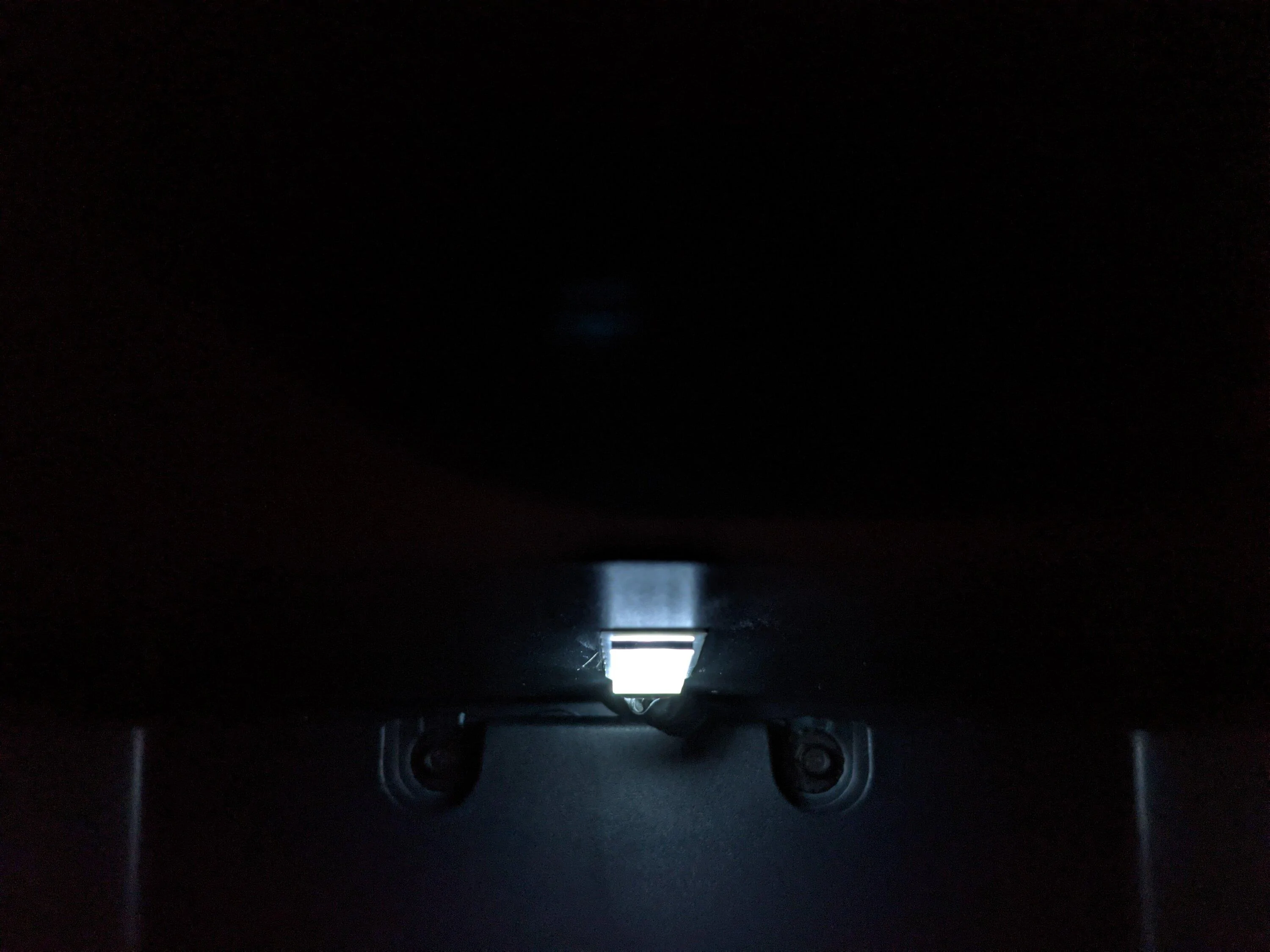

I used an LED light along with a 1k ohm resistor, soldered them together, wired everything up with some spare 18ga and taped them up. Shrink tubing would also work, but I didn't have any and didn't want to go back to the store. I used a 3M Command Strip and mounted it where the factory light would've been (there's an outline in the molding).

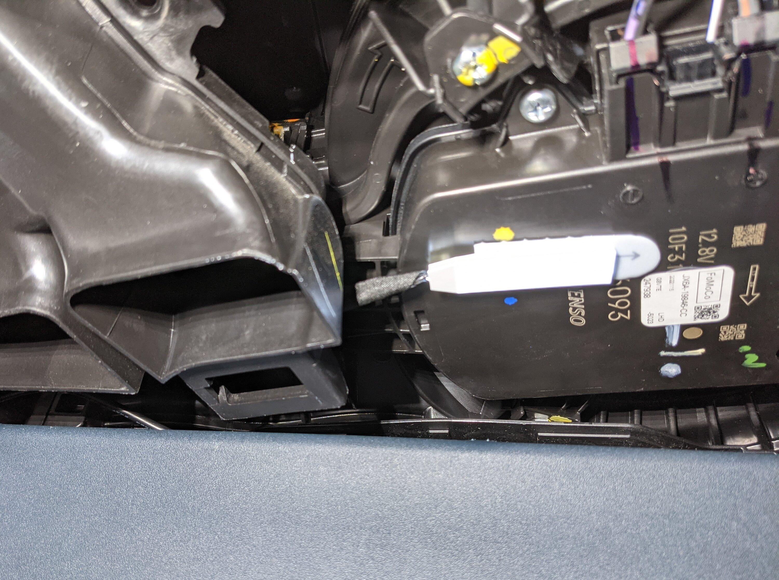

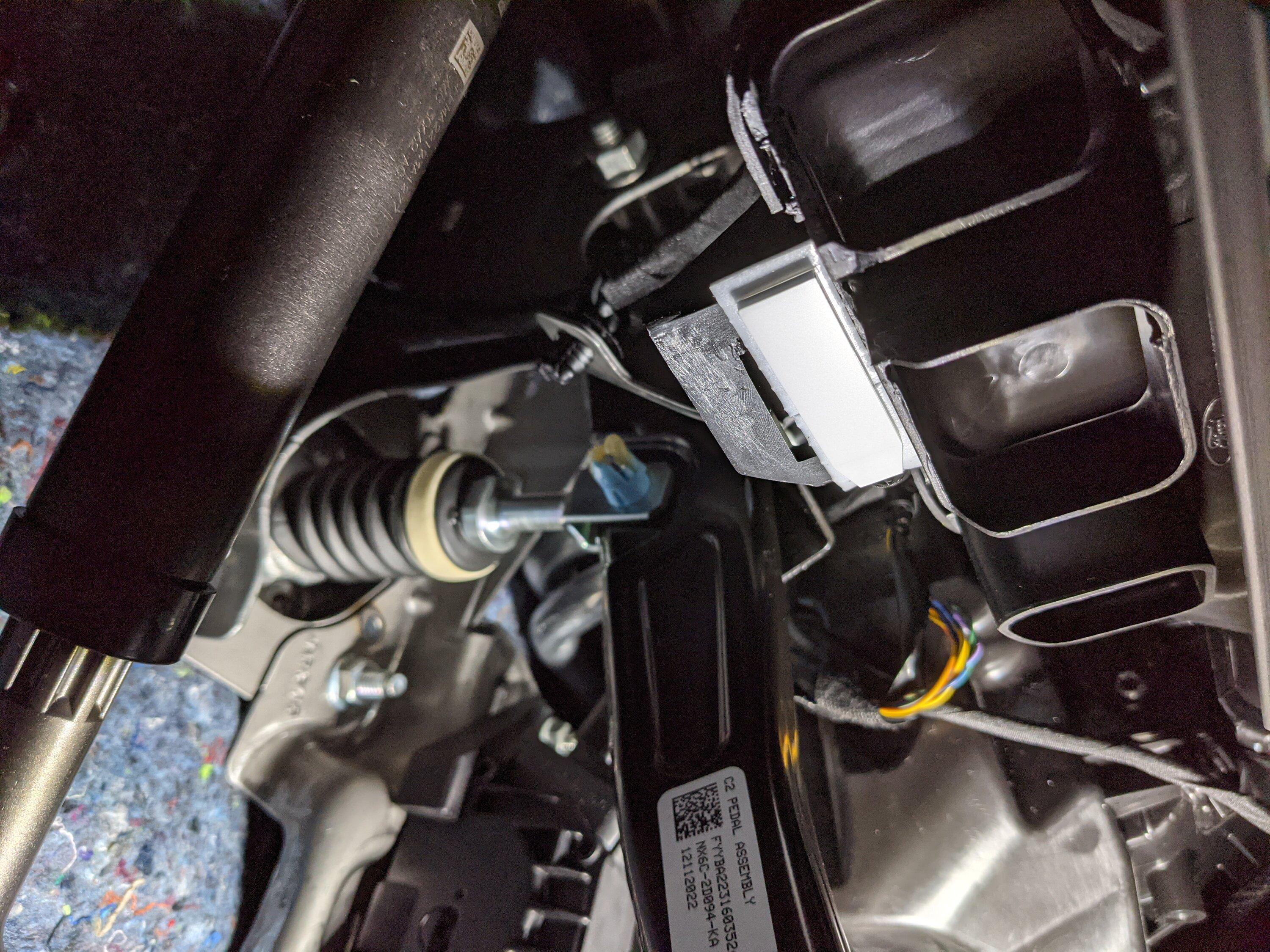

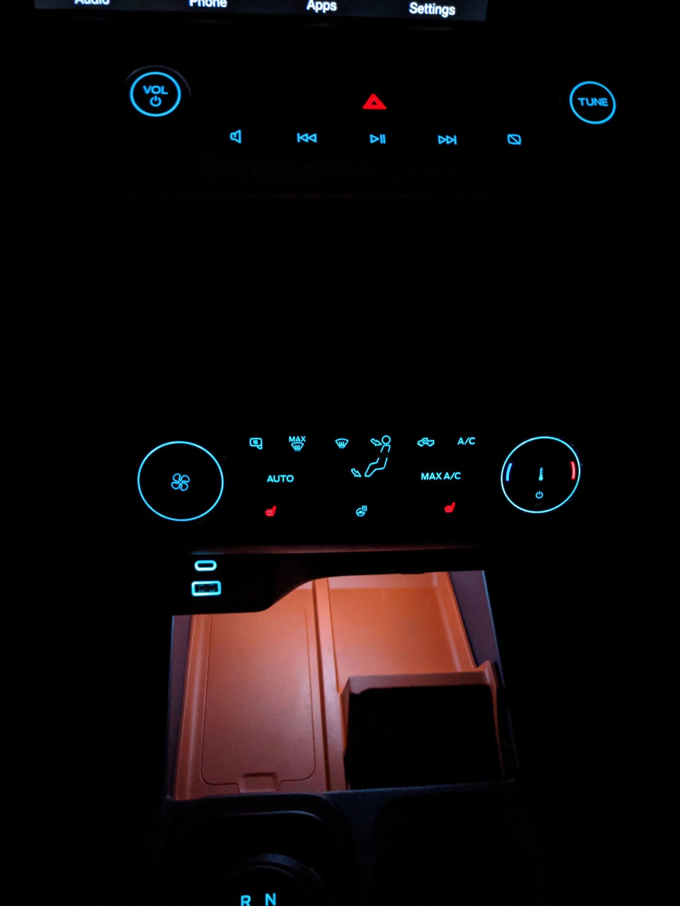

Finally got around to installing the foot well lighting! This time I decided to use 2.2k ohm resistors to dim it down a bit more. I wouldn't go higher than that. If you want brighter, go for the 1k ohm. I would stay in the 1-2.5k range. Keep in mind these dim with the gauges.
Placed the driver's side in the same spot as factory.
Ford Maverick DIY - Adding ambient light(s) to 2023 Maverick XL/XLT for <$10 PXL_20230221_022801758
Placed the passenger side on the fan housing for a bit more of a centered placement compared to the factory spot which is off to the left.
Ford Maverick DIY - Adding ambient light(s) to 2023 Maverick XL/XLT for <$10 PXL_20230221_021700721

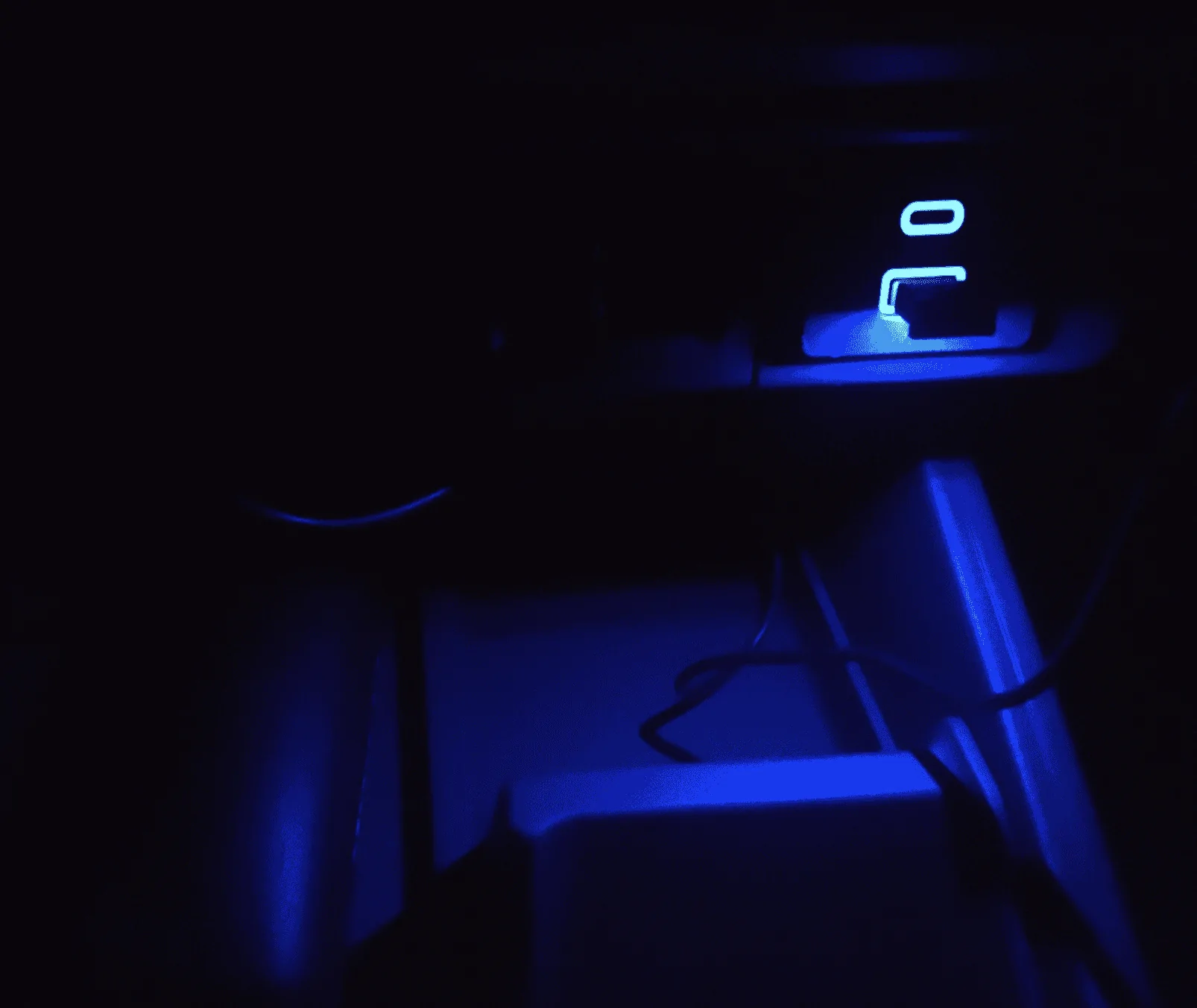

Final results:
Ford Maverick DIY - Adding ambient light(s) to 2023 Maverick XL/XLT for <$10 PXL_20230221_023750331
(Using night mode, a bit more realistic of what it looks like in person)
Ford Maverick DIY - Adding ambient light(s) to 2023 Maverick XL/XLT for <$10 PXL_20230221_023528325.NIGHT

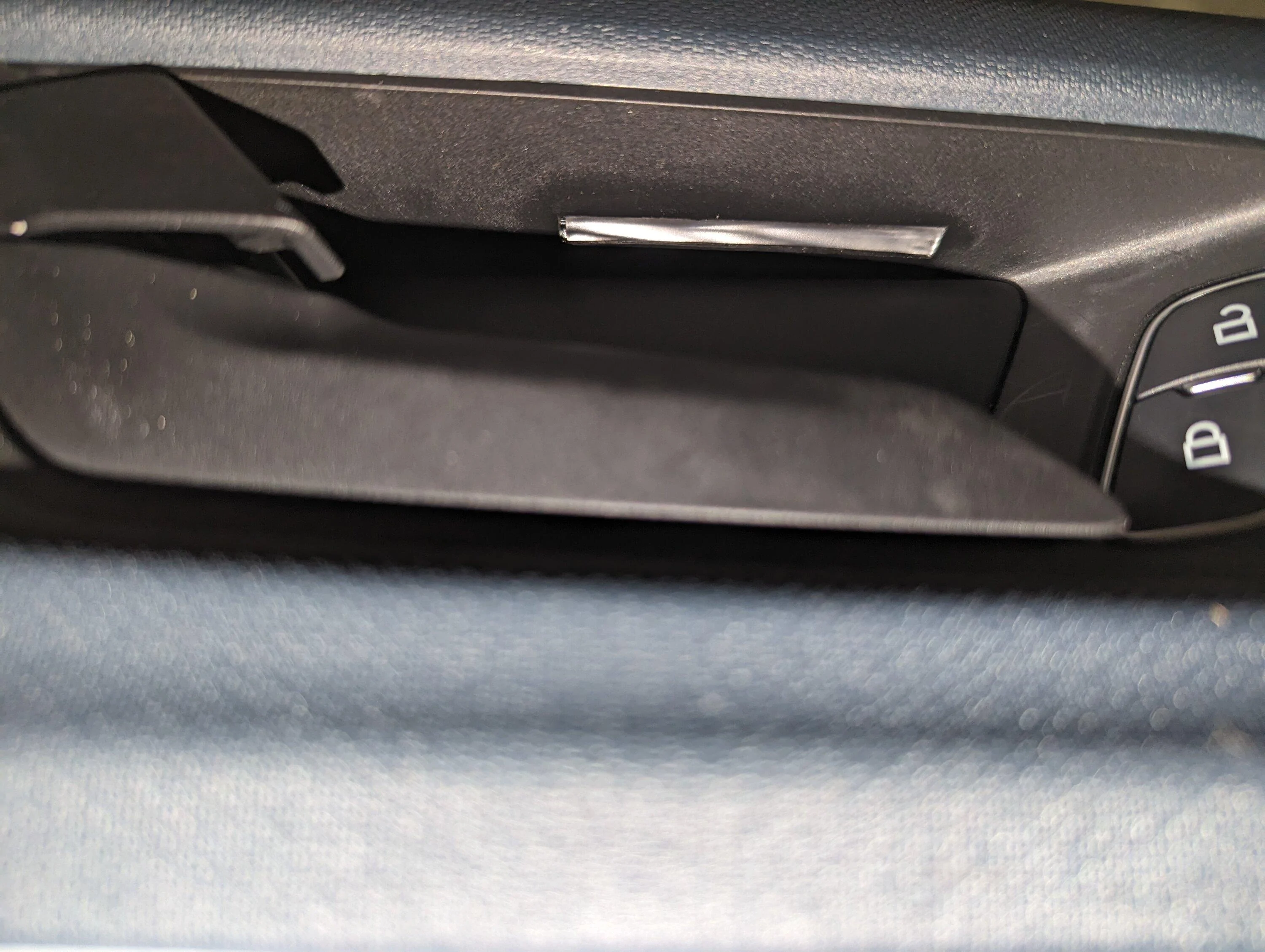

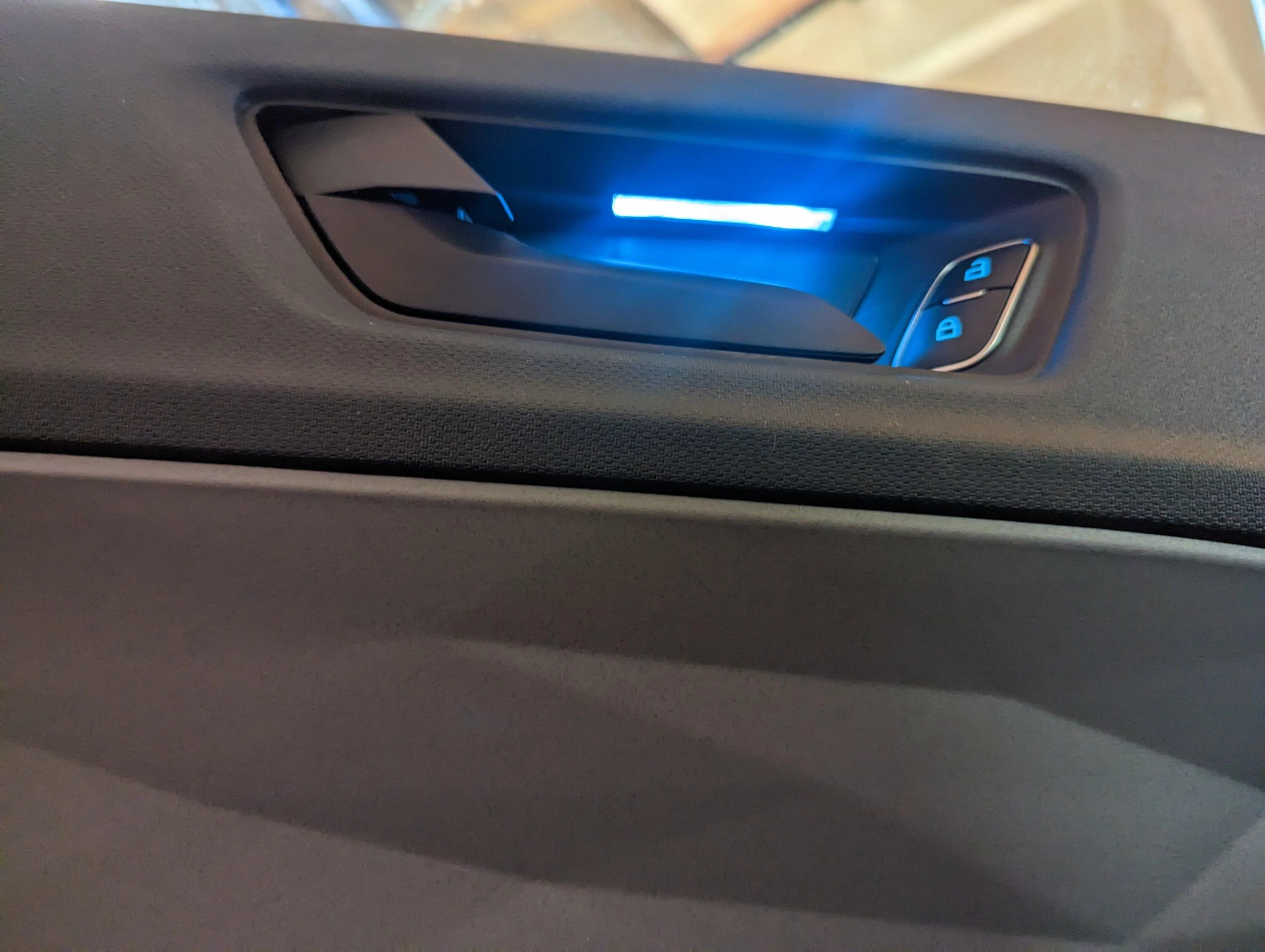

Just saw your request about the door handle ambient lighting. I have attached some photos to show you what it looks like.
Ford Maverick DIY - Adding ambient light(s) to 2023 Maverick XL/XLT for <$10 PXL_20230314_002125146
Ford Maverick DIY - Adding ambient light(s) to 2023 Maverick XL/XLT for <$10 PXL_20230314_002152807
