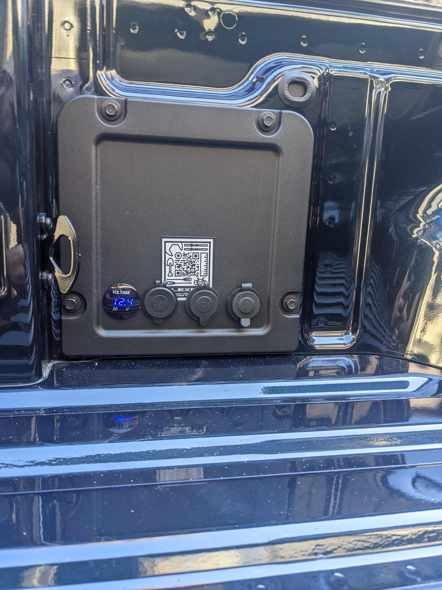

Just my OCD but I would have mounted them at the top of the plate as to not upset the QR code there but otherwise I like it!
volt meter is a little overkill but why not! I would just hook up to the 12v aux wire already in place. I don't want to run hot all the time.

The power parts are from amazon:
The wiring from the battery is from ARB:

I wanted to run my ARB fridge and had an extra wiring kit laying in the garage. I wanted it to be constant hot, so I ran from the battery to the panel where the 110 plug would be in the rear of the bed. I also found a 12V power port and dual USB port that are marine grade from another project. Tailgating just got a bit better.
Excellent installation
