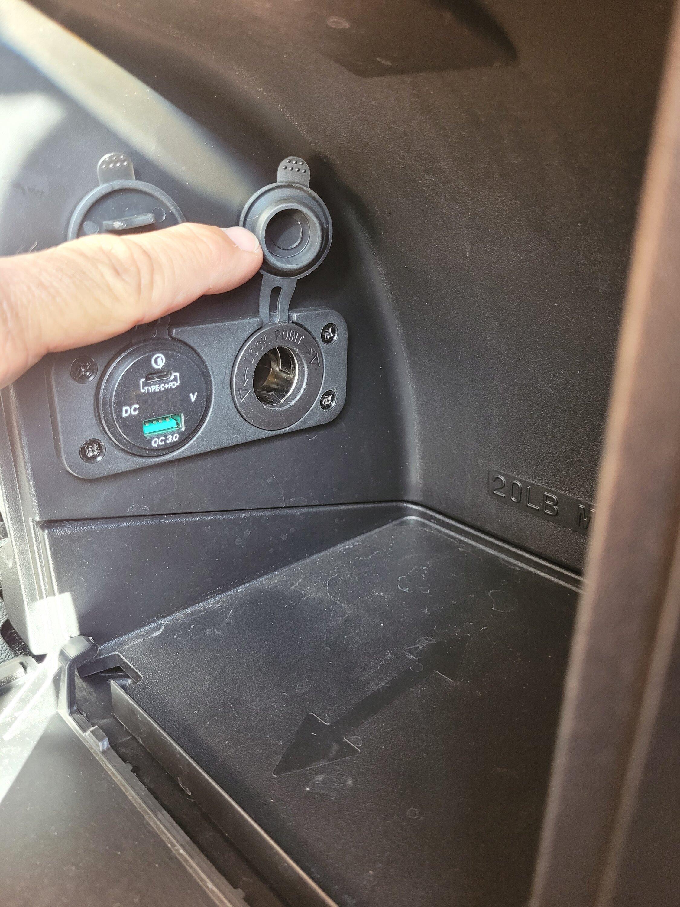

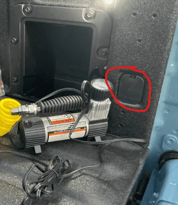

Do anyone have the dimensions of the little plastic cover over the pigtails?
I'm thinking I might mount a single 12V there if it is big enough. If not, I'll just do the USB-Cig combo inside the bin.
Amazon has a nice offering of marine USB & 12v sockets that will fit nicely into the covers. I used a 1-1/8 forstner bit for the hole (very clean cut with the forstner - I learned earlier not to use a spade bit as it chewed up the hole terribly). You will also need to remove the plastic docking on the rear of the panel cover. The docking is what holds the 12v connector in place until you use it. I don't have a photo of that since I've already removed them. You should get a cleaner hole once they're gone. I used a vibrating multi-tool with a narrow cutting bit to remove it.

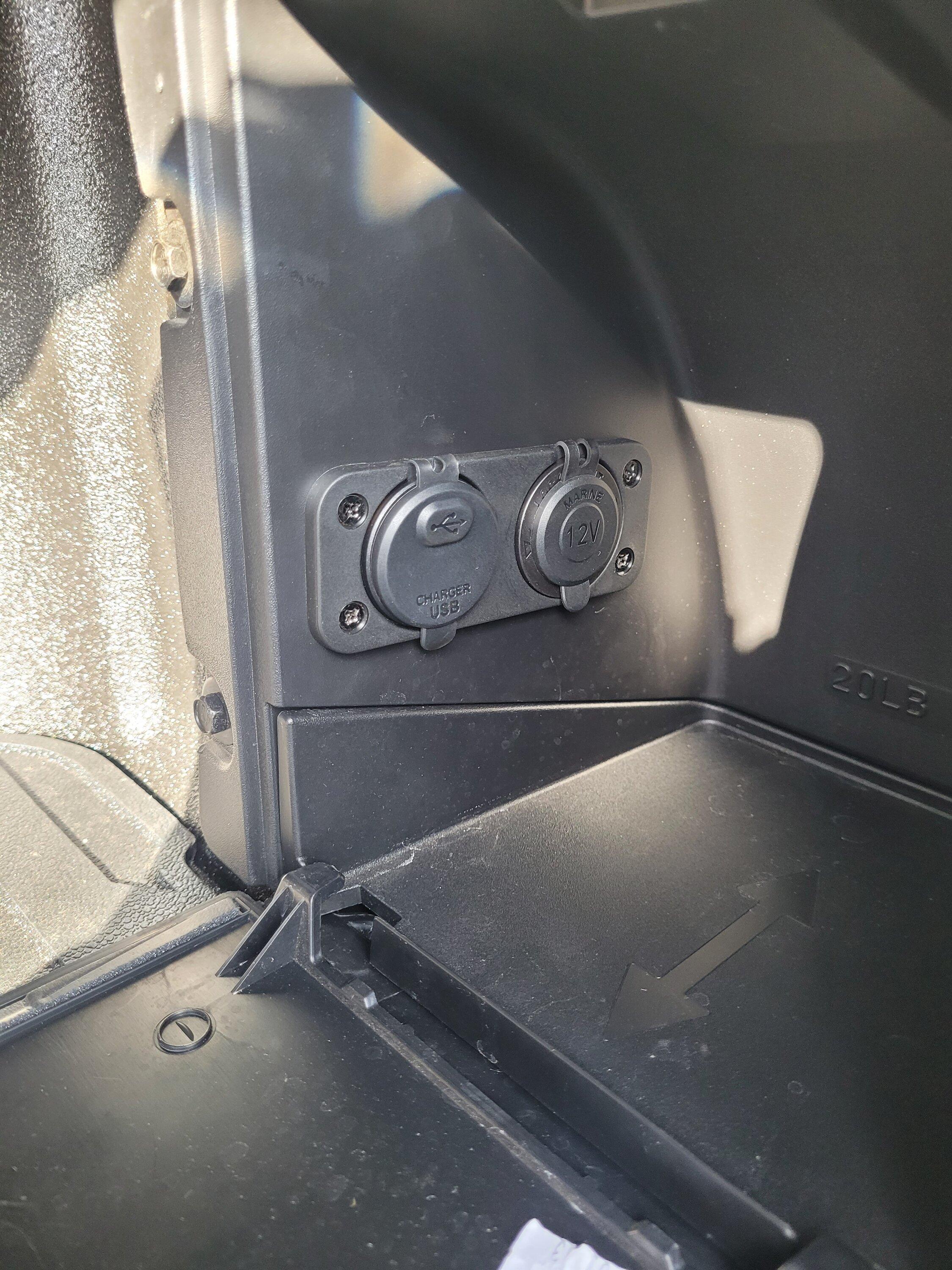

No I cut out individual holes . Had no issues went very easy
I don't understand how. My cubby/box is almost as wide as the opening it was going in, so when I put the two receptacles in with the wiring attached, it was too wide to fit through the opening.
I had to push the cubby in just far enough to get the 1st hole behind the wall of the bed, and then push the receptacle through and use a screw driver to slowly turn the "nut" that holds the receptacle to the plastic housing. Then I pushed the cubby a little farther in so the 2nd hole was inside the walls and repeated the nut. Then I pushed the cubby the rest of the way in and bolted to the bed wall.

No I did not distort it. I took my time installed them with only a few threads was able to fit it in the cubby. Once in I was able to squeeze my hand behind it and tighten up the plastic nuts.

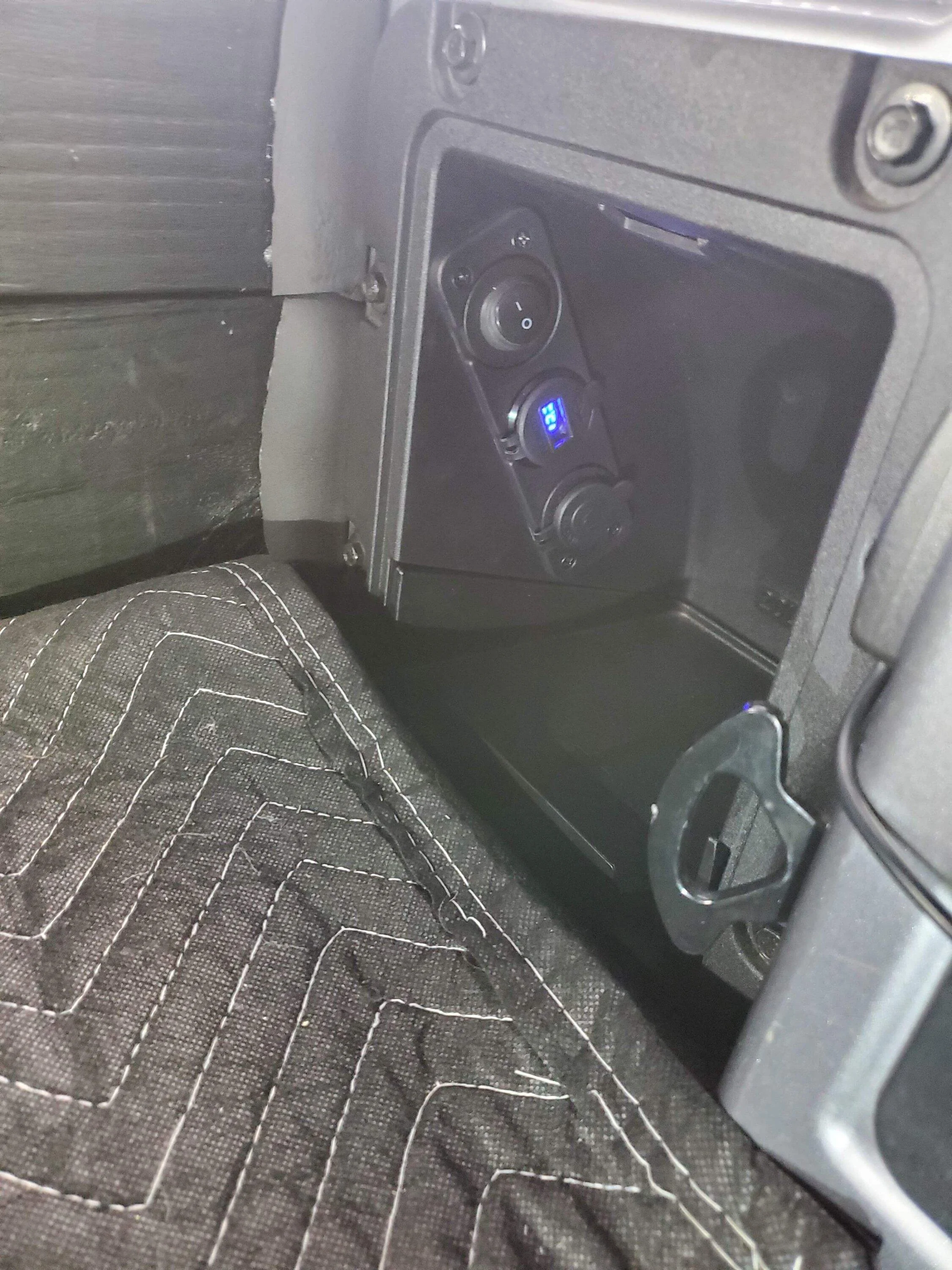

Just did mine over the weekend . Wanted it as clean as possible so I installed it inside the cubby. It includes USB, USB C, 12V and voltage gauge. You cant see it now but the 12V port lights up inside .
I am mounting it in the cubby too, but on the side towards the front not the tailgate. This will allow me to read the display and see the ports while at the back of the truck for easier plugging into the USB ports. I am using the three port piece that started this thread and mounting it vertically and rotating the on/off switch 45 degrees for the correct orientation and the covers opening away from the bed.

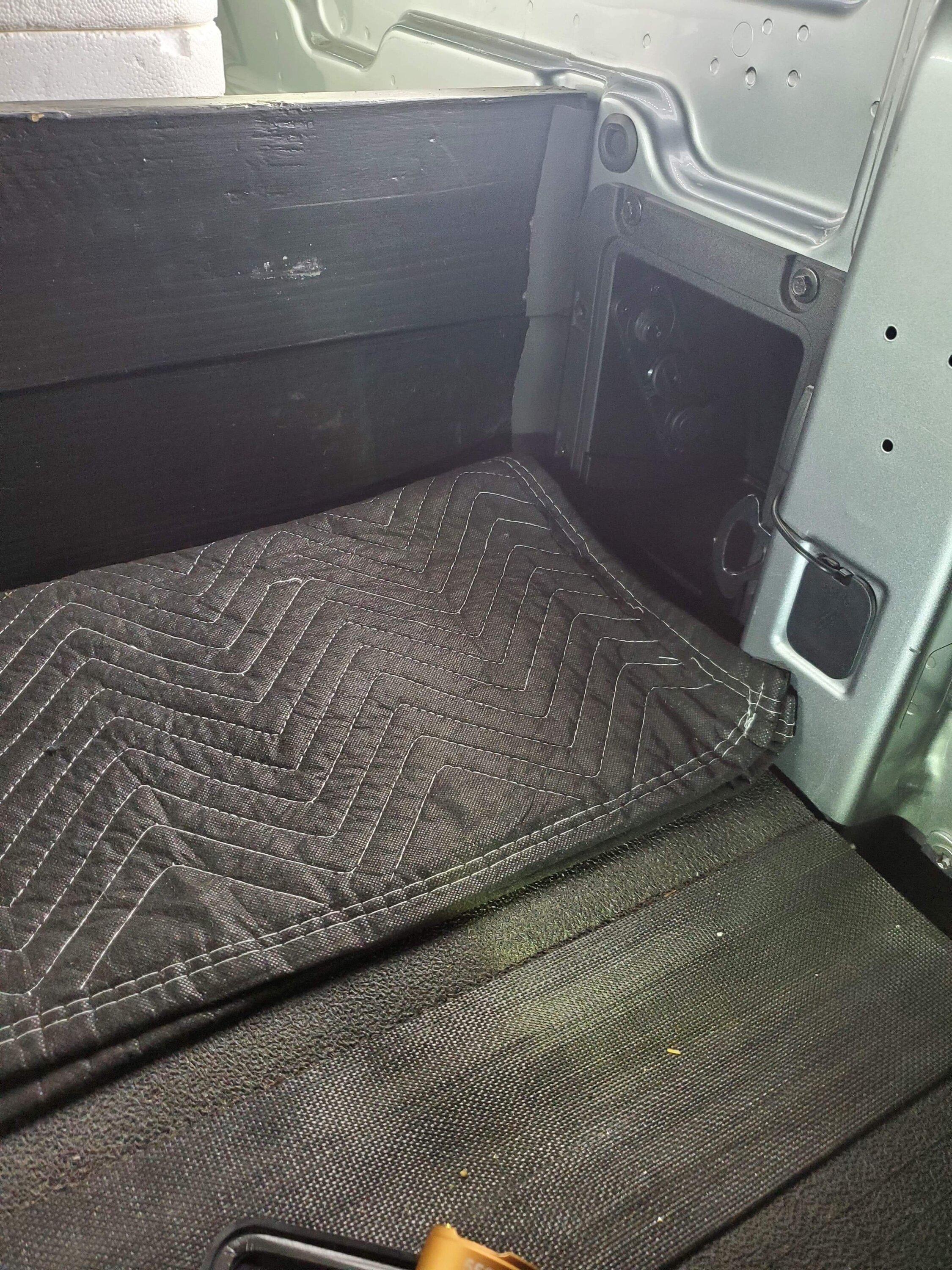

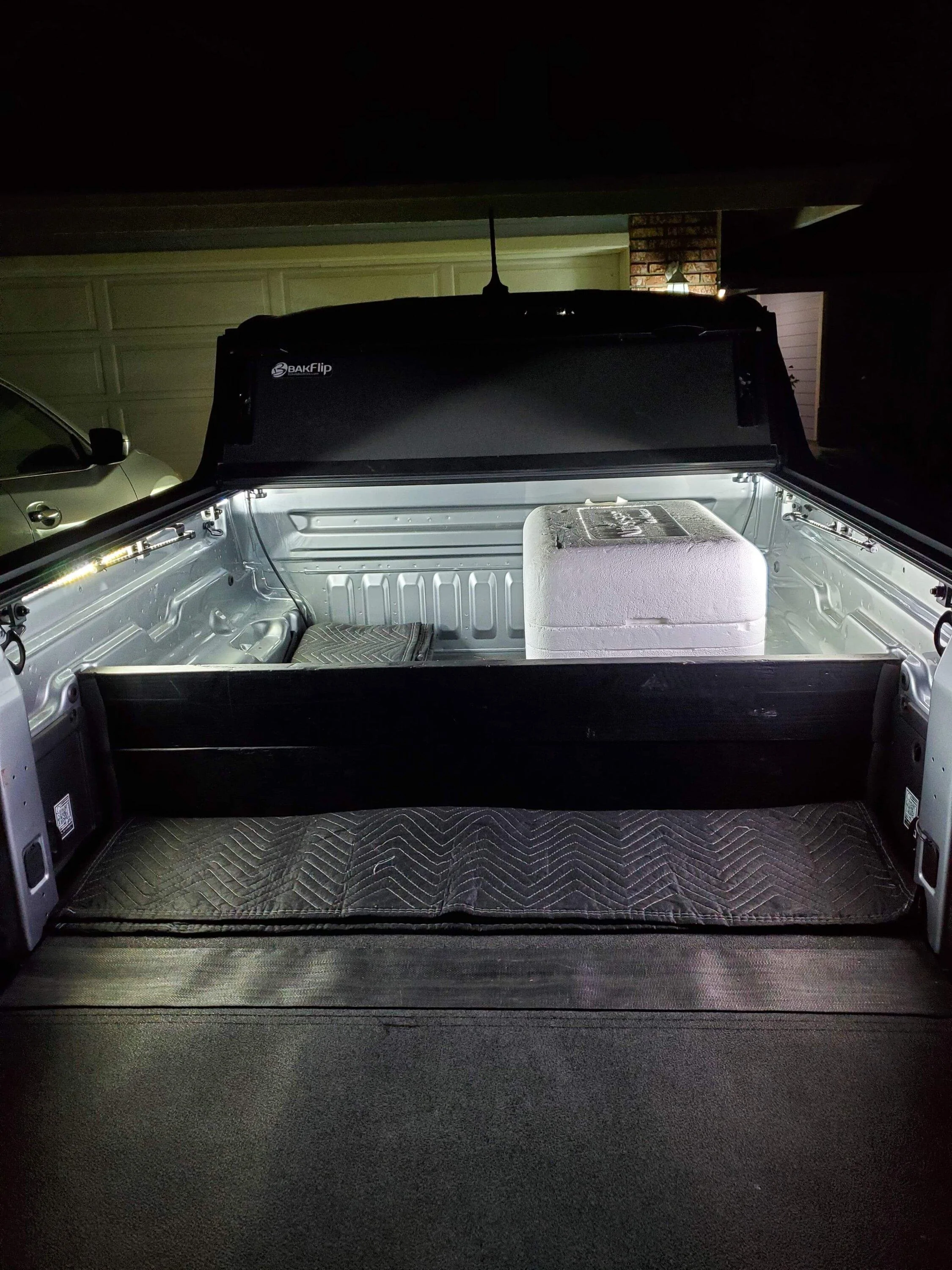

Installed today and they cleared the body easily. Wasn’t enough flat surface to go completely vertical, so I went with an angled install and being able to see them from the tailgate was worth the hassle. I can read the battery charge and I wanted the unit to have its own on/off switch. I also swapped out the old style glass fuse and replaced it with the same amp blade fuse. Fuses for the lights and power panels can be accessed the through the diy access pop out, this did take adding additional wire length.
I really like the way you have the 2x4s wedged in with foam. I'm guessing you did that to protect the paint? Did you use pipe insulation foam?
