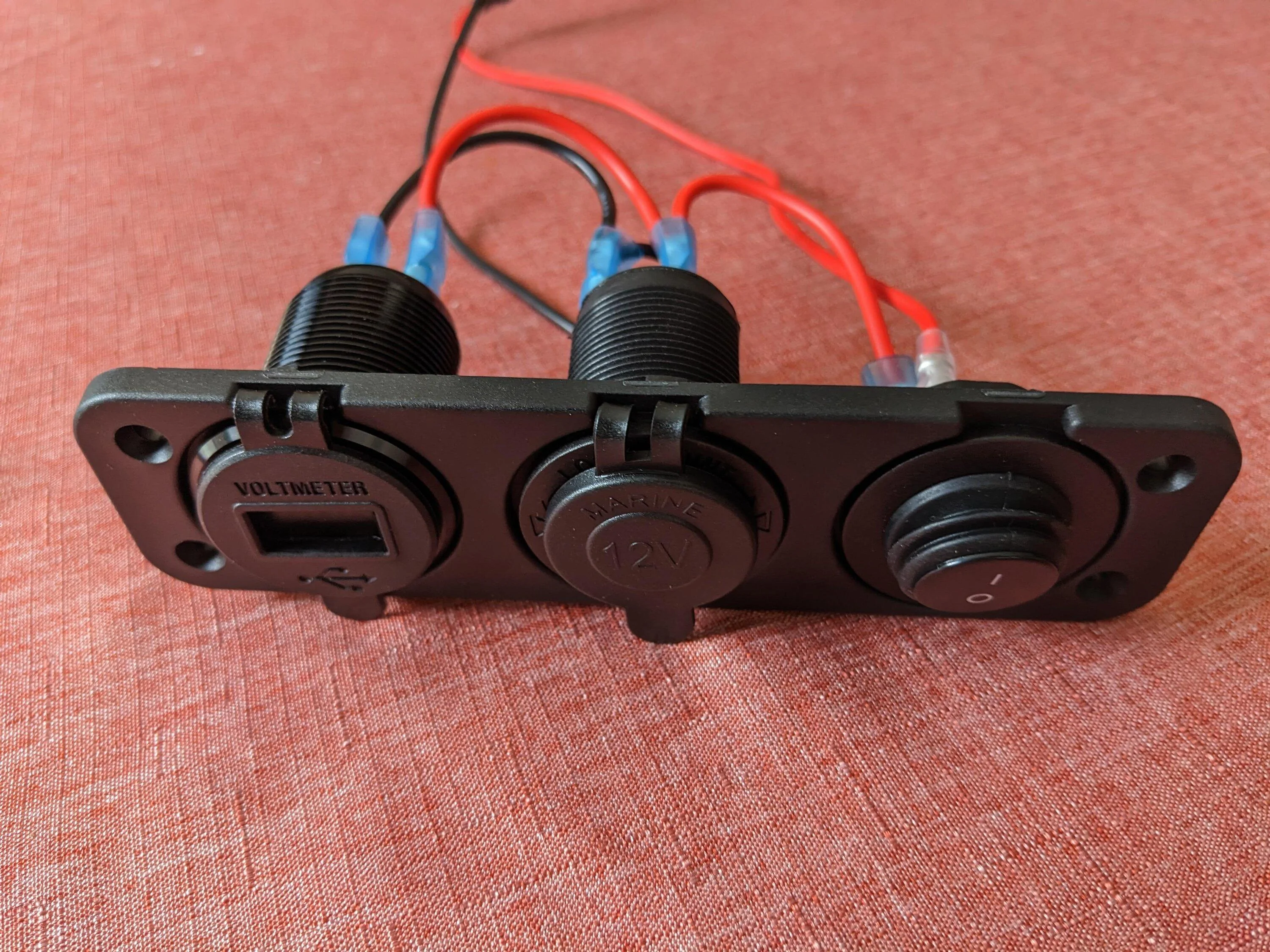

I had 2 add on panels of different ports, USB, 12v, voltmeters, and switches.

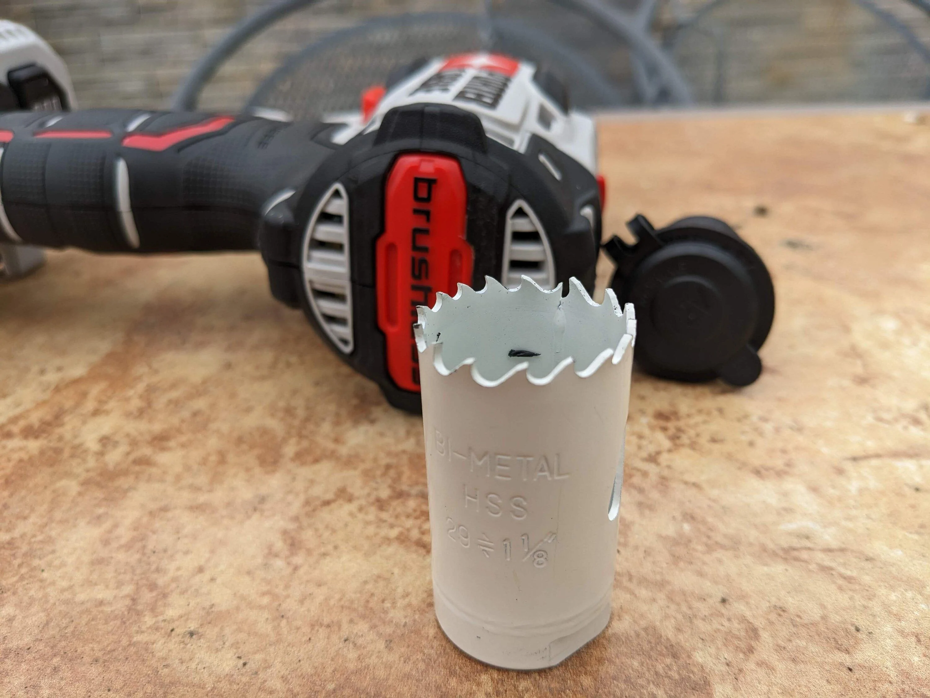

I used these to harvest the parts for the 12v power ports.

I drilled two 1 1/8 holes (29mm) in the side of the cubby.

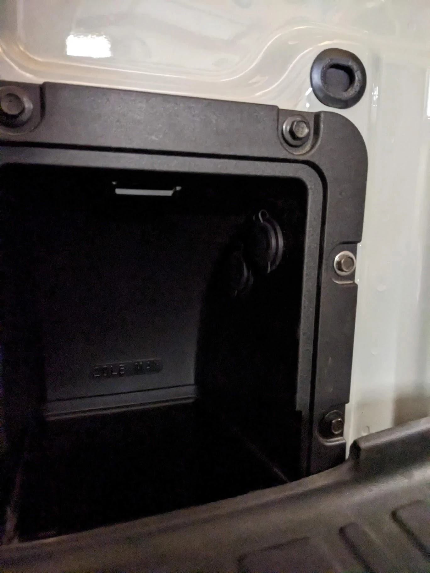

Here is a close up of the two power ports.
Also from a little bit back more, sorry it came out so dark.
Ford Maverick Added 12v power points to the bed cubby PXL_20230610_231545489 (1)
I tested them and they both work.
