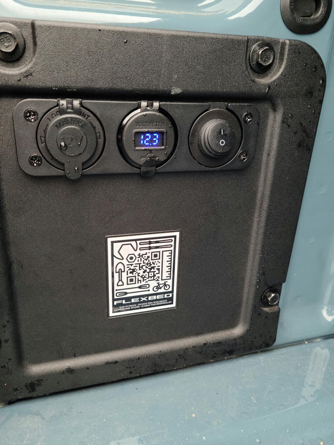

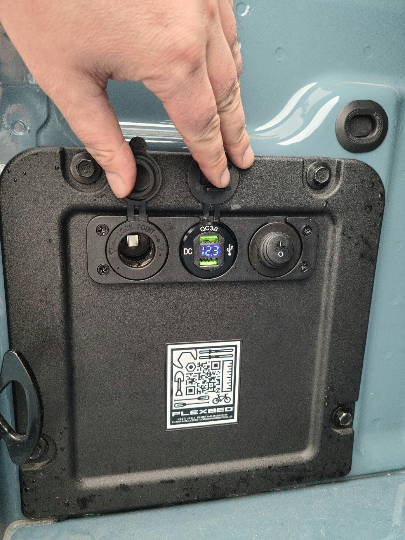

Just did mine over the weekend . Wanted it as clean as possible so I installed it inside the cubby. It includes USB, USB C, 12V and voltage gauge. You cant see it now but the 12V port lights up inside .
This is exactly what I did. Did you drill a separate hole for each socket, or did you cut out a big rectangle? I did 2 holes which made it very hard to get the socket secure from the back side.
2 things I'd do differently:
1) Instead of putting the sockets in horizontally, I wish I had put them in vertically, so both were equally close to the opening. His & mine have the cigarette lighter further back.
2) I wish I had cut out a rectangle instead of drilling just 2 holes. Would have saved myself a lot of time.
No I cut out individual holes . Had no issues went very easy
