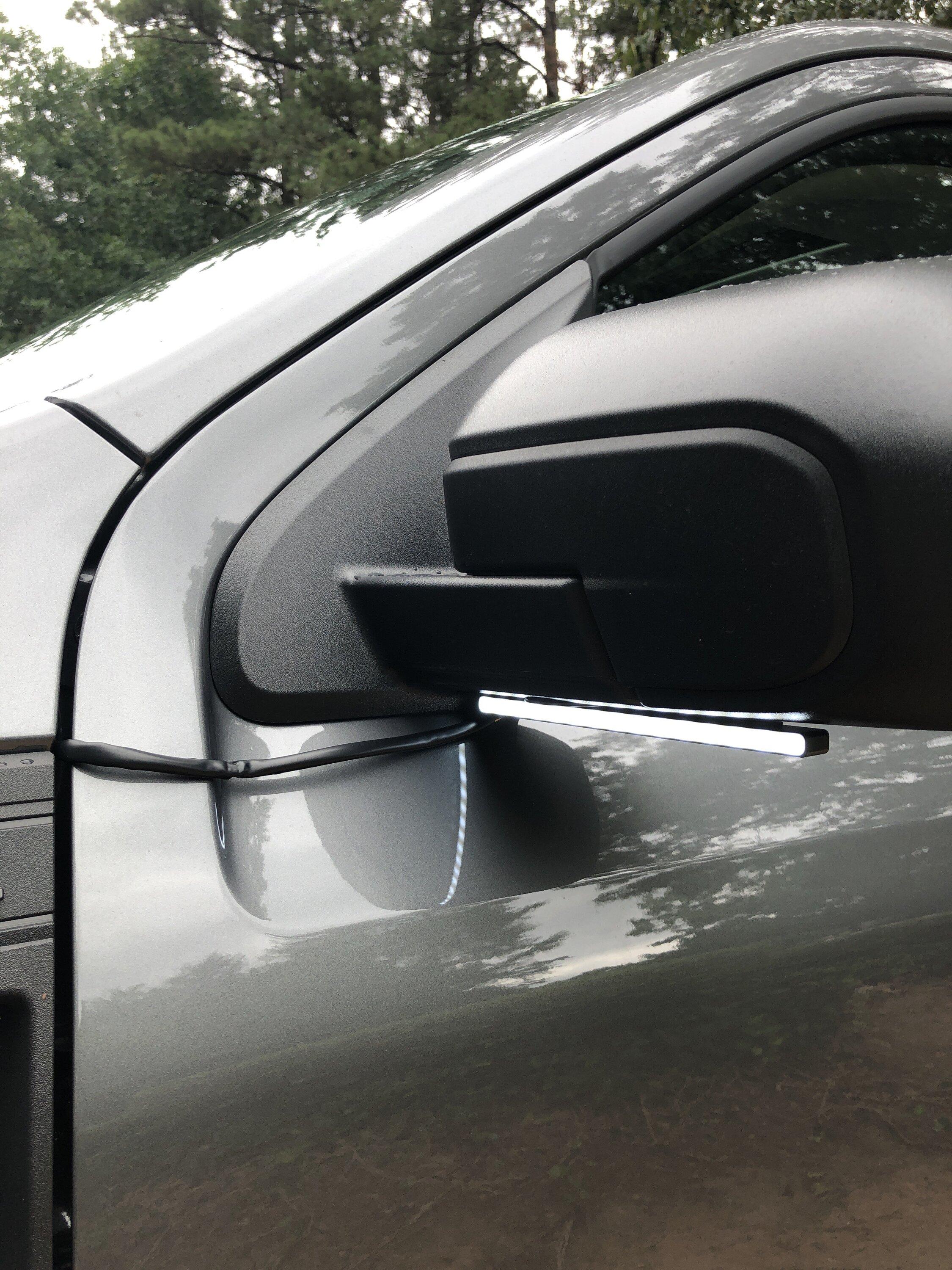

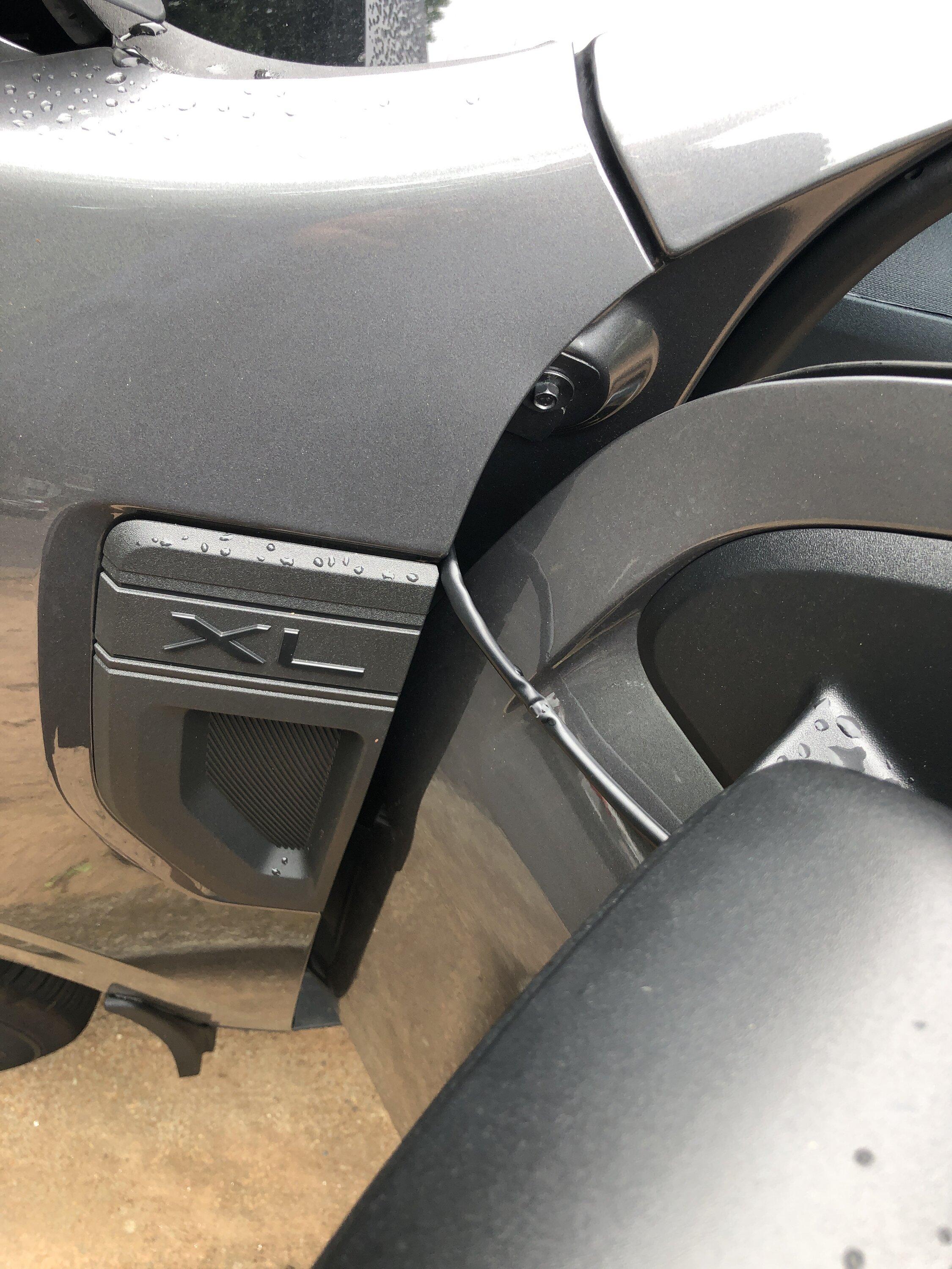

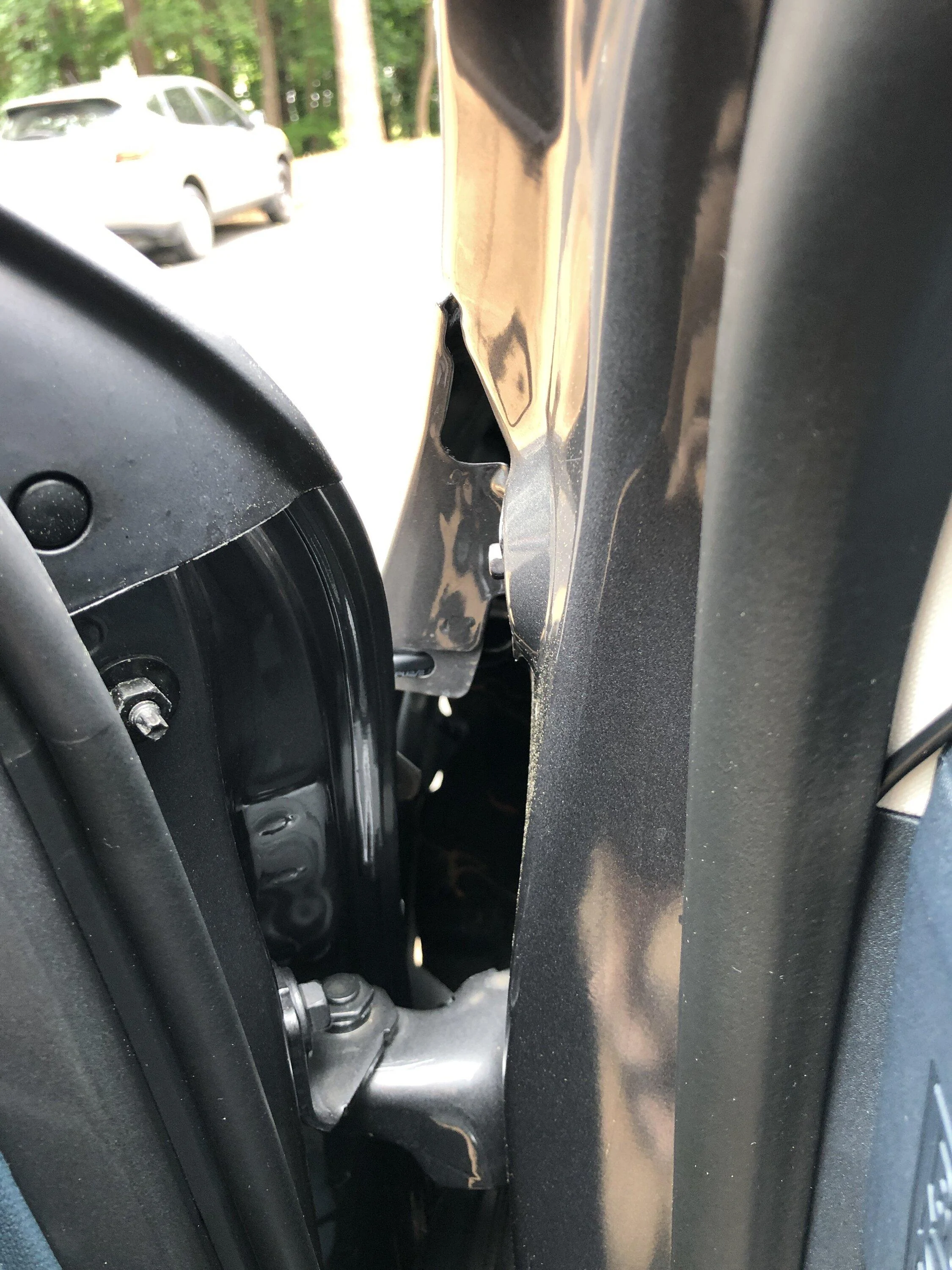

I like the idea. Like most of the feedback, I think it would look better if the wires were hidden. Maybe routed through the side mirrors as there is already a wire bundle going to the mirrors already. Would require drilling into the mirror, but even routing out the front, bottom of the mirror would look better than coming out the door like that.

to follow up on this, the correct thing to do would be to remove the mirror which should be possible by pulling the door panel including sail panel, and wiring through the existing bundle into the door.

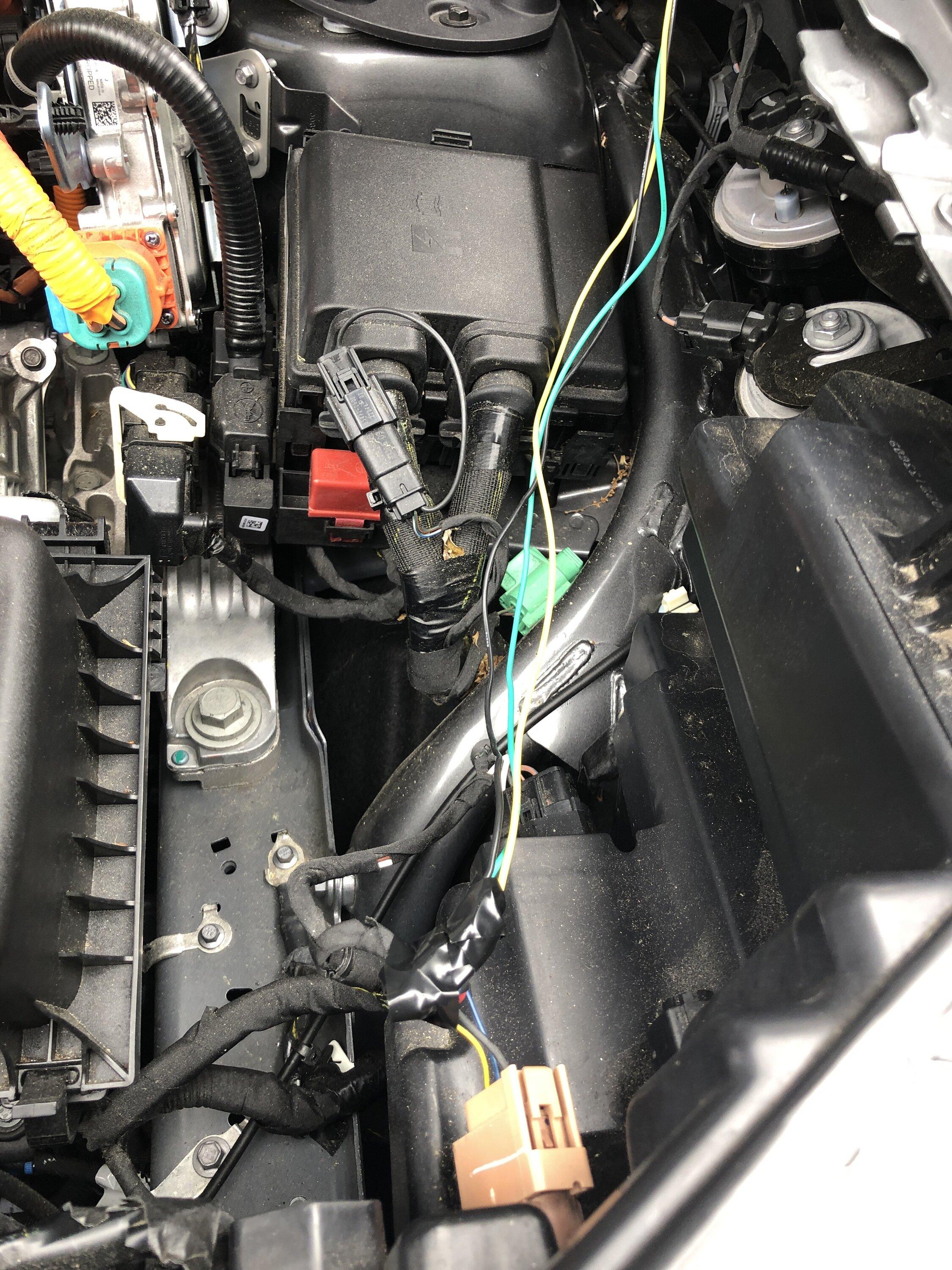

a second strong suggestion would be to use heat shrink tubing and solder connections. it's especially important on anything under the hood. if heat, age or anything else causes your electrical tape to fail and presumably your twisted wire splice is exposed, you could have a short which at best will blow a fuse and at worst will start a fire.
that said, I've seen YT videos of 'professionals' install off-road lights that use a 40A circuit - way more than your LEDs I'm sure - and do what you did.

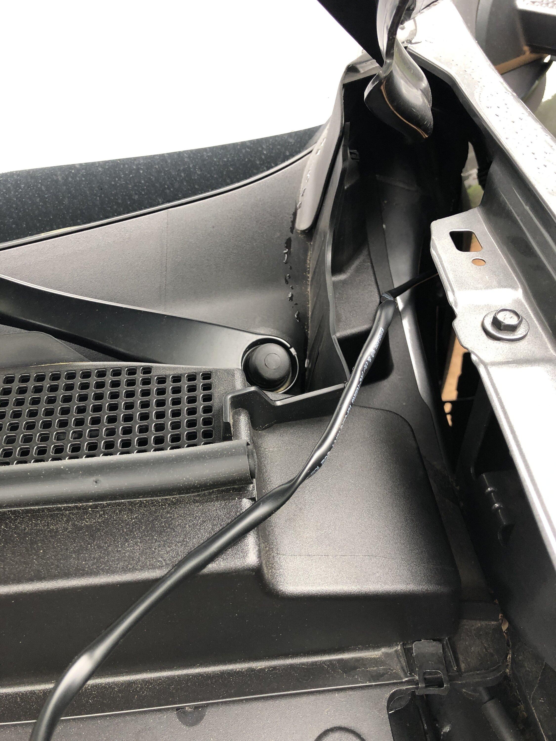

That bundle of wires appears to be getting very badly pinched. It needs to be routed a different way, because with enough damage, it can short out and be a fire hazard.
You can simply drop it down the side further into the fender
Bad angle I guess but it’s not being pinched at all. I will find a better way to route and package the wires with more electrical tape. Thanks for the feedback.
I will leave this to the next person. As for me I’m ok with having the wire hanging out of the mirror like that. You won’t be able to see the wire on the mirror at night anyway so .

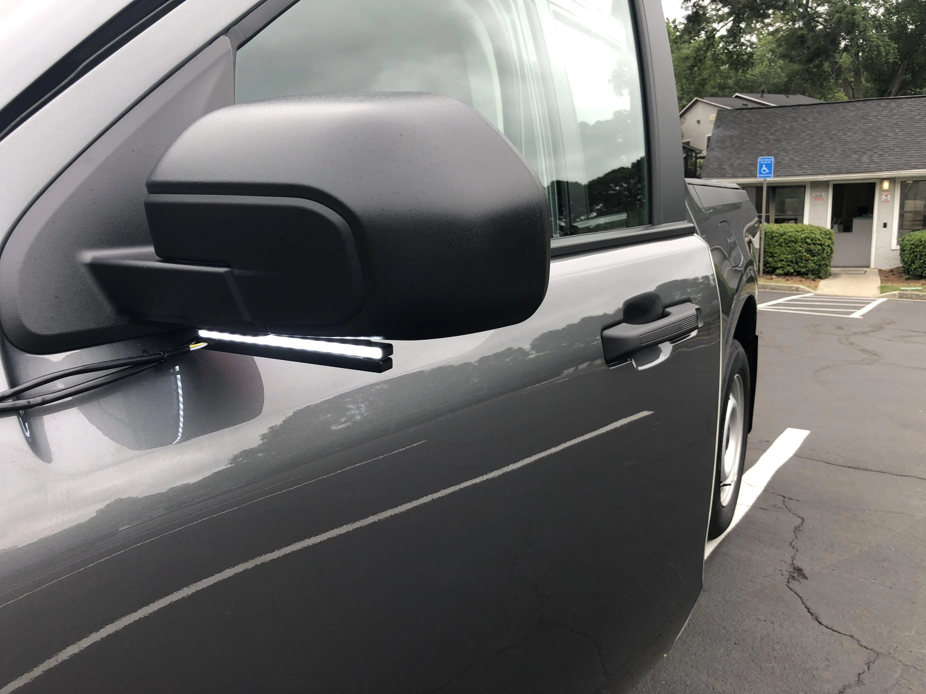

so another question i have for you experts is, do i need a load resistor for the turn signal wires? As it stands, I'm not getting hyperflash with the turn signals on the mirrors and I'm tapping these wires to the stock turn signal light connector in the front. I do have a problem with hyper flashing when connecting the stock tail/brake light connector to these lights. The yellow turn turn signals get hyperflashed like they trying to send out Morse codes. In case I'm getting chewed out by the MTC's police for not using a load resistor on my LED lights, I have already ordered load resistors from Amazon and waiting for the weekend to install.

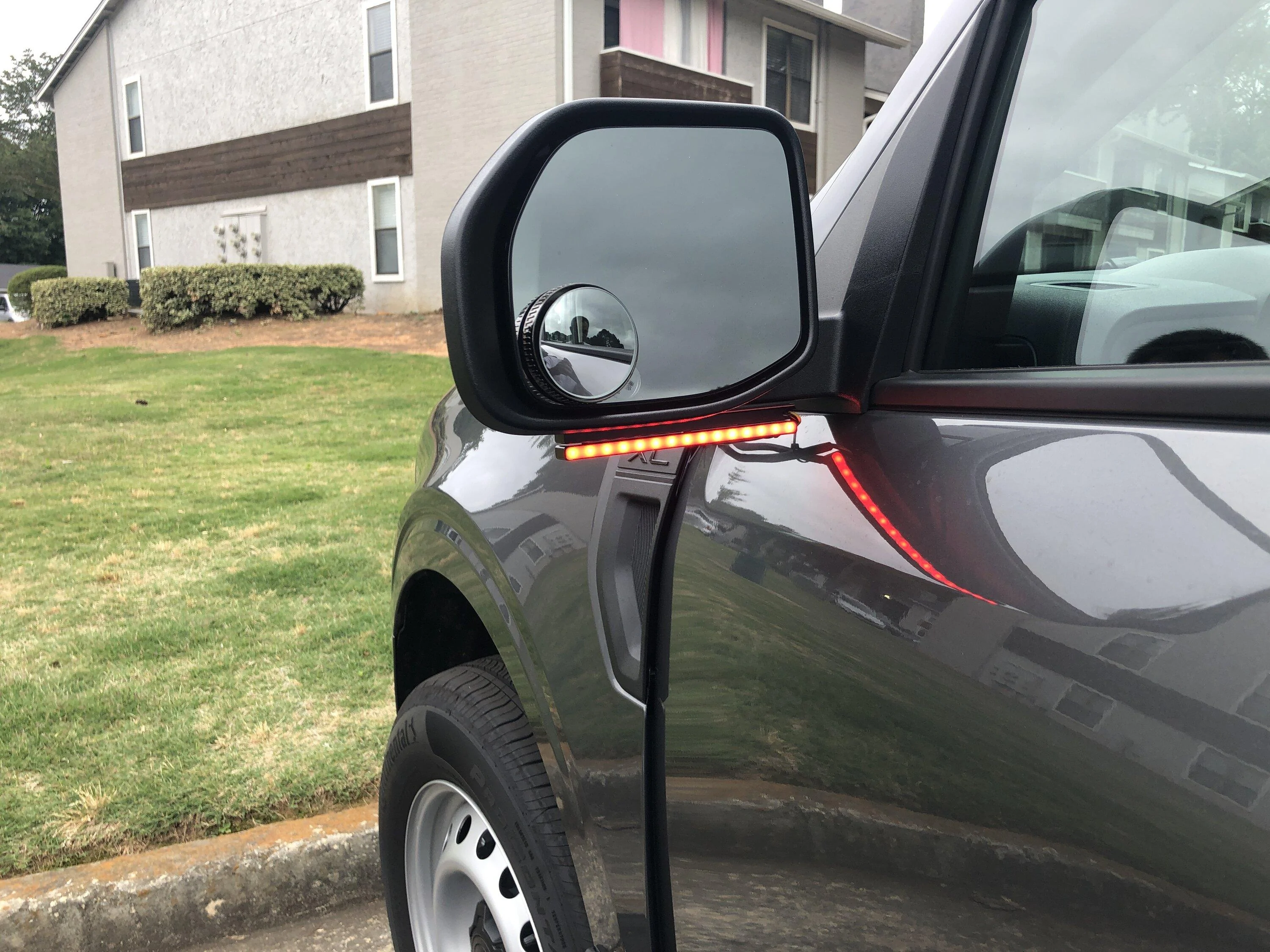

Added front and rear turn signals. Decided not to attach to the rear bumper since I couldn’t tap into the lighting wires without getting hyper flashing even with load resisters. I know some of you hate the exposed wires but they don’t bother me. For now the signals can be seen from the front and rear and they are also doubled as White DRL and red looking from the rear.
Ford Maverick Added sequential turn signals and DRL to my side mirrors IMG_8629
Ford Maverick Added sequential turn signals and DRL to my side mirrors IMG_8628
