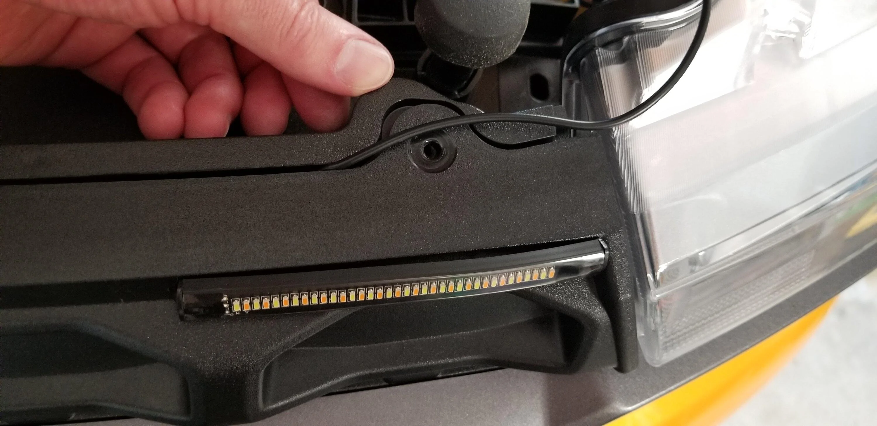

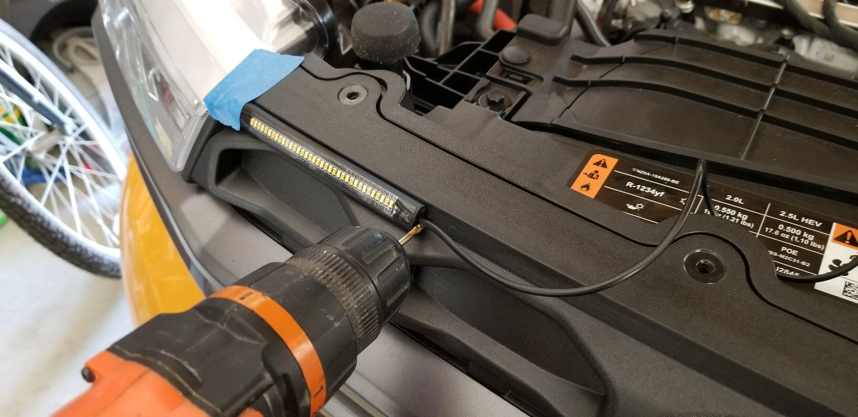

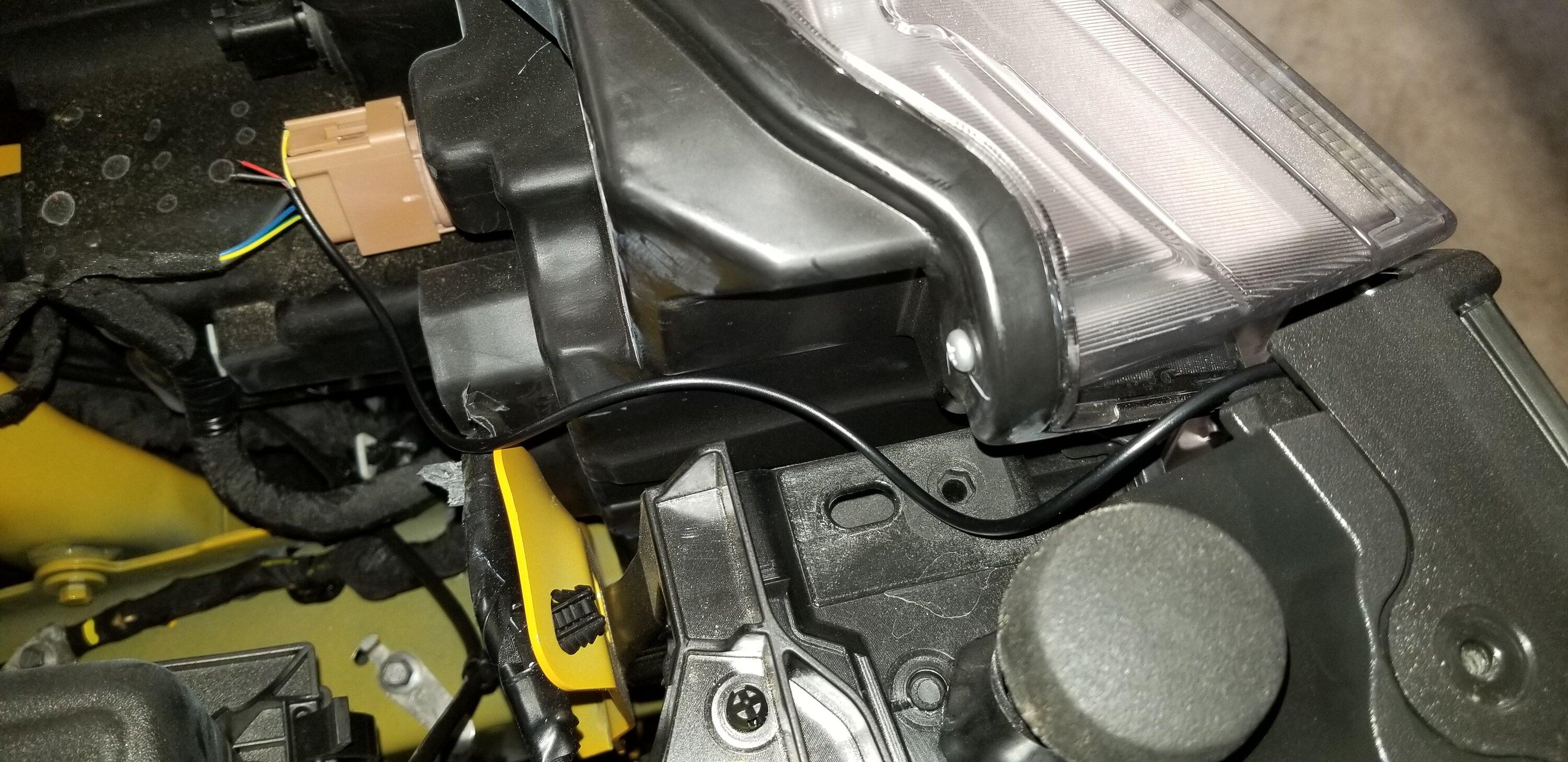

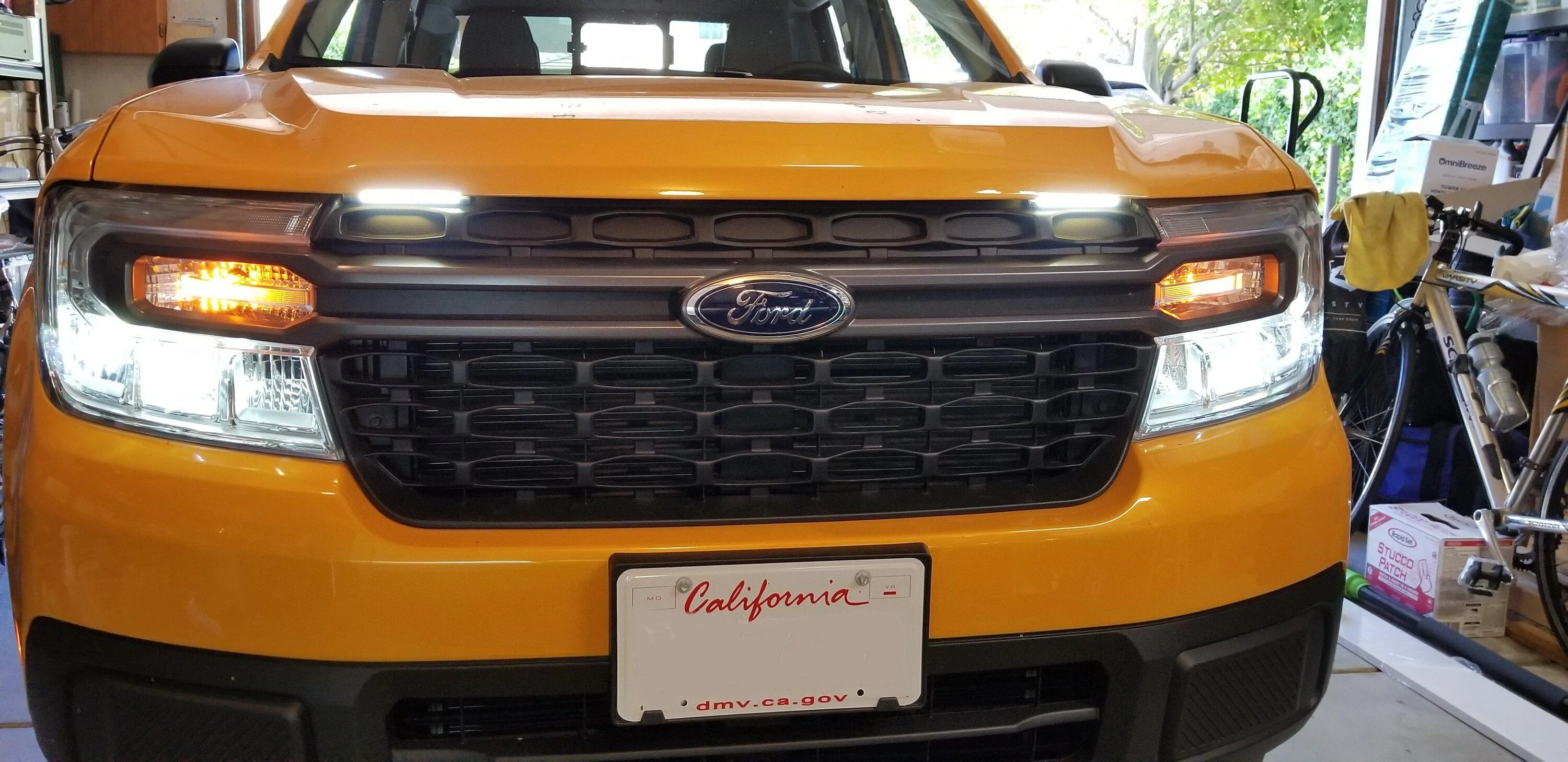

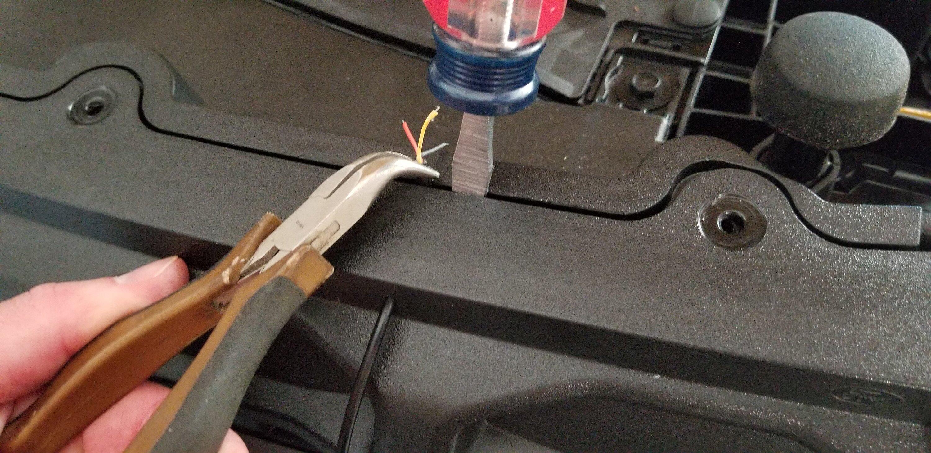

I wanted to put these lights in the center grill piece until I learned you have to take the front facia off to get to the back of the grill. So I put them at the top of the grill where I could run the wires to the front turn signals. They have mounting adhesive on the back that just sticks to the grill. I figured if they didn't work, I'd only have a little 1/8" dia. hole in the grill. I tied them into the turn signal lights in the headlight cluster. Guess I'll always be a car guy who likes to tinker, especially now that I'm retired. The whole project cost about $10.

Creative! I really like the eyebrow effect these give, thanks for sharing
