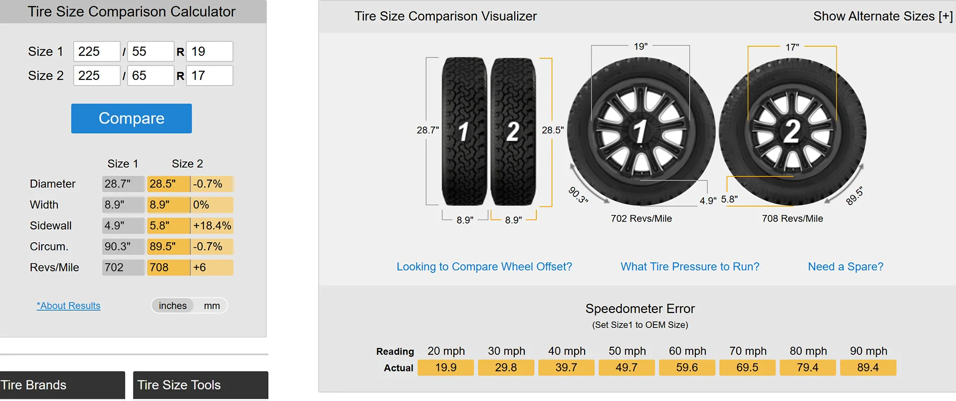

There are differences between same year models based on selected trims. This would lead to some discrepancies, as well as there are some variations between tire manufacturers. When I bought 42" tires for my Jeep, they measured 41.4 but labeled as 42, etc...
