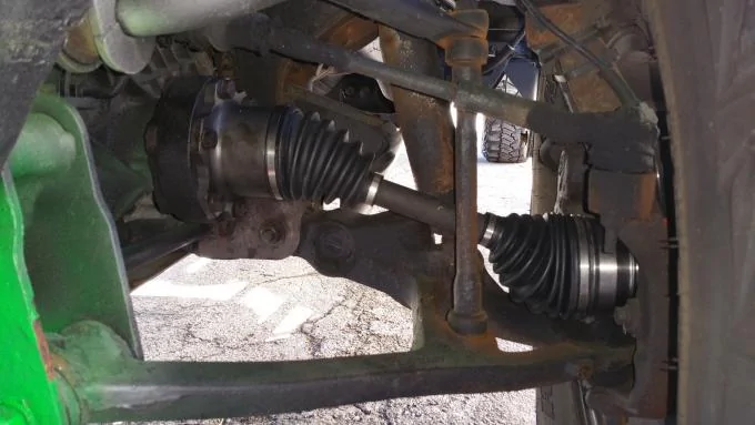

Here is an extreme case on a GMC truck to help visualize the issue for a lift. This is a 6" lift. I can't imagine how quickly that thing goes through axles.
Ford Maverick $800 Front Axle Replacement Axle lift
Now it makes perfect sense. I would imagine the change in geometry will put additional wear on the joints.
