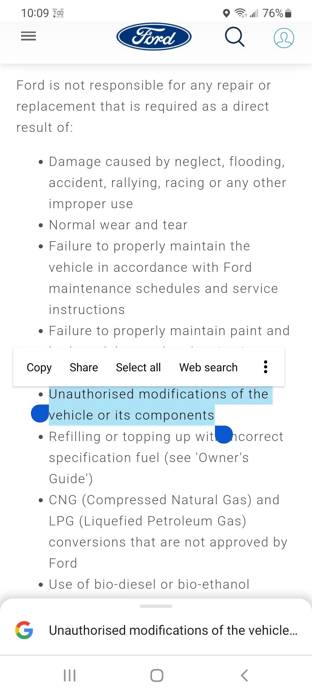

MaineMav
Mar 2, 2022
121
214
Maine
2019 Ford F-150
I know what the act is. as usually pertains to lemons, it also requires that the company list out whether a warranty is limit or full. Ford does list that modifying a vehicle voids you warranty right in the paperwork and on the sites. Also depending on the modification too if you change the headlights void isn't going to void your drivetrain if you put a bigger turbo on the can and probably will try to void your Engine warranty
They still cannot void your warranty due to blanket modifications. Still doesn't work that way.
