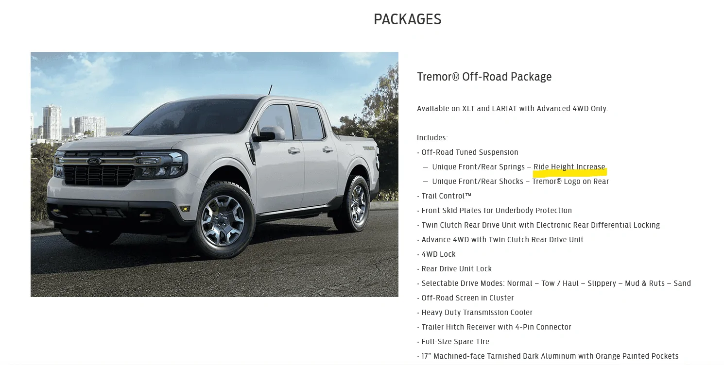

Sorry if this has already been asked but, does the new Tremor have a lift? If so, does it use different or special axles?
