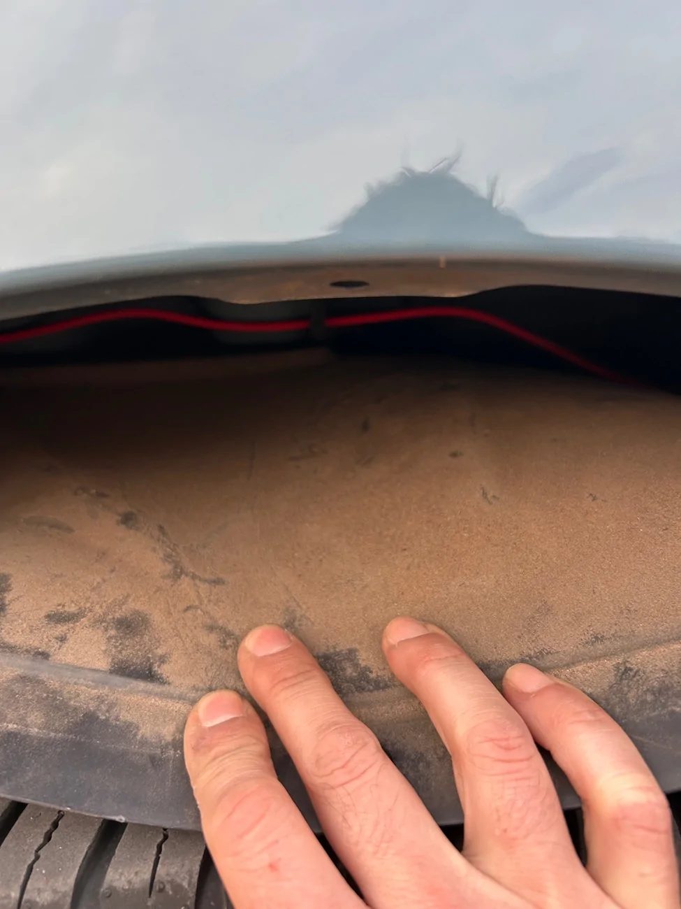

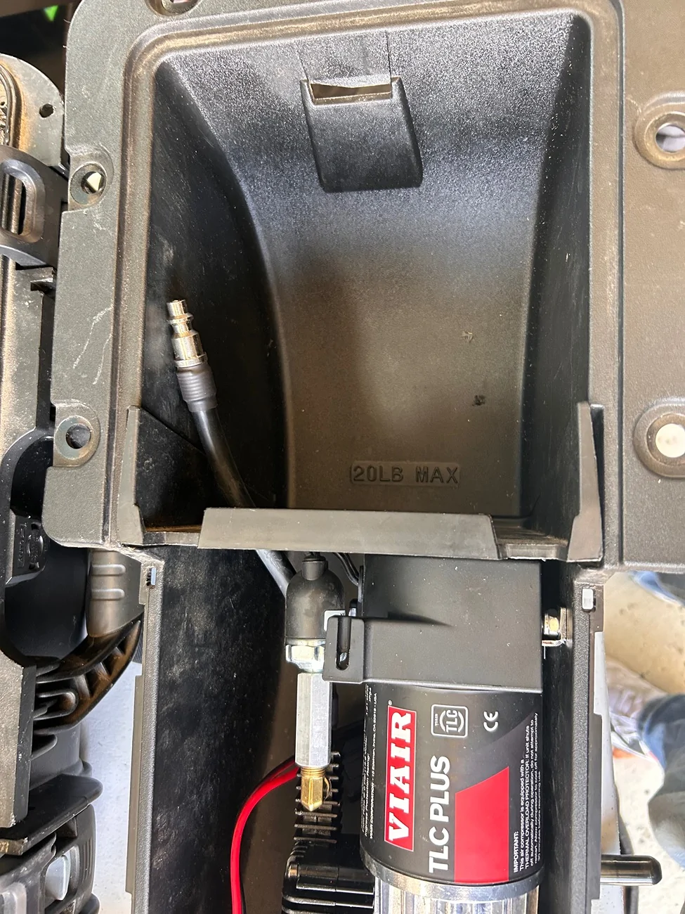

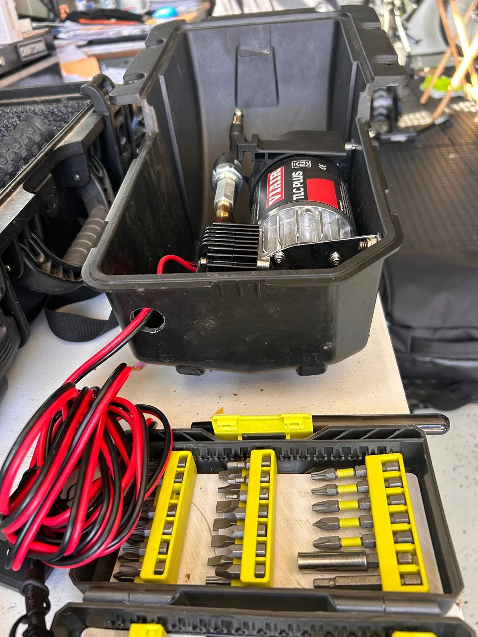

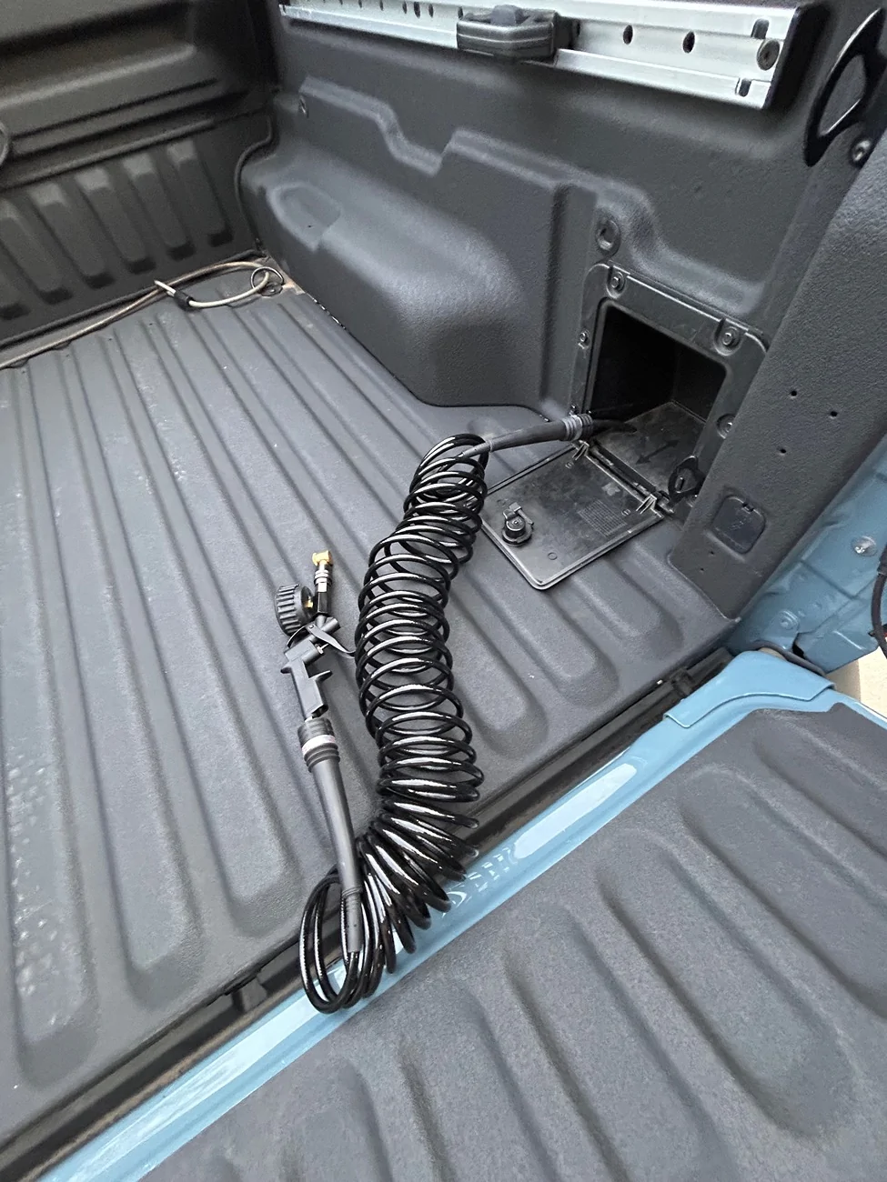

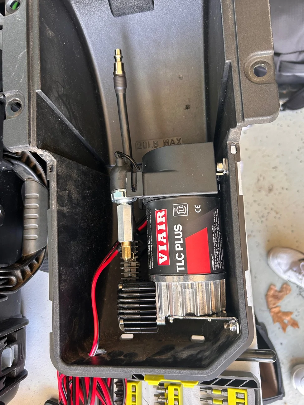

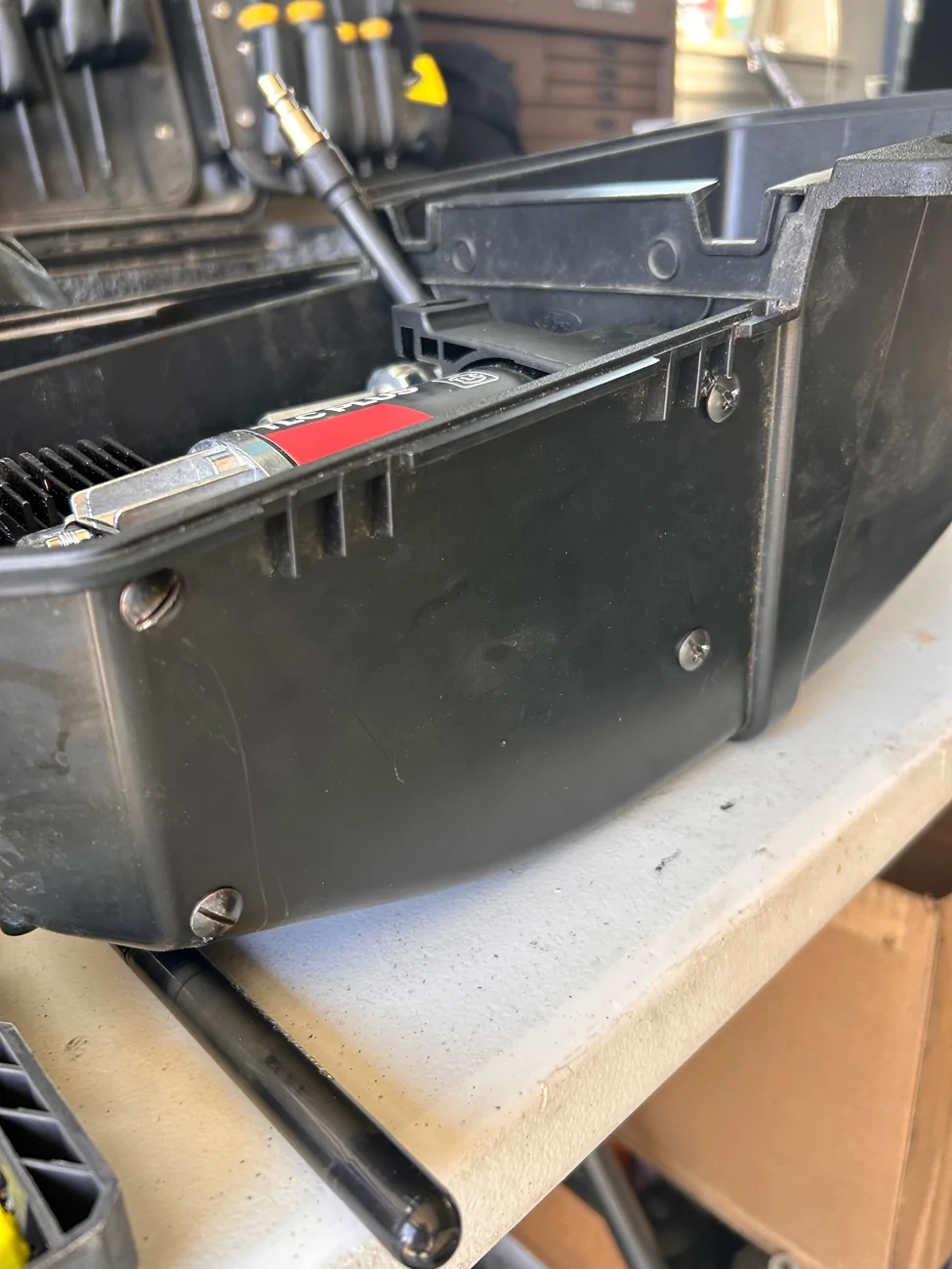

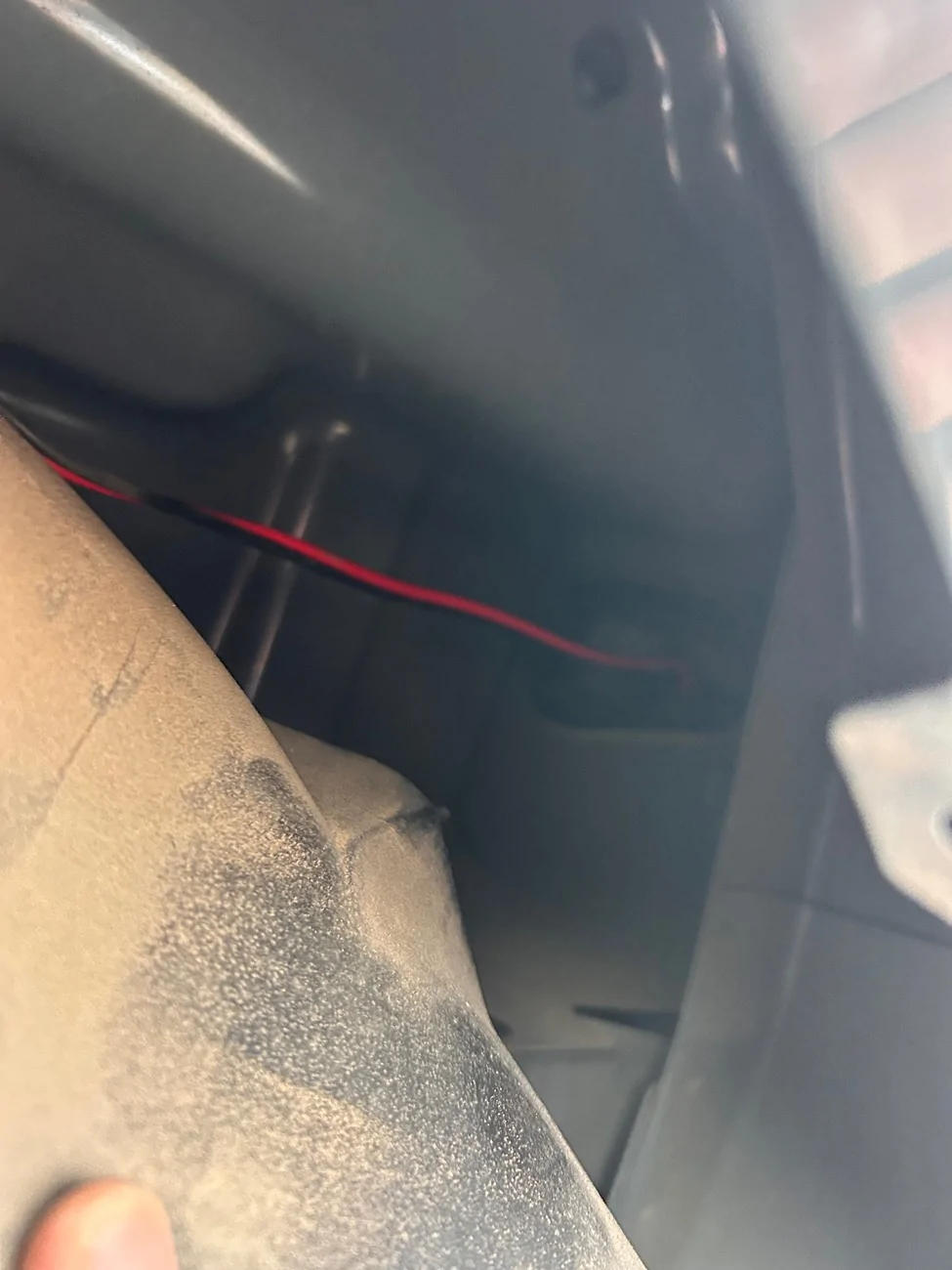

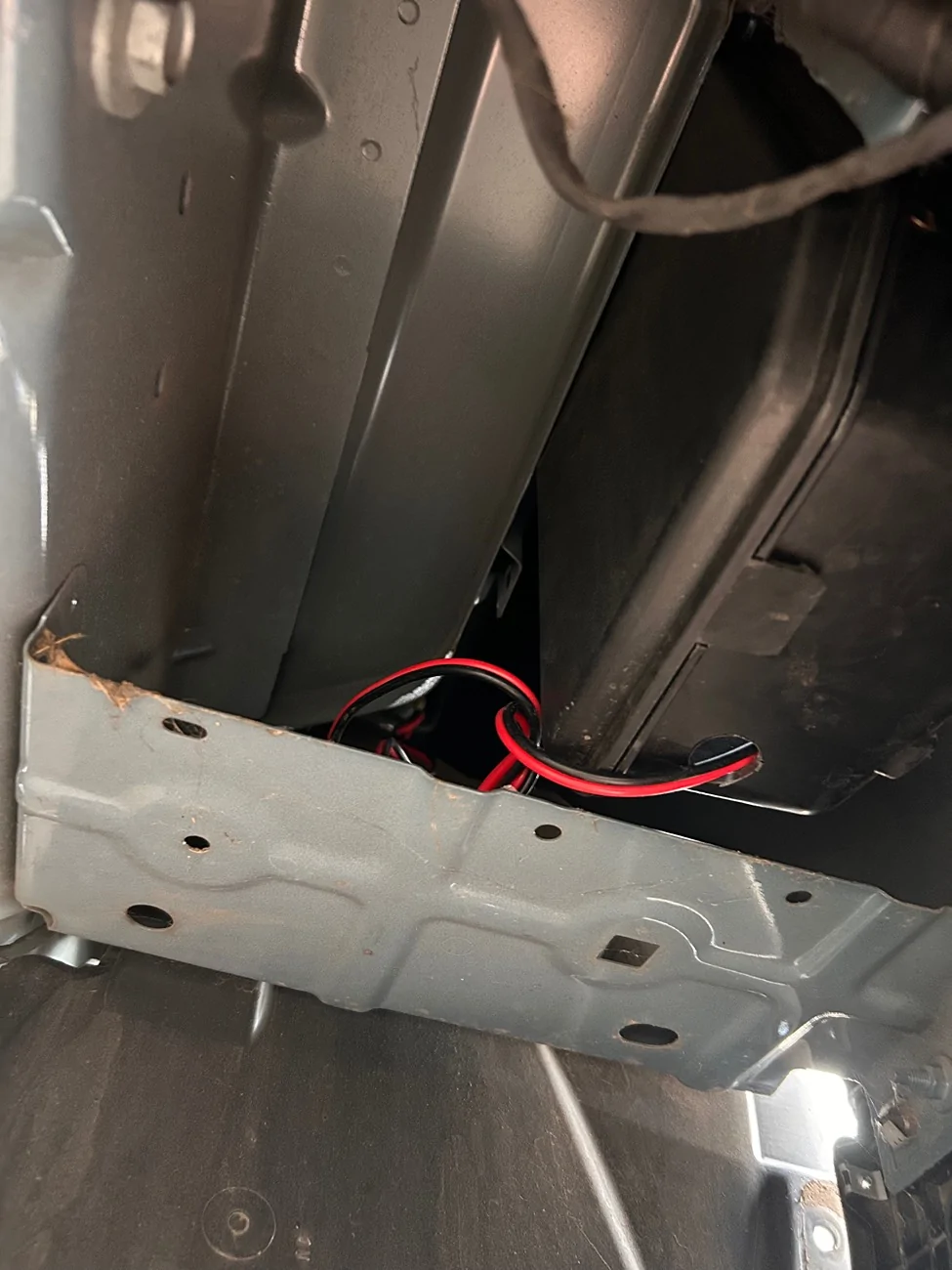

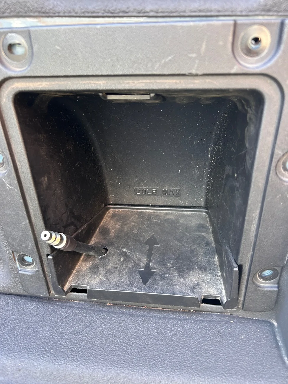

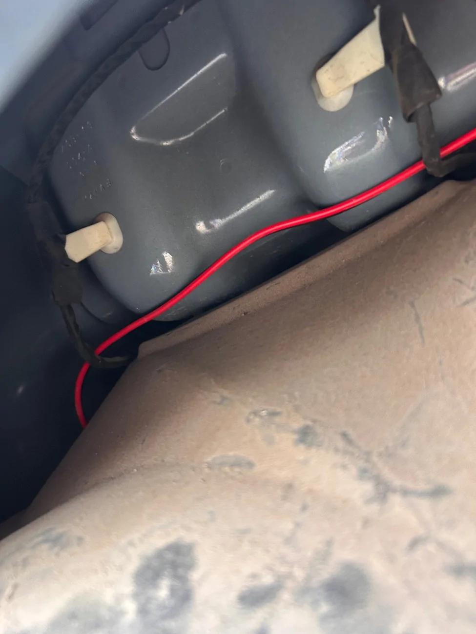

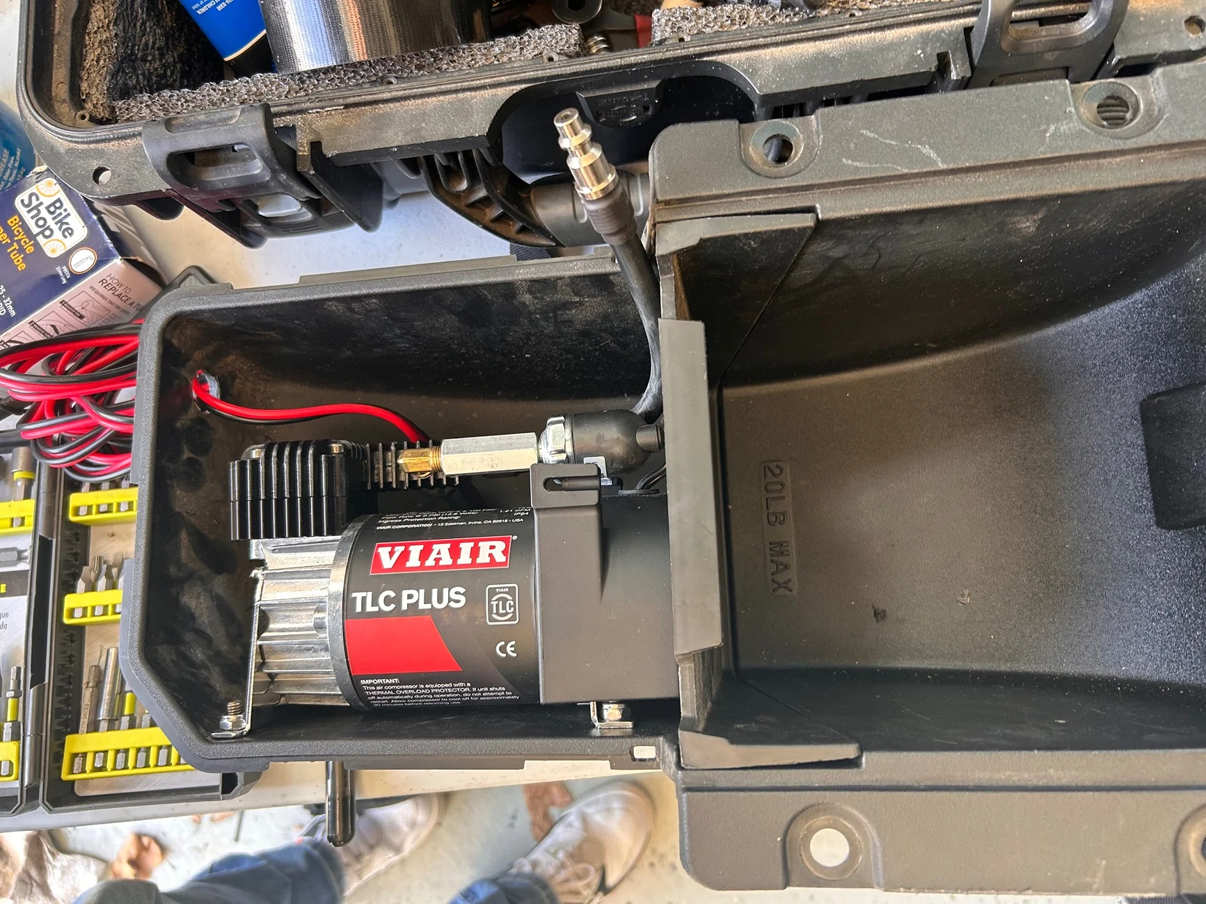

Finally got to this project:
VAIR 12v 23amp 2CFM (enough to seat a tubeless Mtb tire)
Hard mounted into the bed cubby
Wired directly to the 12v battery under the rear seat in the hybrid. I installed a 30amp fuse inline to the compressor. Routed the wiring along the factory harness above the fender well, and thru one of the body vents into the backseat.
Nice and clean fits like a glove!
