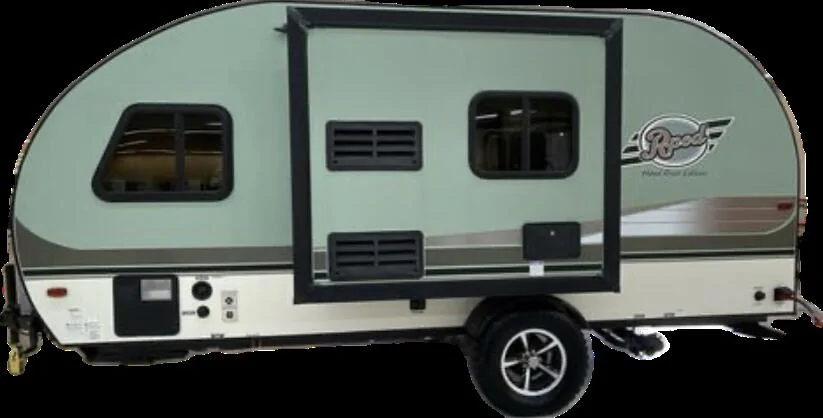

This isn't mine.
But I borrowed it and it tows behind the hybrid pretty well at 65 MPH on level highway.
Pulled it up some really steep residential roads at residential speeds.
Probably in excess of 12% hill for a couple of blocks. I even purposefully came to a dead stop on the big hill to see if I could get rolling again. No problem. Electric torque at low speed coming from a dead stop is probably much better than the 2.0 EB.
To go any faster than 65 MPH you're going to need the EB. But why would you go faster? Gets sketchy in any powertrain.
