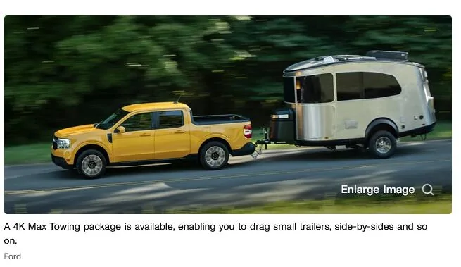

Funny thing about the towing guide, Ford shows the Maverick pulling a Airstream 16' Bambi. Media packets show the Maverick pulling a Basecamp 16'. Both are over on the frontal area AND tongue weight. View attachment 218426

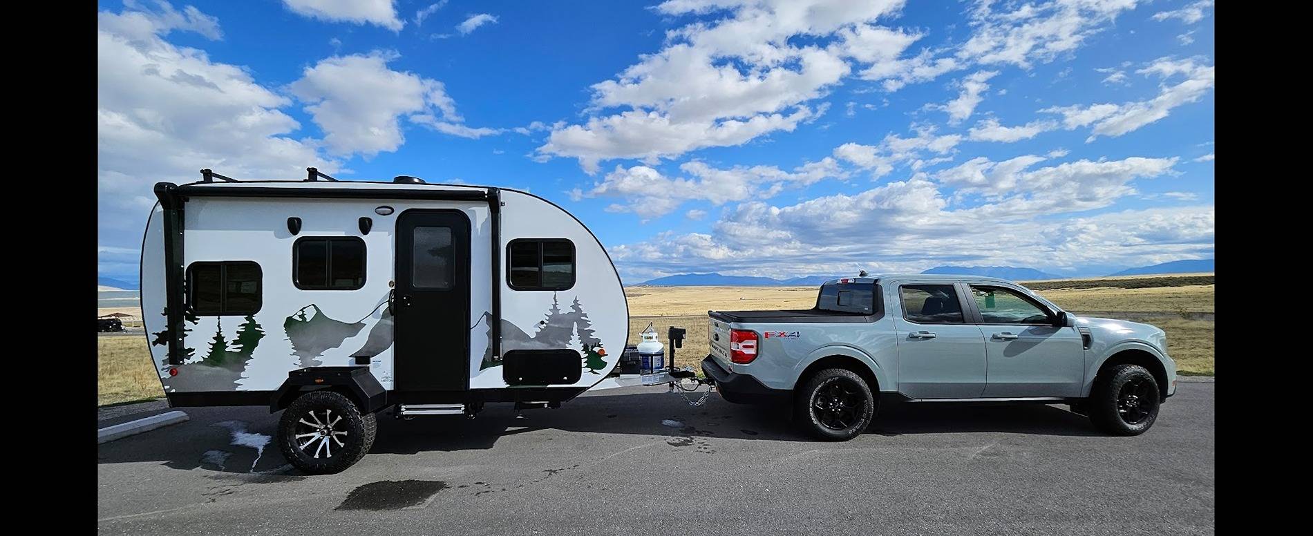

Exactly and from what I understand you take the dimensions of the trailer, not counting the space under the chassis- deduct a bit for the area blocked from the tailgate and come up with a number- Of course its up for speculation since Ford painted that pretty grey - So even if you don't deduct for the tailgate area- The trailer we pull is around 37 SQ FT front load - 6.6 High (Not including airspace under the trailer) 6.5 Wide-
