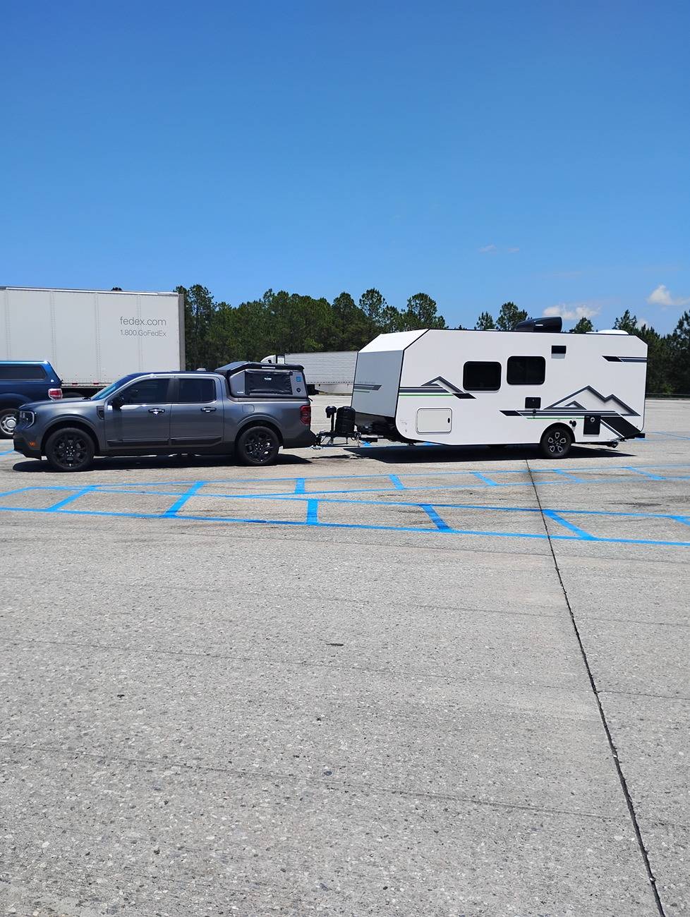

What’s the largest (length and weight) any of you have towed With the 4K towing package with brake controller on a Maverick. I’m thinking of buying a 19ft trailer with a 3300 dry weight. I’ll keep the total at about 3800 and tongue weight under 400. I know I’m pushing the specs.
I have a fair amount of experience towing. During the COVID years I towed a 7500lb 30ft Imagine RV from Memphis to Key West, to the Grand Canyon. Sante Fe, Roswell NM, the National Parks of Utah, across the Great Divide into Colorado, to Dodge City, through out the Smokey Mountains, Charleston, Richmond Va, Destin Fl, through Atlanta traffic and many more places. I did this with a F150. No problems.
Just trying to figure if this is doable. Thanks!
You will be fine anywhere you tow with that. I haul my 16’ trailer with my car and all my gear all over the country even through the mountains. My car is about 3300lbs and all my fuel and gear go north of 5k.

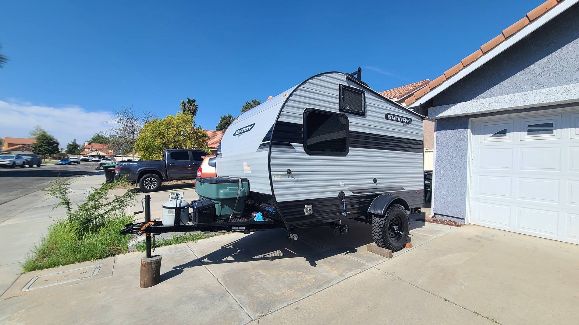

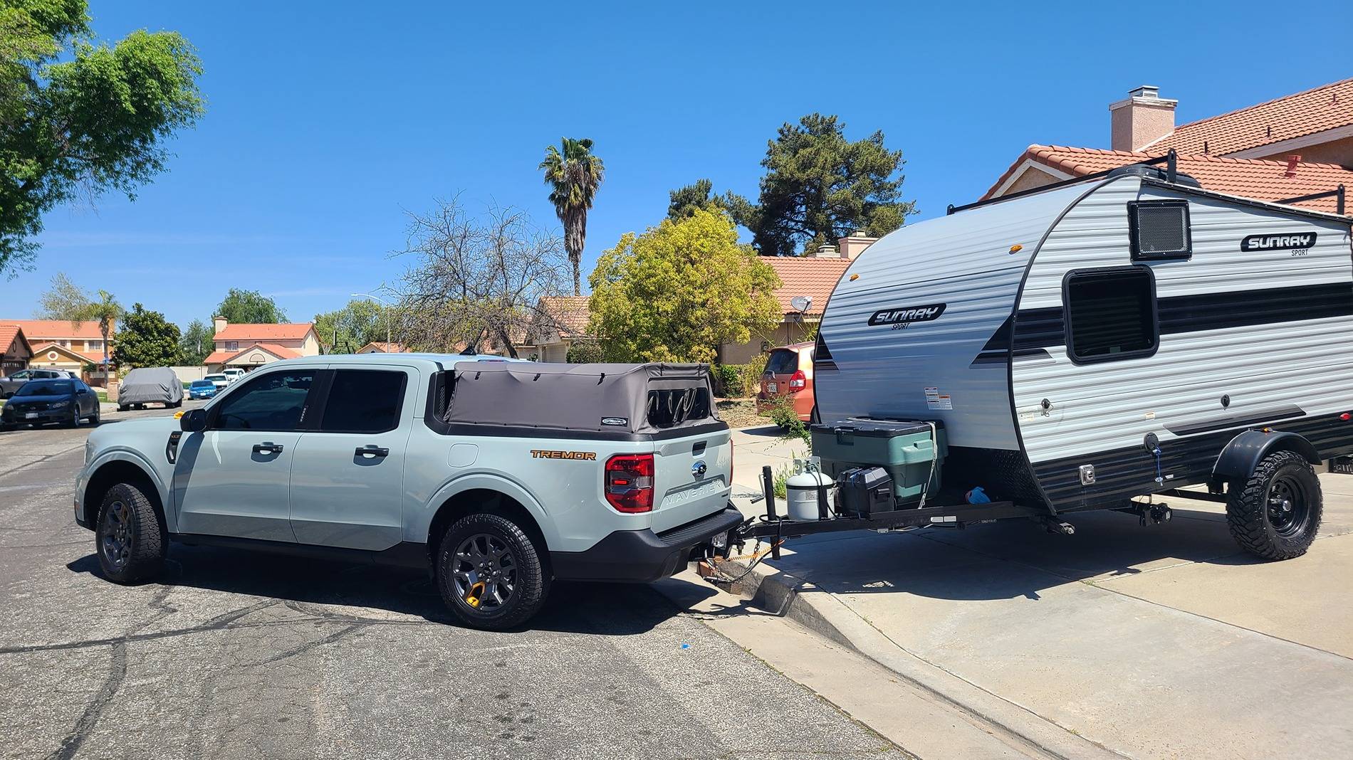

Look into Sunray, they have quite a few rigs that the weight would better suit you all around.
https://sunsettrailers.com/

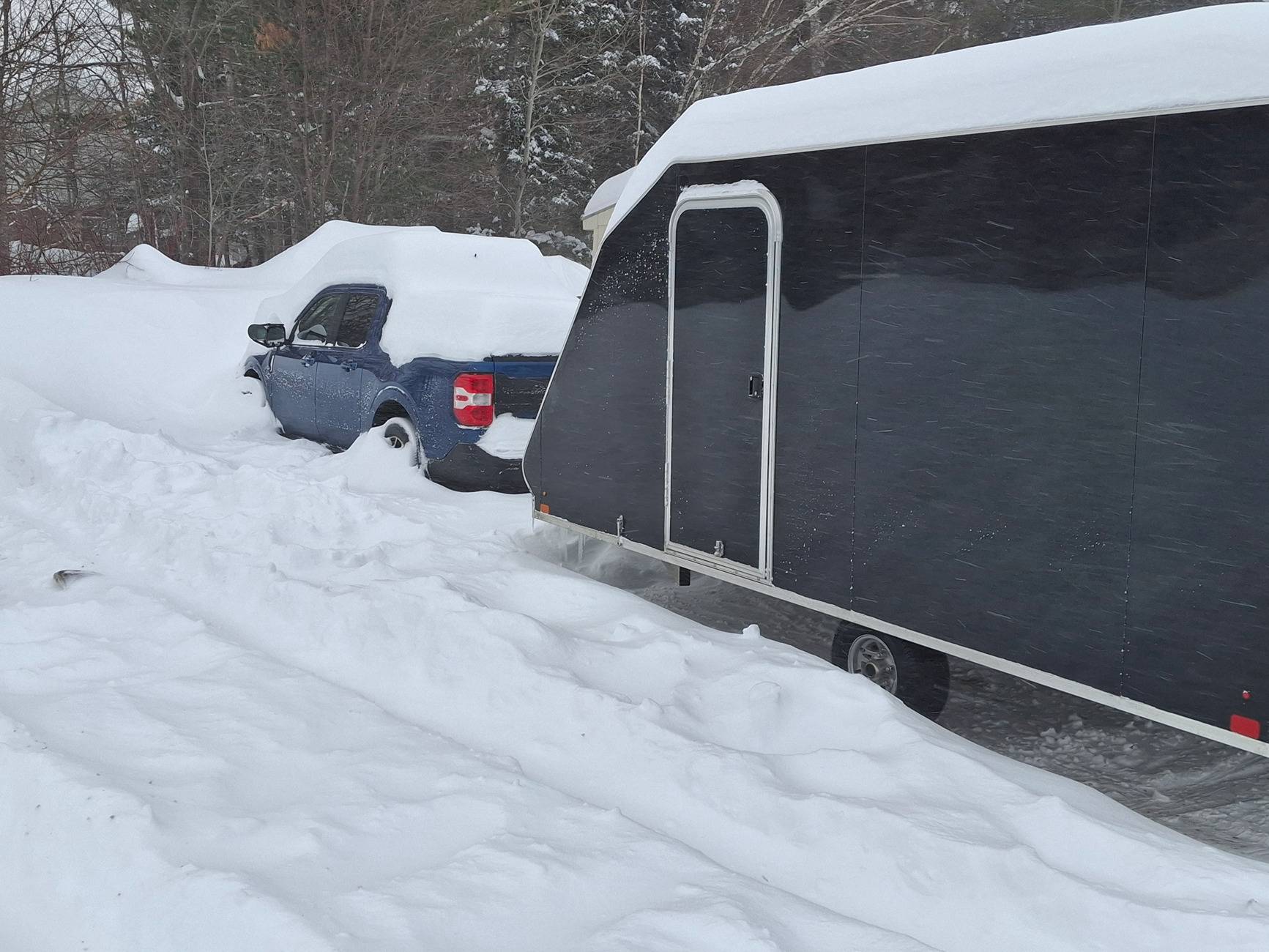

I tow a 13' long, 90" Wide and 90" high trailer with 2 snowmobiles, No mountains but do have some good hills in northern ME. Frontage calc's out to 43 sq ft, however the front of the trailer tips back quite severely. My calc on total weight is 3200 to 3400 lbs depending on how much addl stuff we are carrying with us. Sorry, best picture I could find of the 2 of them together. Truck and trailer were buried in 24+" of new snow when we got back to our hotel. lol
